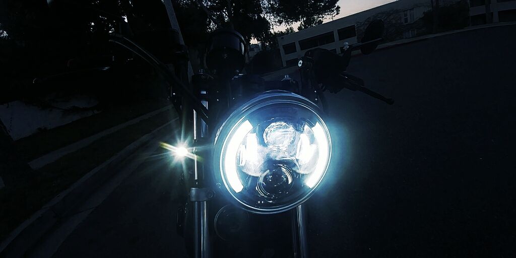

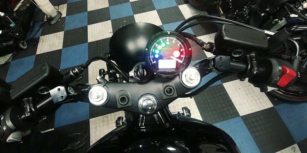

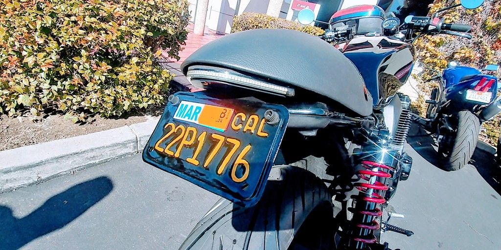

Hey guys so sorry it has taken me so long to get back but wanted you all to know that the 13 ECU WAS plug and PLAY with the 2014 CB1100 harness .
We we're able to complete the build with the KOSO TNT gauge and it came out so amazing .. ONE weird thing is NEUTRAL light tends to be a little intermittent with the KOSO GAUGE..
You have to rev the engine to 5k and the light stays solid (koso) or if you pull the clutch in it reads perfectly . Trying to wrap our brains around it but the owner of the bike wasn't bothered much .
AGAIN THANK U ALL SO MUCH!
JIMMY SUMMERS (here are updated photos)
