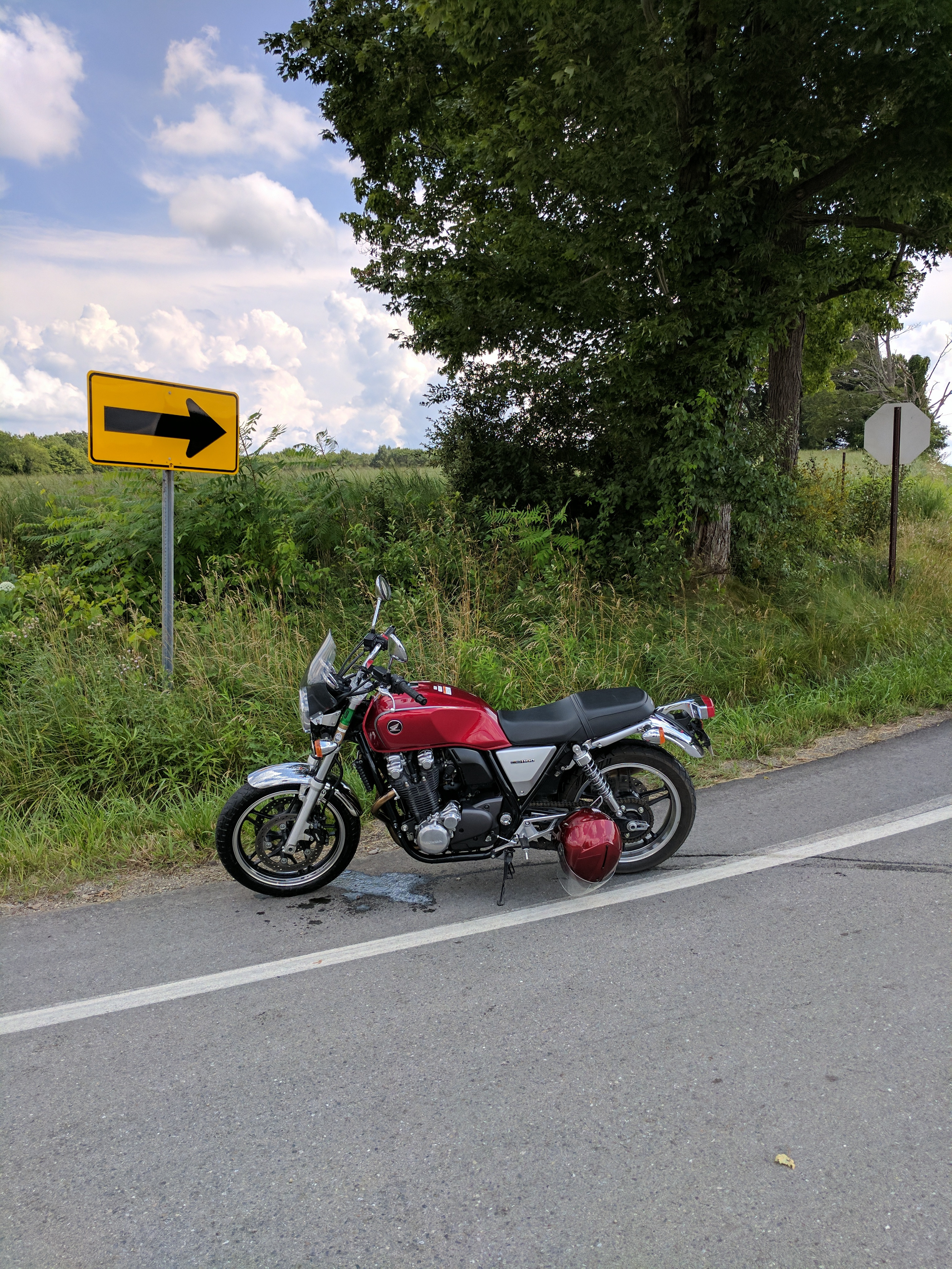

As I was decelerating coming to a stop I noticed a massive plume of smoke. Oil had spilled catastrophically from the oil filter all over my header, brakes, tank, fenders and shocks.
The riveted hex nut on the from of my oil filter failed, and 2.5 liters of oil drained from my bike in a matter of seconds. I shut my bike down as soon as I saw the plume, so I'm not too concerned that I did internal damage, however my bike is currently in my garage with a massive amount of oil all over it. Top to bottom.
The brakes are useless, and the tires are quite covered.
The part in question is a K&N 204 filter.
I managed a roadside repair, as documented below, but now I have this huge clean up to do.
Any advice? What should I replace? Should I ask for compensation beyond a new filter? I'm pretty saddened by the whole thing. My bike has less than 2000 miles on it.

All fixed:
[Image: cb5bed808a57e8d431a2dba7c82eaa94.jpg]
The filter:
Unfortunately this is an experience documented by several members of the forum including myself. I got lucky and experienced my meltdown feet from my house. It's really horrible they continue to sell those filters.

When I went to pick up parts yesterday to get it working again, all they had were K&N filters.... So there is another one on there now. I'm pretty worried about it. Between the $50 in Lucas oil, travel, probably brake pads, etc, this wasn't entirely cheap. And now I'm worried it will happen again before the next oil change interval.
I guess I could clean out my old oil reservoir and reuse the oil I just put in while replacing the filter.

I have seem motors run on no oil with no damage. If you did not run the engine very long you have nothing to worry about in terms of engine internals. There are documented cases on engines running with no oil to the determine failure point and they run an amazingly long time. Also don't use any filter other than OEM Honda. https://www.youtube.com/watch?v=eASCK9BDMEU
Once oil gets on the pads you should replace them. Some don't feel that way and "cleaned" them and said they are good. Pads are cheap. Orthopedic surgeons are not.
