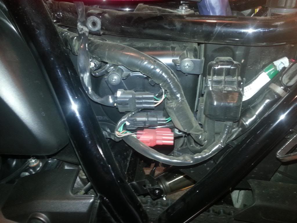

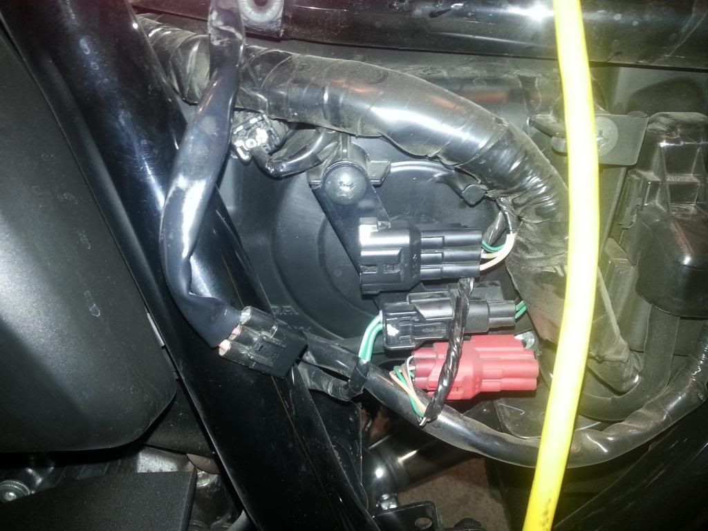

But seriously, it's not too hard. You just have to carefully release the clip that attaches the fuel line to the pump. Also make sure to disconnect power to the fuel pump and run the bike till it stalls to make sure the pressure is out of the system first. This is where it's located: ![]() And this is with it disconnected: ![]() http://cb1100forum.com/forum/showthread....nk+removal

Randy. If the ignition key is turned off, then why do you need to disconnect the power to the fuel pump?
11-17-2015, 01:02 PM
You need the cable disconnected as there is no slack to lift the tank.
Not worded very well, but you get it...
11-17-2015, 01:17 PM
(11-17-2015, 12:59 PM)Dave_imp Wrote: Randy. If the ignition key is turned off, then why do you need to disconnect the power to the fuel pump? In order to depressurize the fuel system the fuel pump shouldn't be running. By disconnecting its power supply, then running the bike til it dies, the pump won't have pressurized the lines and you won't get a surprise when you disconnect the fuel line.
11-17-2015, 10:16 PM
Well, yeah, there is that too...
11-17-2015, 10:37 PM
(11-17-2015, 12:59 PM)Dave_imp Wrote: Randy. If the ignition key is turned off, then why do you need to disconnect the power to the fuel pump? Because you can run the bike if the key is off. The point is to depressurize the system so that fuel doesn't spray all over when you disconnect the fuel line from the tank.
11-18-2015, 11:15 AM
Don't worry about depressurizing the system. The fuel line has a leak free connection at the break point. When you pull the line apart you'll get a couple drops of fuel but nothing serious. If you bleed the pressure off it's just going to be a pain when you try to restart it.
Just did this to install my HID and power commander not long ago....
11-18-2015, 12:59 PM
I followed the service manual when I swapped out my tank, so there has to be something to it.
