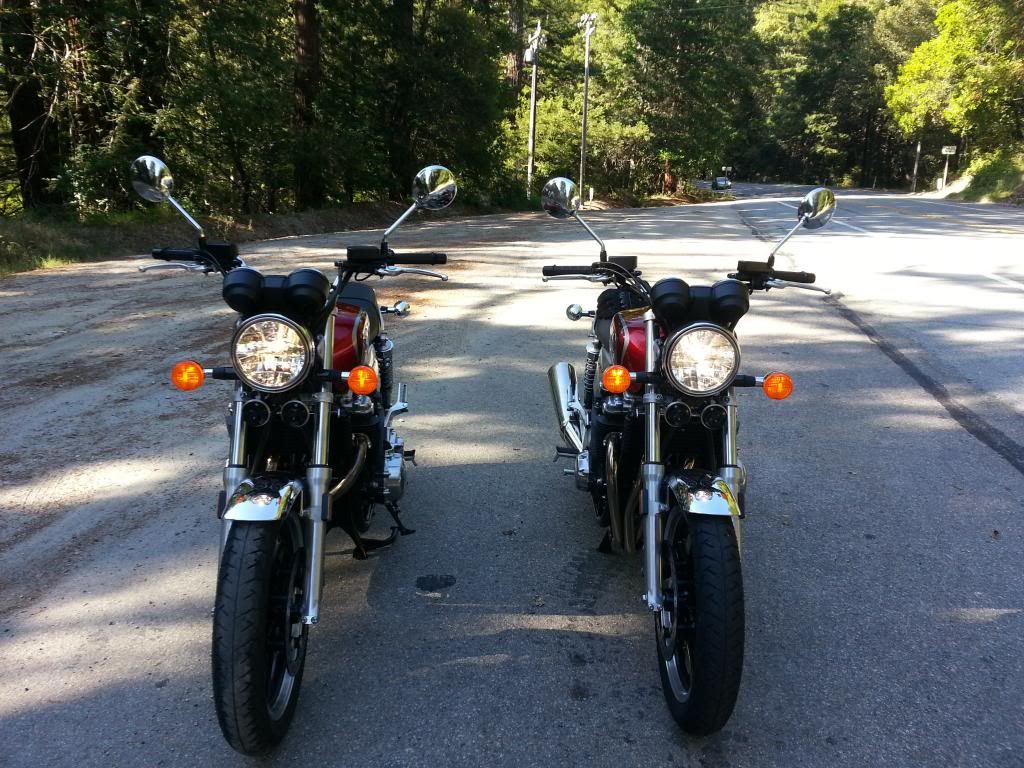

This is a pic of mine and PowderToastMan's bike next to each other. I think because it's still daylight you can't really see it all that well, but mine is on the right, and believe me it's brighter.
[Image: 9d355fe59b1602ad0a014ec5608923d7.jpg]
I have the spare in the garage if/when this one dies. Also I just can't advocate those HID swap kits. The HID bulbs generate light differently and the light source just is not in the correct location within the housing and thus the light gets scattered all over the place and the result is you blind everyone coming at you and don't increase your vision at all. It seems like you do because you end up lighting up the ground right in front of you, but that's about it.
Yup I can vouch for Randy that it's way brighter. The light really fills up the bucket, my stock headlight looks really dinky in comparison.
