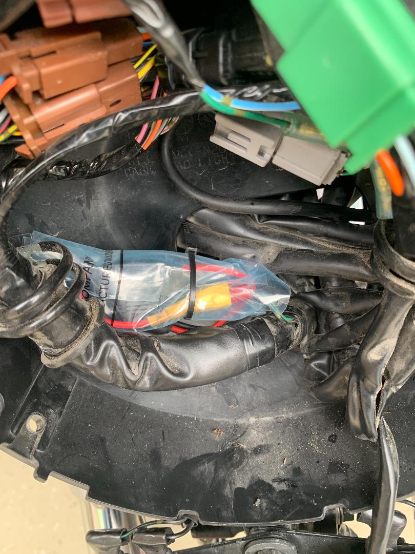

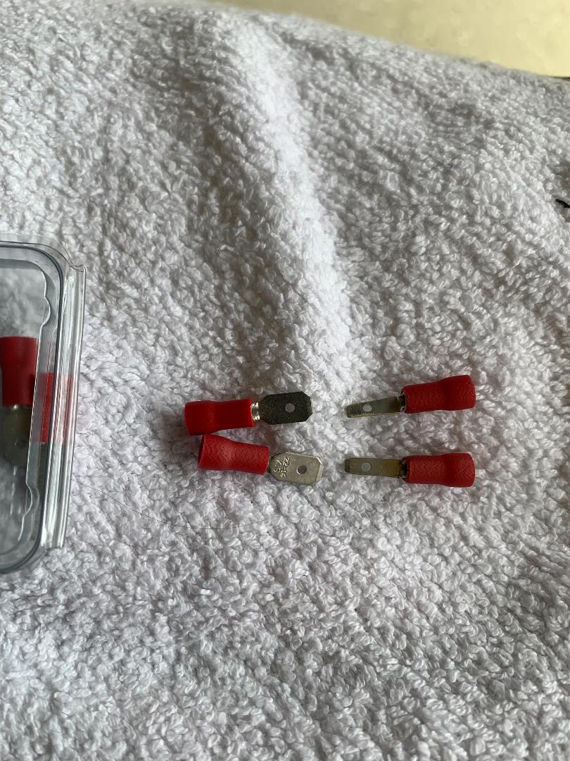

My all three different wires for phone, GPS and camera are from the headlight housing, not battery terminals.
[Image: 537b112da082837da779e1d26088a39f.jpg]
[Image: 9b543f4c43beb8ee4befb021de50d2d1.jpg]

Headlight bucket for me too.

(10-04-2023, 11:33 AM)Cormanus_imp Wrote: Headlight bucket for me too.
Thanks, didn’t immediately occur to me, but makes a lot of sense.
