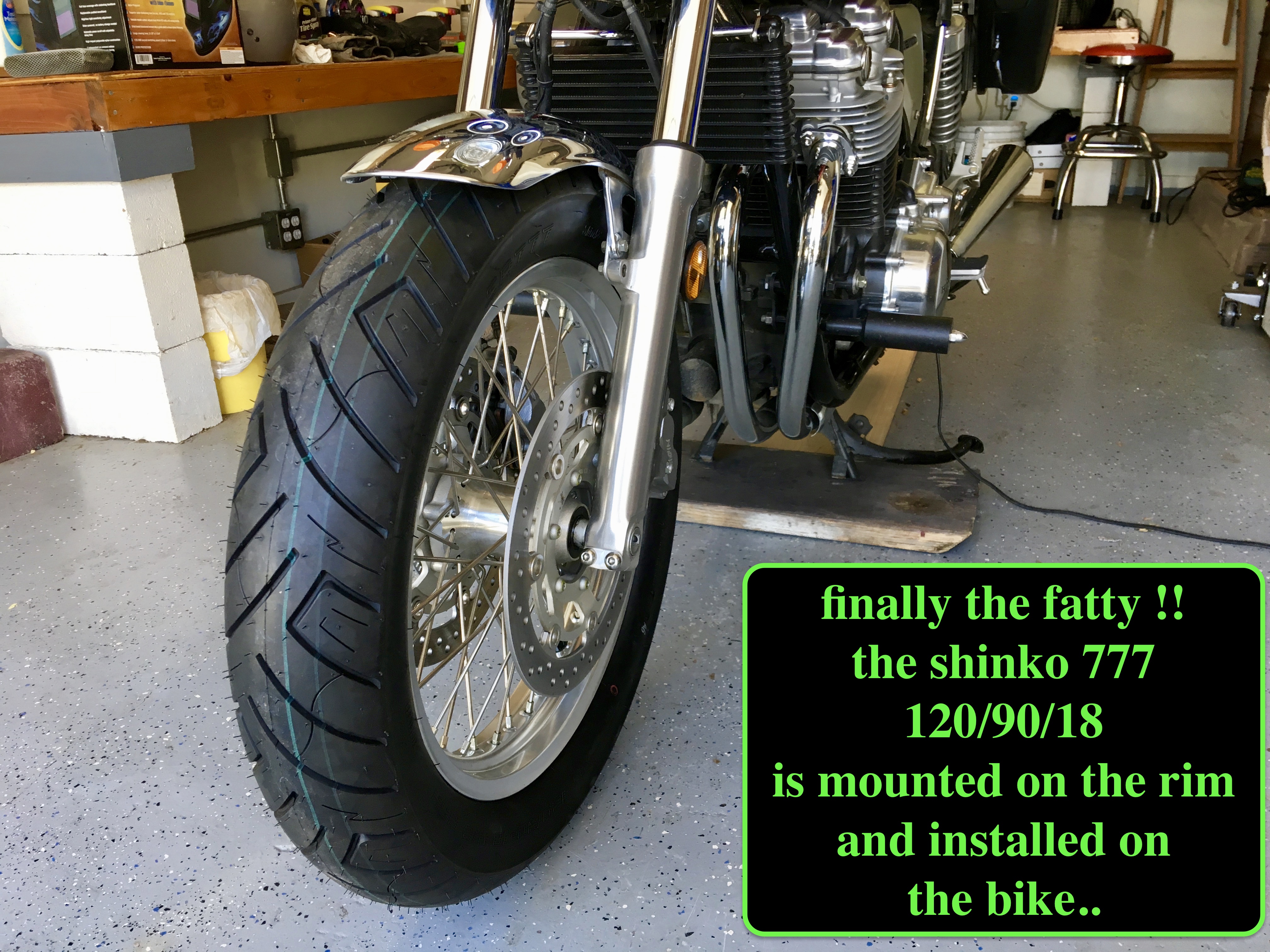

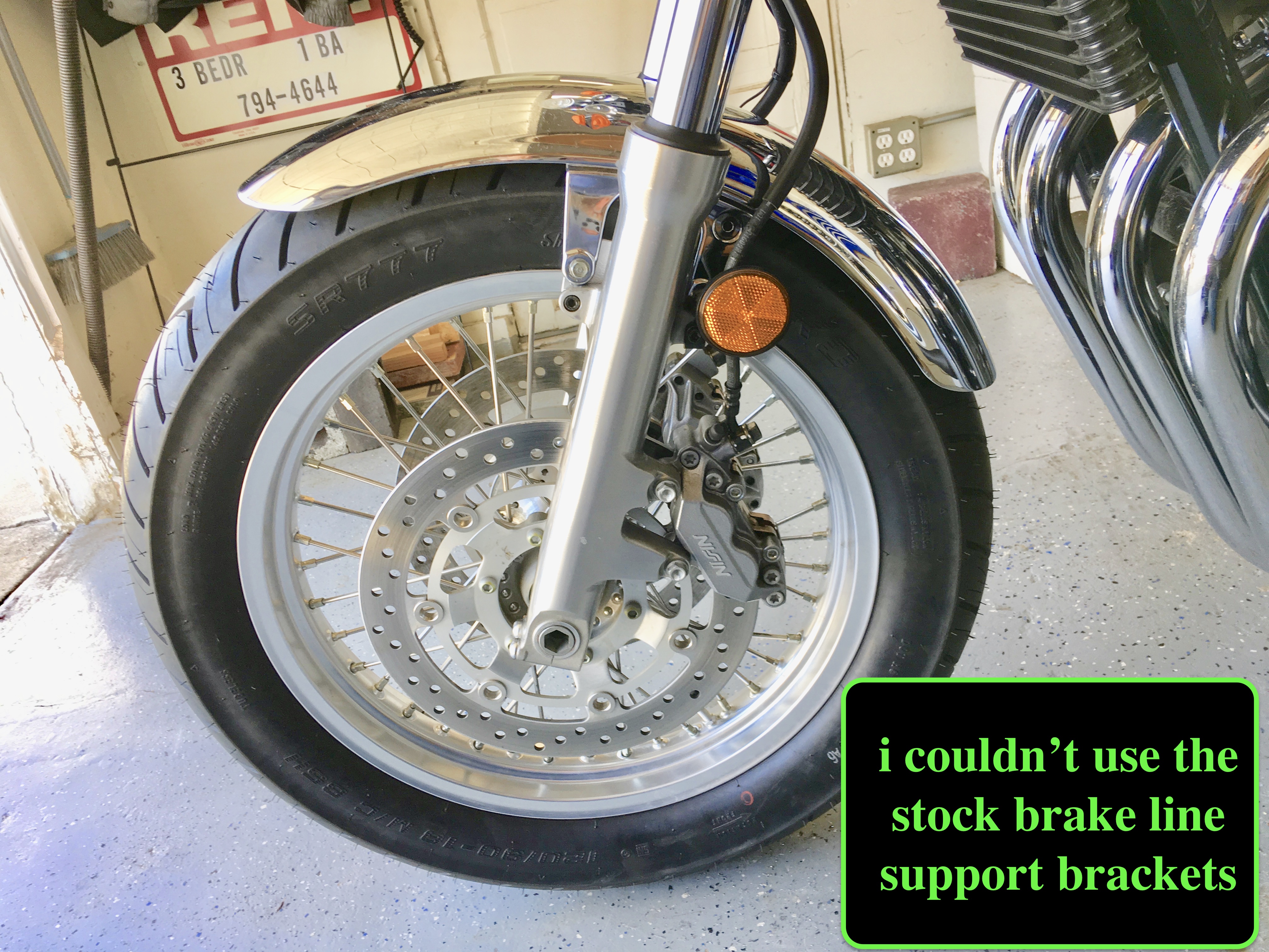

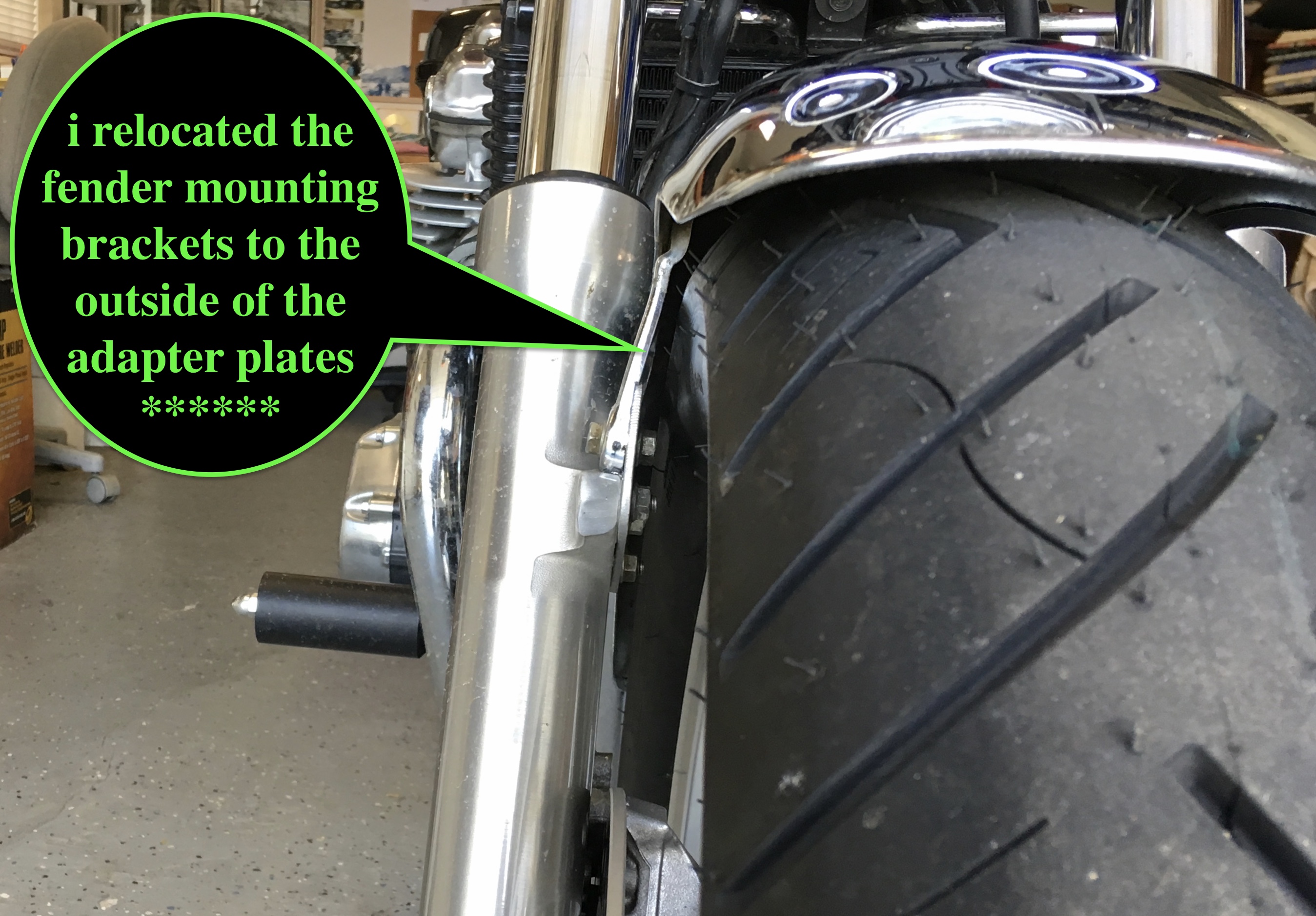

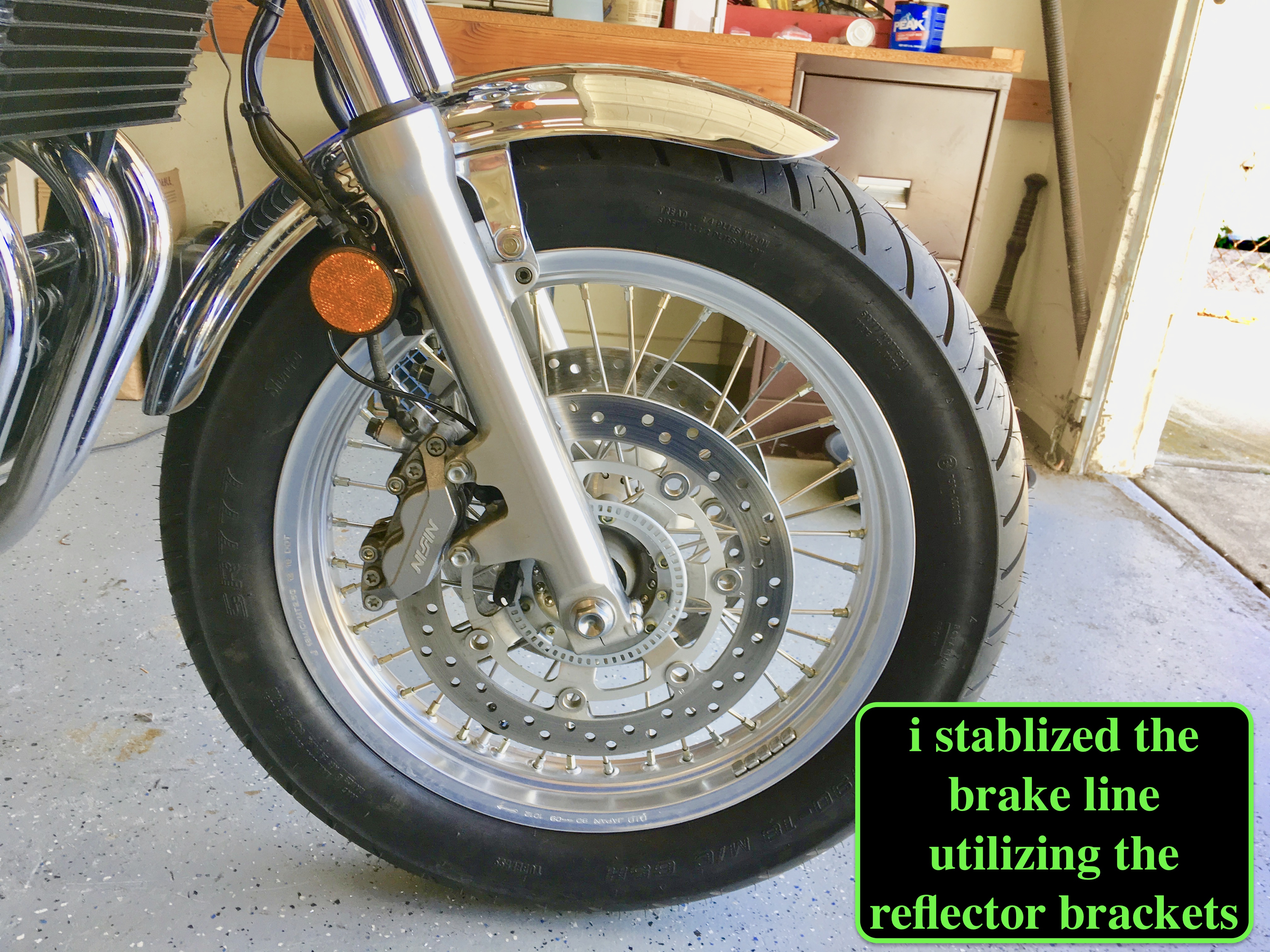

the "fatty" is finally installed on the bike !! there was more modifying that had to be done.. I knew it was going to be a tight fit and had to wait for the mounted tire on the rim to make my final adjustments.. hopefully Peter can help me once more with the captioned pics.. chuckk j.
