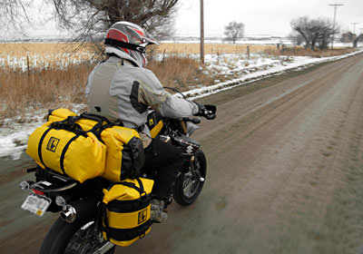

My main reason for wanting a rack is to strap a duffle bag with camping gear to it. I'd position the bag lengthwise, parallel with the seat and rack.
As another option, I wondered if I could skip the rack by adding some semi-soft saddlebags. That way, I might be able to strap a duffle across the width of the seat and saddlebags. Something similar to this (without the second smaller bag).
[Image: c9f90adbfad678e075100a0284b94c78.jpg]
Has anyone tried that approach?

(04-14-2018, 02:35 AM)deltamark_imp Wrote: My main reason for wanting a rack is to strap a duffle bag with camping gear to it. I'd position the bag lengthwise, parallel with the seat and rack.
That smaller bag looks like it may carry a good sleeping bag.
The bigger one a tent and mat.
Side bags clothing and food.
Now I remember why I don't own camping equipment anymore.

I toured on at least 2 long trips without the rear rack. I only bought the rack because my friend and forum member Ole was selling his and he gave me a great deal which included him installing it at his house and sending me home with the rack and a back full of morel mushrooms. I never ride with a passenger so strapping my bags across the rear seat worked fine.

That certainly does sound like a great deal, especially the morels! I hope to get a chance to take my CB / sidecar combo on a trip to do some morel hunting soon. Probably will try it without the rack.
