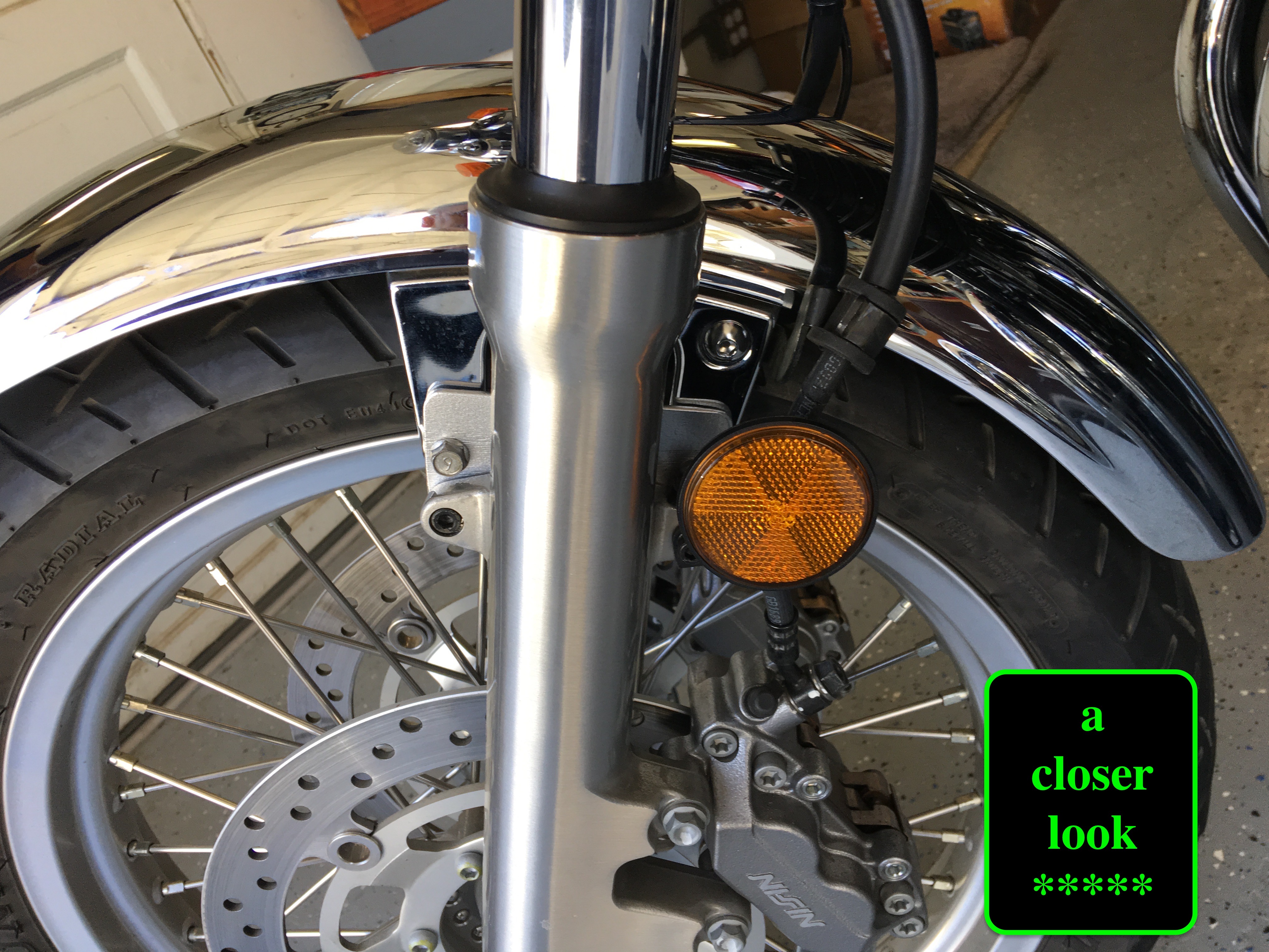

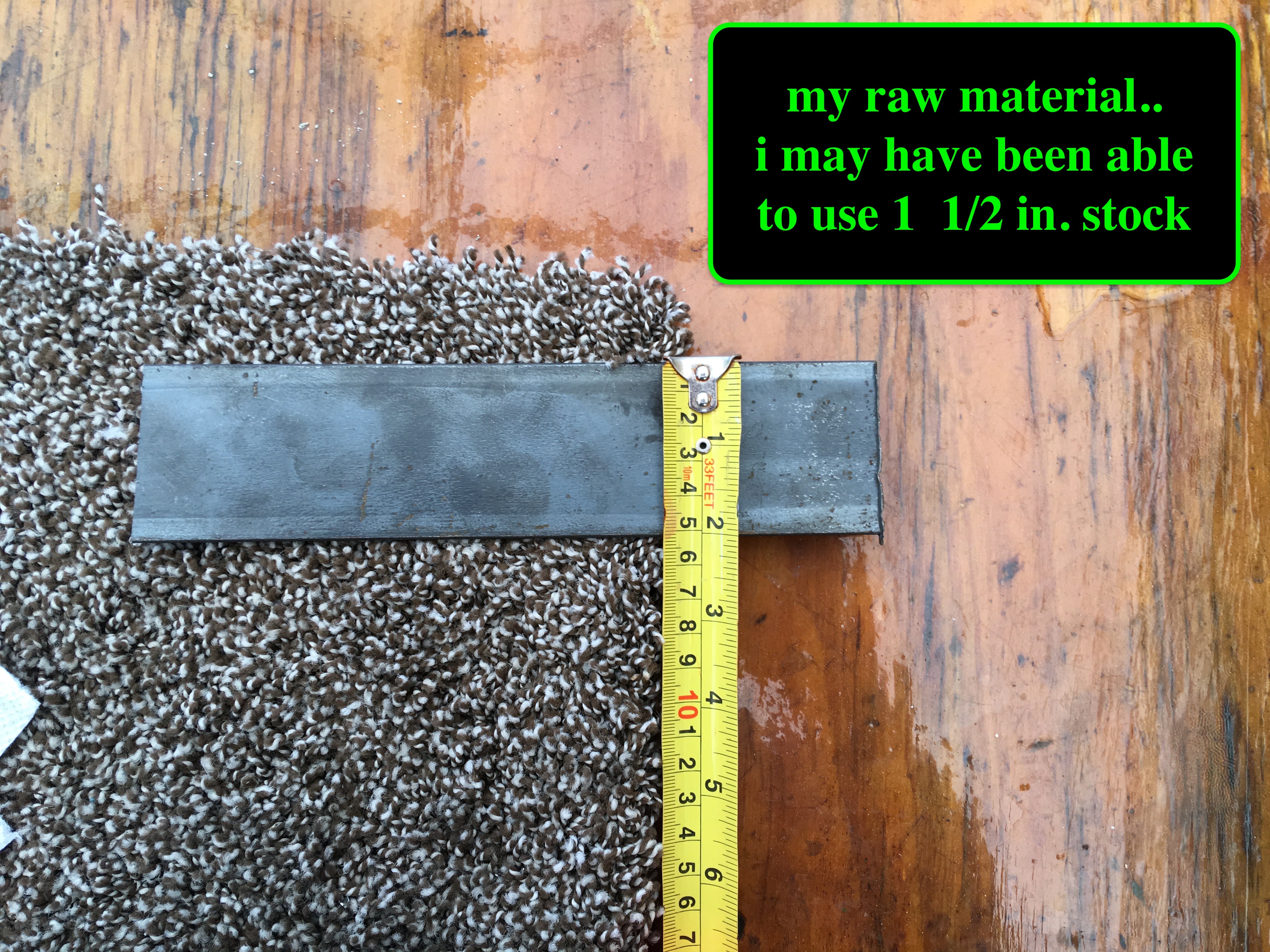

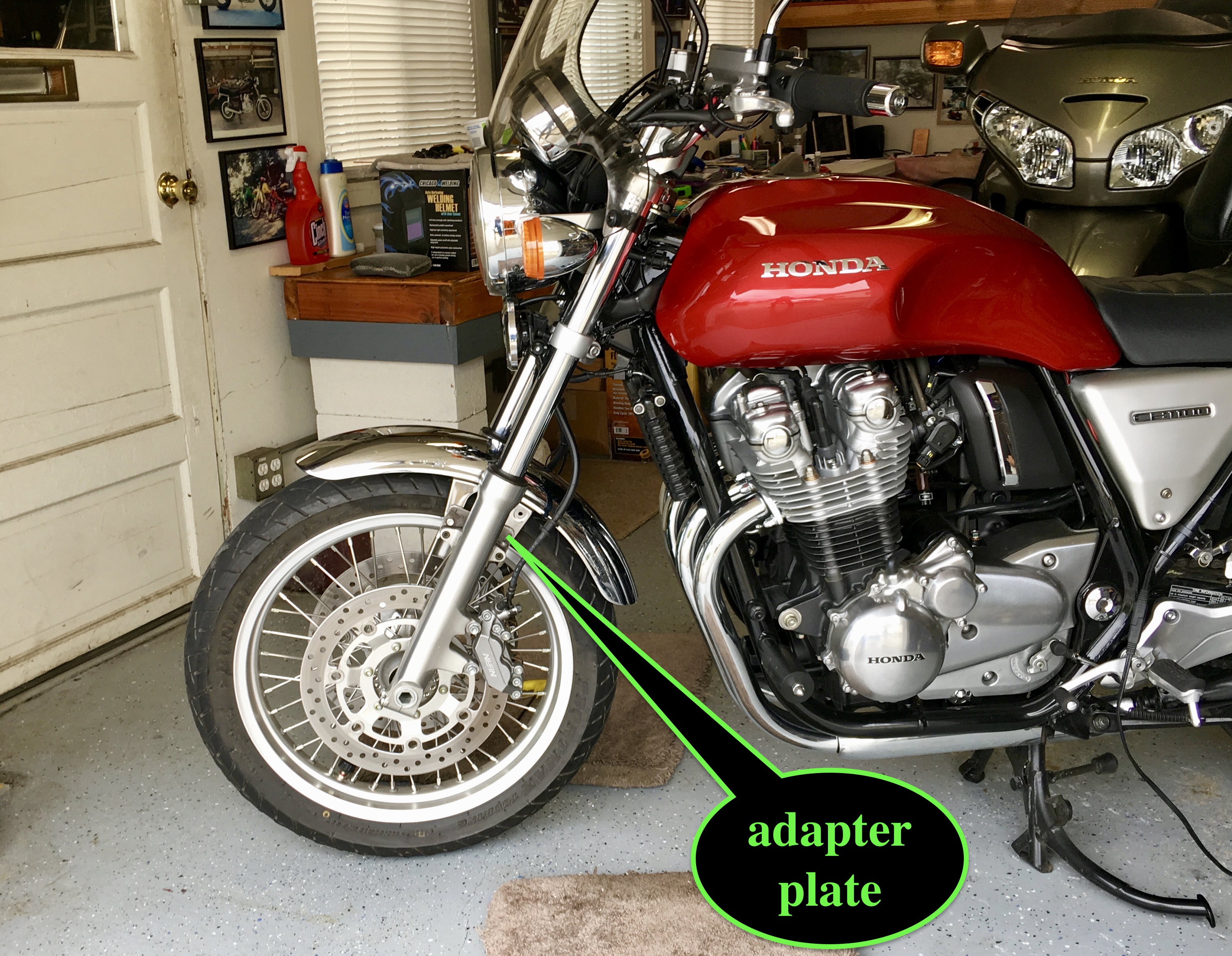

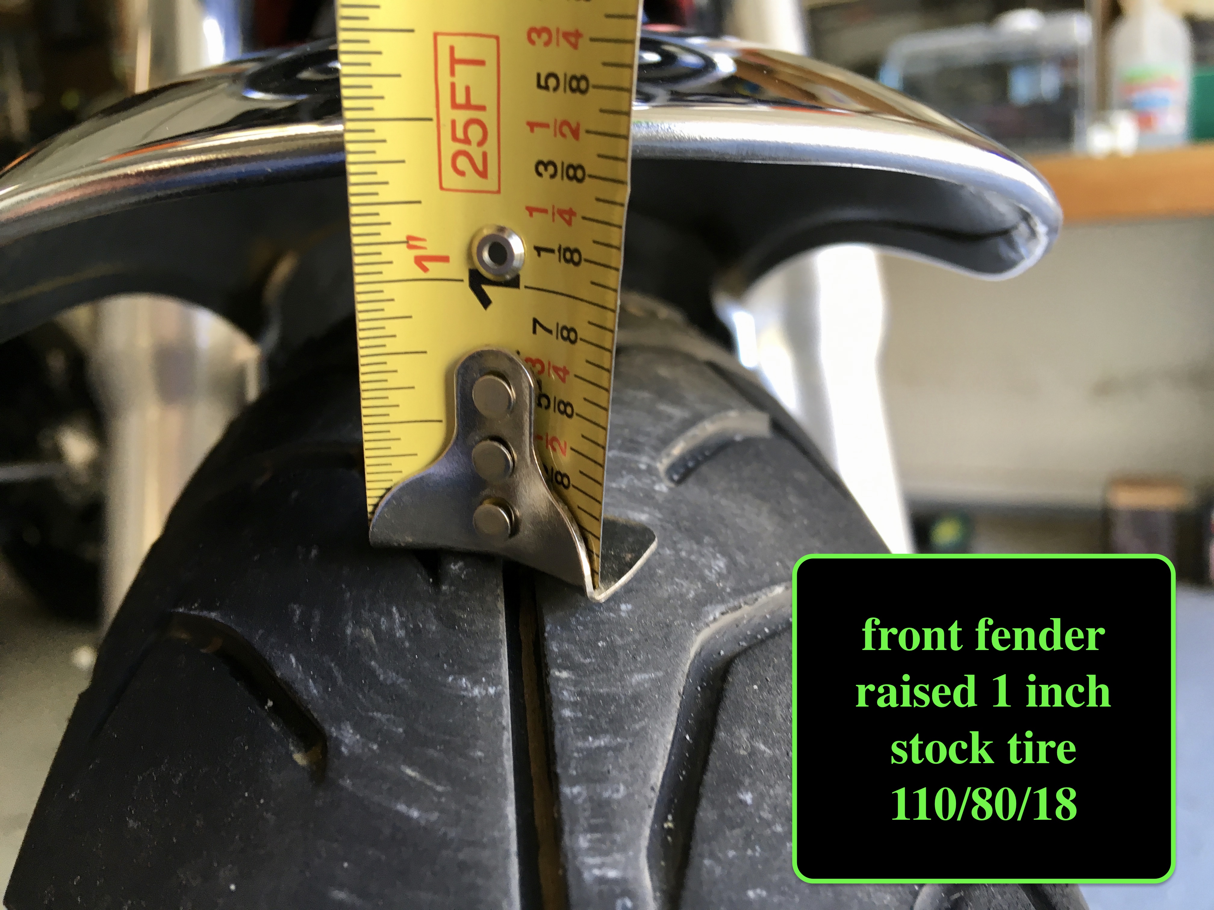

thanks houtman ... pics of my front fender modification will be coming soon.. building 2 small adaptor plates allowed me to raise the front fender on my 2017 1100ex by 1 inch.. this will allow clearance for the Shinko 777 120/90/18 .... the next step will be to convert my spoked rims, allowing me to run tubeless tires without using inner tubes.. chuckk j.

Chuckk's project, not mine, just edit pics for him...
Hey Chuck, no RLETs = Thumbs Up

Interesting project result. So by slightly squeezing the fender near the middle (both sides), you were able to clear the forks, eh? Neat.
