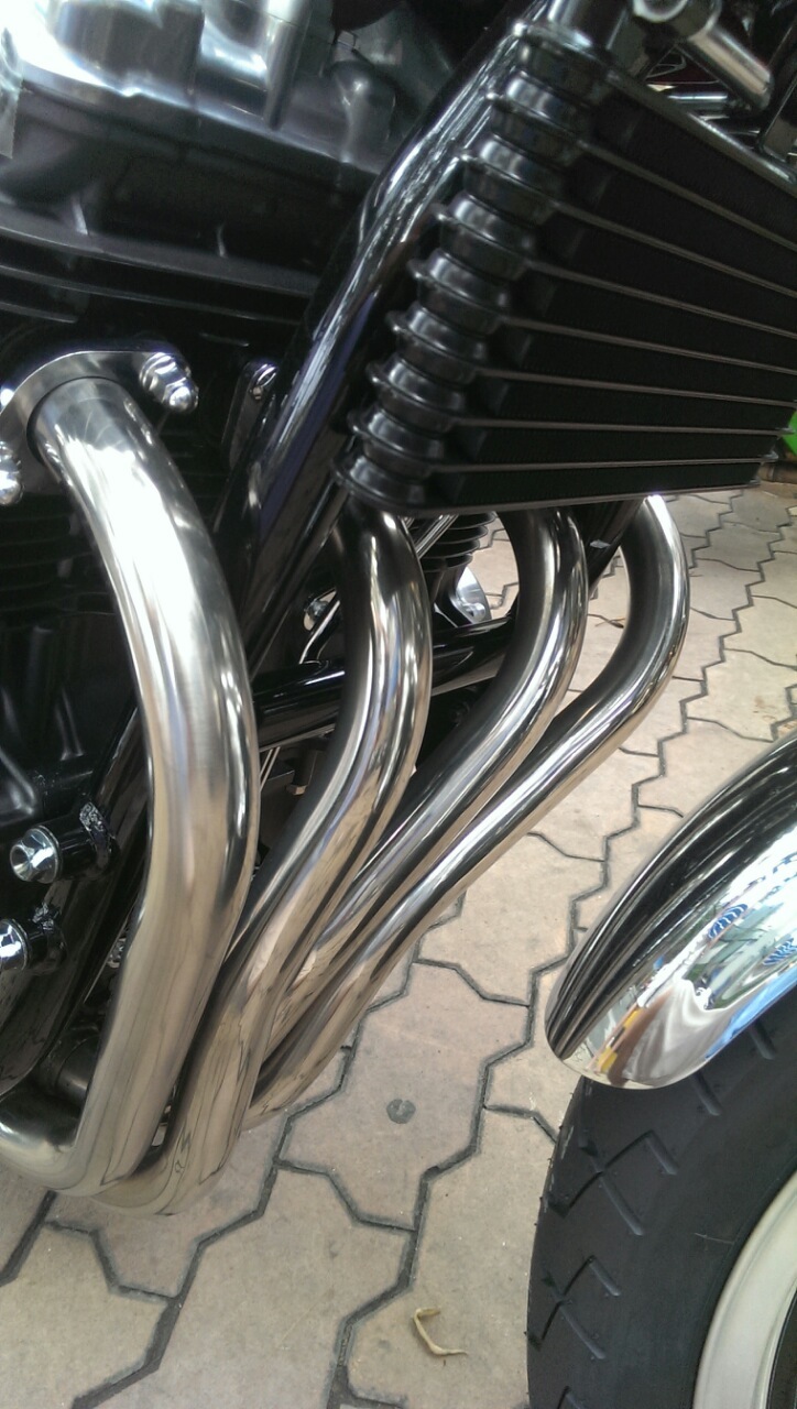

your bike looks new with 1KM on speedometer, however, the exhausts (ong khoi) looks yellow as if it is ridden before, how come? My bike doesn't develop yellowish patinas on the front 4 exhausts until a 1500 KM later after some high speed riding.

(11-25-2013, 08:18 AM)cbfan_imp Wrote: The exhaust pipes look "yellow" because that is what happens when you run it for any length on a stand without air flow across the engine. I believe the manuals says not to idle long. As small as the residue/leaks look they will not show up by running it on a stand.
I also have this question for motorcycle dealers offer, they explain:
- My bike has been through long periods on display in the exhibition. Sometimes, customers ask to hear the engine sound coming from the engine! Of course, they sell this bike for me at a cheaper price.
- These motorcycles are imported into Vietnam must undergo emission testing stage (registration, inspection)! Conditions of the test, it must operate in such conditions are on the road. Of course not spin 2 wheels!
PS: My friend's motorcycle, was like my motorcycle! Although his new motorcycle than my motorcycles very much! The only difference, his motorcycle is not like my motorcycle in the first condition (CYLINDER HEAD).
And I found this very strange, no one explained!! There can not be a coincidence like that!!!
I hope this problem will be lost in time and later stages cleaned with detergent!!

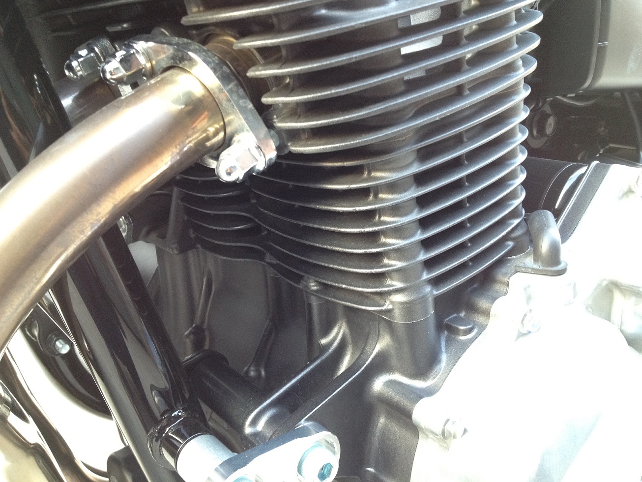

First, I would like to thank all your comments! I have to follow the instructions of some people here!
Because of the language barrier, so I would like to report a summary of the image:
Oil leak in CYLINDER HEAD COVER: It is the fault of the manufacturer. I had to remove the CYLINDER HEAD COVER and glue into the head cover gasket:
[url=http://www.flickr.com/photos/96952994@N04/11170181013/][Image: 4826e435a9f8cde1e225a520cb3bad7c.jpg]
[url=http://www.flickr.com/photos/96952994@N04/11170181013/]Fix (1) by [url=http://www.flickr.com/people/96952994@N04/]steed_boy, on Flickr
[url=http://www.flickr.com/photos/96952994@N04/11170022556/][Image: 40e8a7a594b3489cc72aef8af3b78ac4.jpg]
[url=http://www.flickr.com/photos/96952994@N04/11170022556/]Fix (2) by [url=http://www.flickr.com/people/96952994@N04/]steed_boy, on Flickr
[url=http://www.flickr.com/photos/96952994@N04/11170045584/][Image: 879d1f058b4c9852e5de46779de23565.jpg]
[url=http://www.flickr.com/photos/96952994@N04/11170045584/]Fix (3) by [url=http://www.flickr.com/people/96952994@N04/]steed_boy, on Flickr
Results: It's very dry. No oil leakage phenomenon any more:
[url=http://www.flickr.com/photos/96952994@N04/11170173613/][Image: 6bb645f0b75a8ef0cad430b2e5642d72.jpg]
[url=http://www.flickr.com/photos/96952994@N04/11170173613/]IMG_01 by [url=http://www.flickr.com/people/96952994@N04/]steed_boy, on Flickr
[url=http://www.flickr.com/photos/96952994@N04/11170036704/][Image: c88f36890e07dee2ed5e161d1be6acff.jpg]
[url=http://www.flickr.com/photos/96952994@N04/11170036704/]IMG_01b by [url=http://www.flickr.com/people/96952994@N04/]steed_boy, on Flickr
Oil leak in Crankcase:
This phenomenon is not leaking oil.
I have followed the instructions of Lola:
(11-23-2013, 06:17 AM)lola_imp Wrote: Another thought I have is since this is a US model that was purchased in the States and was shipped to your dealer in vietnam maybe they sprayed cosmoline for corrosion prevention on parts of your motorcycle.
Cosmoline-Its most common use is in the storage and preservation of some firearms, hand tools, machine tools and their tooling, and marine equipment. Entire vehicles can be preserved with cosmoline when being shipped.
(11-23-2013, 06:03 AM)lola_imp Wrote:
(11-23-2013, 05:37 AM)cbfan_imp Wrote: Clean all the areas where oil residue is showing, clean it good. Check torque on all hardware close to the areas. Ride it in your normal fashion, check for leakage after every ride (try and catch it when it first leaks to see point of origin).............the rate at which it leaks will determine what kind of action you should take.
Good luck.
this is a good suggestion. But instead of Riding it I would advice not to.
Clean the engine with degreaser in all areas where there are signs of leaking then when everything on the engine is dry Start the engine and let it idle. Most likely you will see where the leaks are coming from. If you need help with any torque values or diagrams send me a message and I will email you whatever information you need.
goodluck

Did you do the work yourself? Or have a shop do it?
Sent from my iPhone using [url=http://tapatalk.com/m?id=1]Tapatalk
(12-02-2013, 02:22 AM)kenfyoozed_imp Wrote: Did you do the work yourself? Or have a shop do it?
Shop do it!
I only wash my motorcycle.

Whoa...sounds like somebody nailed it Wink
Glad you got it figured out and fixed!

Thank you so much!
After reading your comments, I find peace of mind, and thought it would be a very small error, easy fix.

you did have it fixed - they even let you to clean the bike in the shop! make sure to use air blowers to remove water from engine's fins
so now we know where the weak spots are
#29
Sorry, I am dumb - please help me out: What was the problem?
Oil leakage on the cylinder head cover because of damaged seal and/or glue? Huh (my poor language knowledge)
