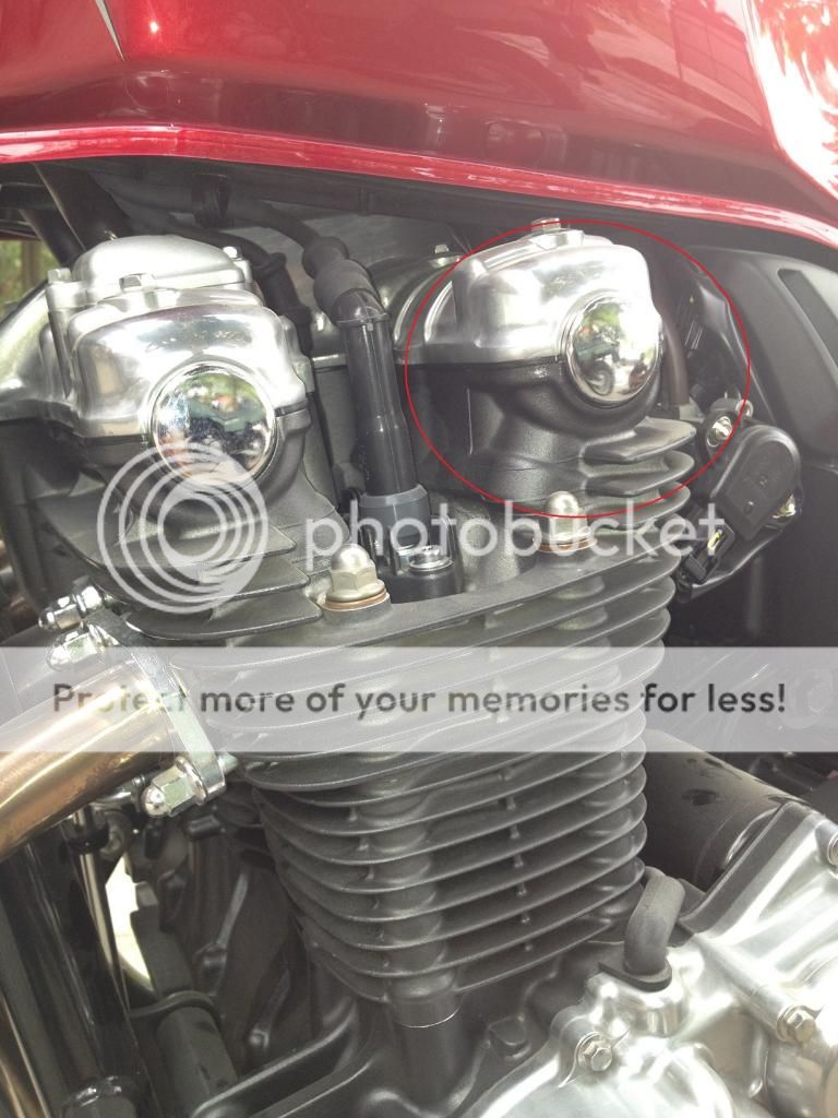

My CB1100 uses approximately 35 miles, the oil flow phenomena:
This failure of the manufacturer or by the user?
1.
[url=http://s977.photobucket.com/user/steed_boy/media/Loi%20chay%20dau%20dong%20co%20CB1100/005_zps3fd28937.jpg.html][Image: 47c6cc8cb266249caae1185e4a2777ed.jpg]
Zoom:
[url=http://s977.photobucket.com/user/steed_boy/media/Loi%20chay%20dau%20dong%20co%20CB1100/005b_zps807c079d.jpg.html][Image: 38dfe61dbd4f95a491243efdfee7a44d.jpg]

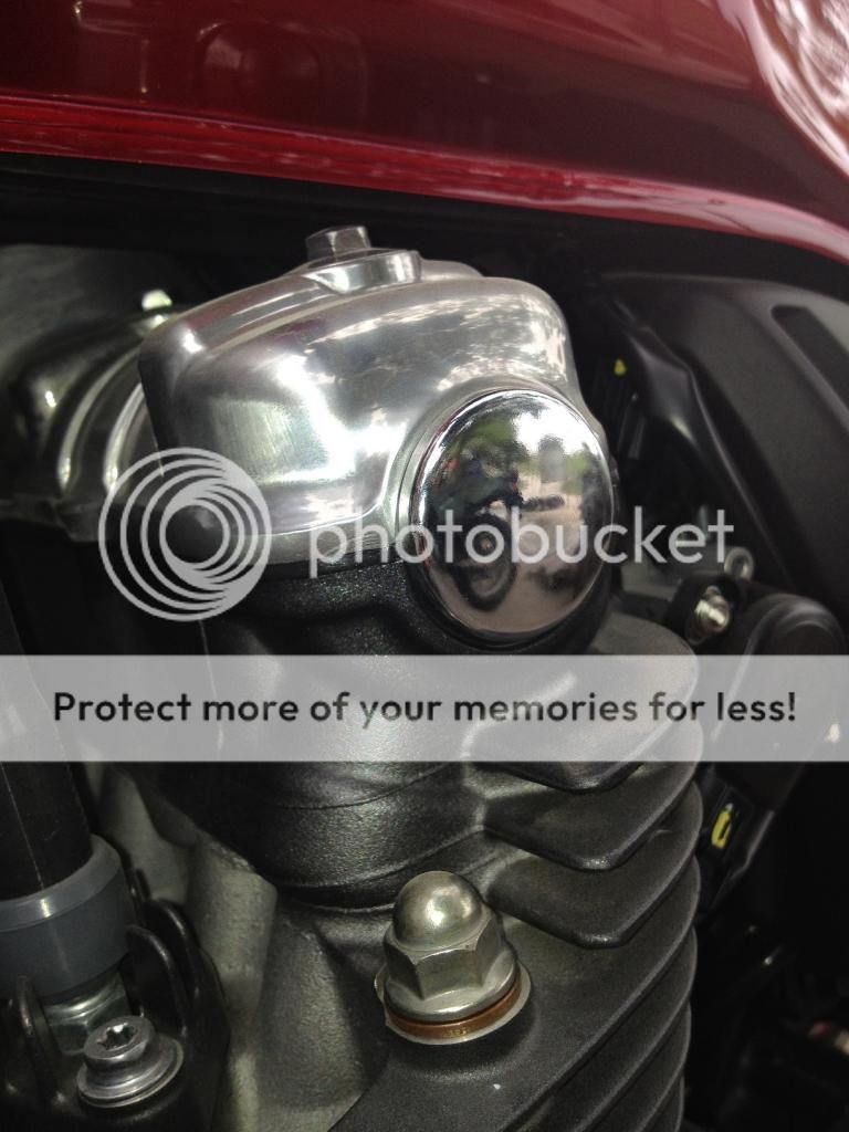

2.
[url=http://s977.photobucket.com/user/steed_boy/media/Loi%20chay%20dau%20dong%20co%20CB1100/001_zpsbbcfcf6d.jpg.html][Image: 3b725a50bb2ffc8a9ff617aefbdb8516.jpg]
Zoom:
[url=http://s977.photobucket.com/user/steed_boy/media/Loi%20chay%20dau%20dong%20co%20CB1100/001b_zpsb0ff00e7.jpg.html][Image: 75ab378976046bc0a7f46906bd460f03.jpg]

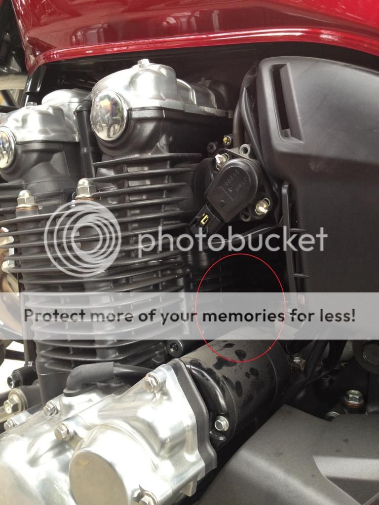

3.
[url=http://s977.photobucket.com/user/steed_boy/media/Loi%20chay%20dau%20dong%20co%20CB1100/002_zpsecade7e2.jpg.html][Image: 0f75b6c1cf5f5af52f1c539d2a3561d9.jpg]
Zoom:
[url=http://s977.photobucket.com/user/steed_boy/media/Loi%20chay%20dau%20dong%20co%20CB1100/002b_zpsa18de0c1.jpg.html][Image: b2e8d65a2aa1ab74b9628c1a59918560.jpg]

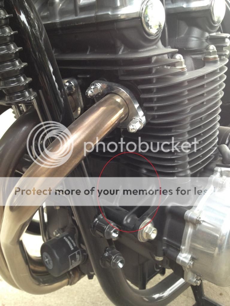

4.
[url=http://s977.photobucket.com/user/steed_boy/media/Loi%20chay%20dau%20dong%20co%20CB1100/003_zps1cc84832.jpg.html][Image: 997347df63ab08aa5496d0583c4b0b2b.jpg]
Zoom:
[url=http://s977.photobucket.com/user/steed_boy/media/Loi%20chay%20dau%20dong%20co%20CB1100/003b_zpsf371d0fe.jpg.html][Image: 696effb040f551c6198f94d03d477ccc.jpg]

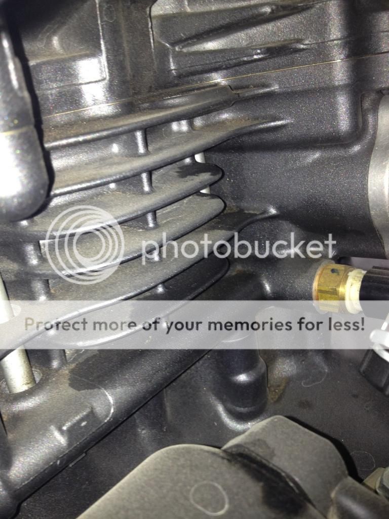

5.
[url=http://s977.photobucket.com/user/steed_boy/media/Loi%20chay%20dau%20dong%20co%20CB1100/004_zpsca45624f.jpg.html][Image: 207be6313d069d5969cab1d0a2f193f9.jpg]
Zoom:
[url=http://s977.photobucket.com/user/steed_boy/media/Loi%20chay%20dau%20dong%20co%20CB1100/004b_zpsd517b560.jpg.html][Image: c59e6dd92dad27d76d5ff9a87d124f3a.jpg]

Hmmm oil seepage in weird places..not at head gasket, not at base gasket. Looks like some at the valve cover gasket, but rest of seepage looks like it's coming out of pkaces where there are no natural gaps, unless the wind is messing with it. Were the valve clearances checked recently?

Did you smell something first like oil.Maybe it's coming from the
oil intake or outtake on the oil cooler.
Clean all the areas where oil residue is showing, clean it good. Check torque on all hardware close to the areas. Ride it in your normal fashion, check for leakage after every ride (try and catch it when it first leaks to see point of origin).............the rate at which it leaks will determine what kind of action you should take.

this is a good suggestion. But instead of Riding it I would advice not to.
Clean the engine with degreaser in all areas where there are signs of leaking then when everything on the engine is dry Start the engine and let it idle. Most likely you will see where the leaks are coming from. If you need help with any torque values or diagrams send me a message and I will email you whatever information you need.
