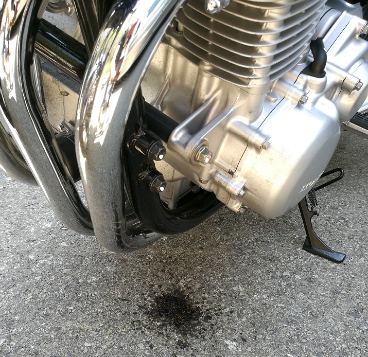

Hello
I noticed awter a while under sun (summertime in south of France, very hot), I had a pretty massive leak that sent gasoline.
My dealer told me it's normal at the beginning ... did it happend to some of you ?
When it is parked in the basement, quite cool, there is no leakage (full tank or not), it is related with heat / sunlight
[Image: 3fa706c1b918373d84f0492c11325b4d.jpg]
Someone told me that maybe the blowhole is blocked
(Sorry if im not using proper wording Big Grin )
Thanks
Gaby
G'day and welcome Gaby. That does not look normal to me.
I'm guessing the fuel in your tank just expanded enough to pour out the vent tube. I've never seen this on the CB, but I've seen it happen to lots of other bikes -- usually right after a fill-up and usually to people who sit on the bike and try to squeeze in every last drop.
If it keeps happening, maybe just try to under-fill a bit if you know it's going to be hot weather and you will be parked shortly after filling.
I was going to say gas tank filled with cold gasoline from underground storage tank, siiting in sun gas warmed up and expanded and had no where to go other than out vent tube. Seen it happen before.
That used to happen on my VT1100 Shadow Sabre, if the tank was full, and sitting in the sun for a while, like at work. It would just come out the vent tube.
