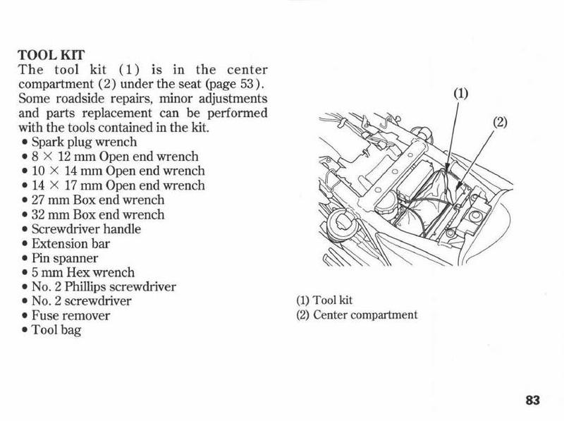

Call me ignorant but is there a photo or diagram that shows these toolkits? There was a toll in my kit that the Honda dealer didn't know what it was for. Would like to compare my toolkit to a diagram...
Sent from my XT901 using Tapatalk 4.2.4
The toolkit's contents are explained in the Owner's Manual.
Here is the Australian version (I have a pdf download here - easier than going to the garage every time I want to look something up).
Click to enlarge.
[Image: 0265411119fdde98d559d9a14c6fc0c2.jpg]
This is how it looks.
http://www.bike-parts-honda.de/thumbs/h/...__3100.png
But in the english owner's manual there are more tools listed than finally really available in German CB 1100 tool kit under the seat.
Does the content of this PDF really comply with your tool kit?
No it does not.
I checked in the garage now and in fact they skipped the first few parts.
The screwdrivers are there, teh 5mm hex is there, the fuse removal tool, and the hook spanner with extension to adjust the rear preload.
Frankly I do not miss the poor quality tools much. For a longer tour I'd take a leatherman (for the pliers) and an adjustable Spanner on board.
If you have to adjust the chain tension on tour you are either on a very long trip (then seek a motorbike workshop) or your tour preparation was awful (again, if need be then seek a garage).
I have a tyre repair kit in the underseat compartment which allows for reasonable repair of tubeless tyres without removing the wheel. So I only need the 27 or 32mm wrench at home, if at all.
All bike shops in the world will adjust chain tension during a pit stop, no waiting time, just a buck/Euro for the guys will do.
