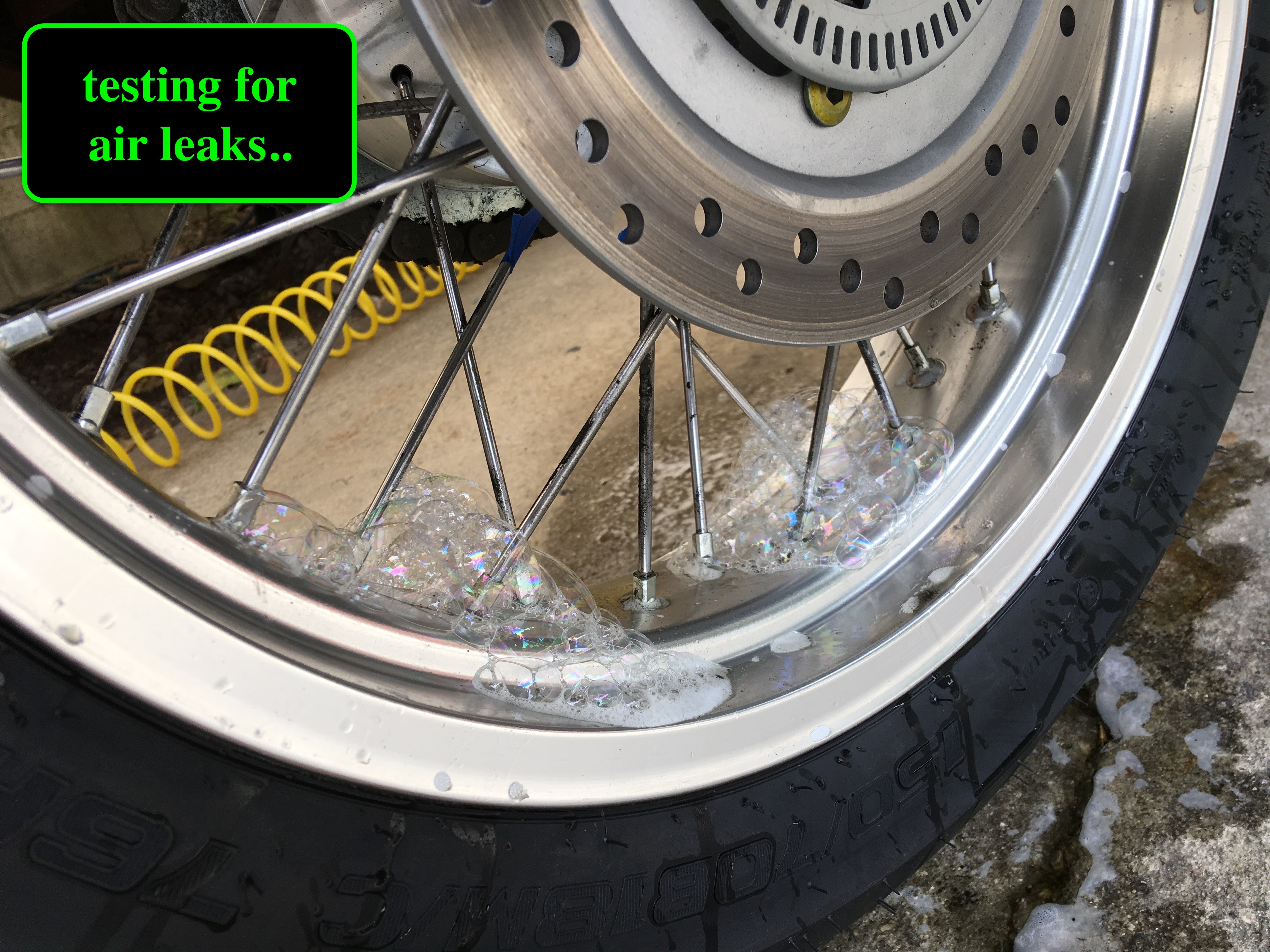

I came as close as I want to come to adjusting spoke nipples today as I want to .. after mounting my shinko rear tire and installing it on the bike, I found I had 2 air Leaks.. I found where they were coming from, then had my tire removed to remedy the problem.. that ran me an extra $28. for removal, installing, and rebalancing.. I have repaired the problem.. tomorrow I will have the tire installed "again" and balanced.. the shinko ran me $101. O.T.D. mounted and balanced, so I am still doing ok with my costs even with the extra $28.. I will be sending all the pics to Peter.. then hopefully, he will have the time to post them .. sorry for being such a dummy as far as posting my pics ..
(02-26-2019, 10:33 AM)Chuckk_imp Wrote: I came as close as I want to come to adjusting spoke nipples today as I want to .. after mounting my shinko rear tire and installing it on the bike, I found I had 2 air Leaks.. I found where they were coming from, then had my tire removed to remedy the problem.. that ran me an extra $28. for removal, installing, and rebalancing.. I have repaired the problem.. tomorrow I will have the tire installed "again" and balanced.. the shinko ran me $101. O.T.D. mounted and balanced, so I am still doing ok with my costs even with the extra $28.. I will be sending all the pics to Peter.. then hopefully, he will have the time to post them .. sorry for being such a dummy as far as posting my pics ..
LEAK REPAIR posted for Chuckk:
[Image: e3bf80f8348fbb6a44f3d18912b2e8bf.jpg]
[Image: 2fb80fc20d0e5f9feb21401666edff8a.jpg]
[Image: 069611170c507f5ee79e0f5dfa46ff10.jpg]
[Image: 191a1187c74938929a8fd6b17604f5e0.jpg]
[Image: 2953e707f17084ef5f8649cdcb94e032.jpg]
[Image: c1fc39dfdf627e6136a449f8b91fd9c4.jpg]
[Image: 32649a2c0c55aee449e05831c9646f52.jpg]
[Image: e8d4c8ae3adedf523abb9d51249af1f2.jpg]
[Image: 57b6f4f6bf02fe81409b81f1cacdaeb0.jpg]
Smile
I have 2 questions.
How would you have checked the air pressure without installing the tire (2nd pic)?
How did you put the text balloons on the pics?
And my question: Does the 5200 adversely affect wheel balance? I assume you balance the wheel as you normally would, but if applied unevenly, does it create balancing issues?
