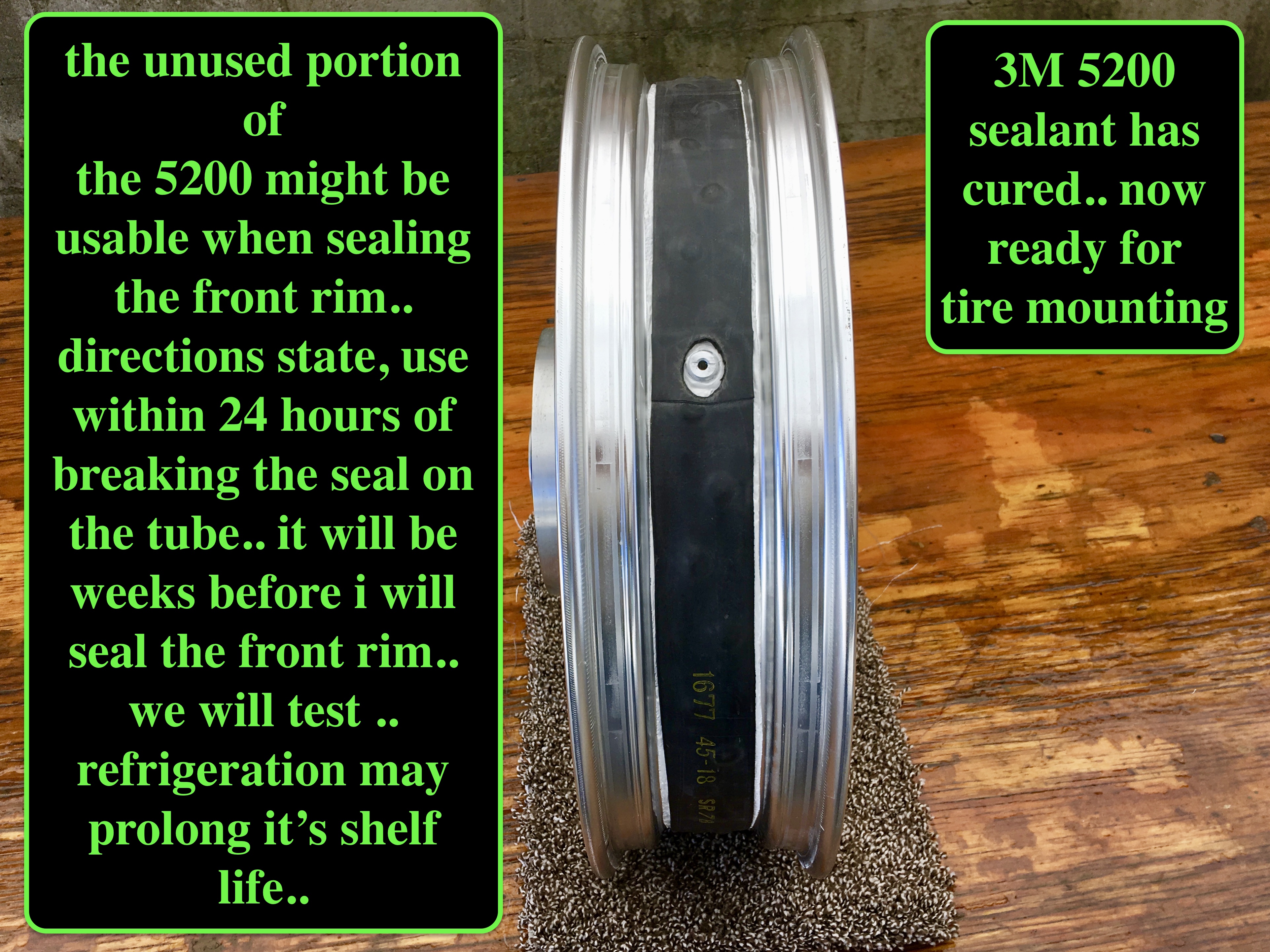

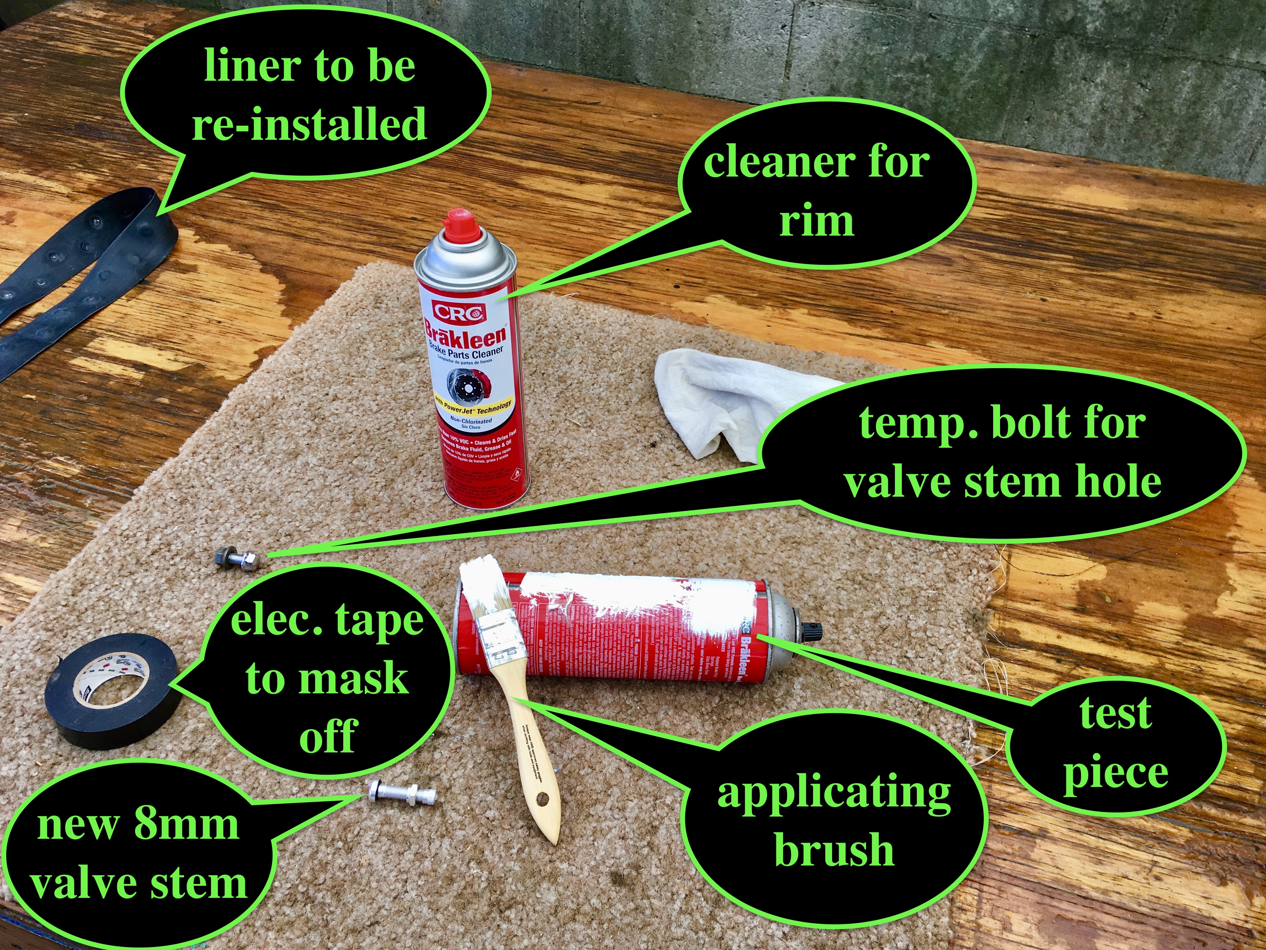

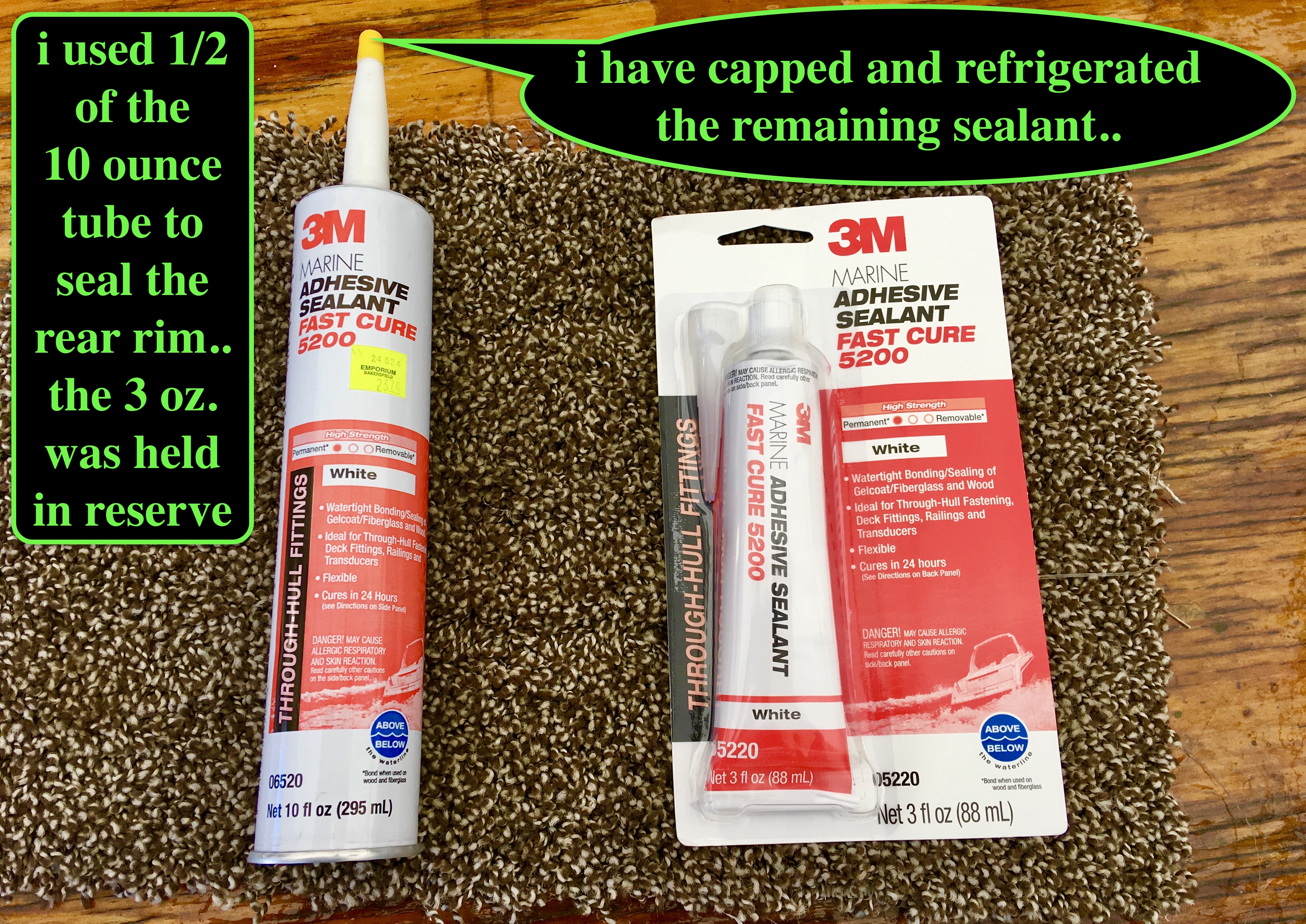

it's Chuckk .. let me be the canary in the mine tunnel .. my rear tire is now worn out on my 2017 CB (2700 miles) .. I have taken pics and captioned them.. hopefully, Peter has the time to post them for me.. I have sealed my spoked rim and am ready to have my first shinko 777 tubeless tire installed on to the rear of my bike, without an inner tube.. it's a 150/70/18 .. I'm hoping this works !! .. wish me luck ..

THIS IS CHUCKK & CHARLOTTE PROJECT, just posting for them Smile
[Image: 34d9c370f5ed41164c9d0bb601e2f670.jpg]
[Image: 1ffaa2fdaacd2556795fd2c921900dcf.jpg]
[Image: 921f41dffed75e01103f58cf85a14044.jpg]
[Image: a4d6df070701472149d9b147fa0749a3.jpg]
[Image: 6ae0d9f1f990b2db7710c2f3276cfb07.jpg]
[Image: 984cfe27388dfd0086b8f7b163829507.jpg]
[Image: 51779b00592e0084773e56bc4062018b.jpg]
[Image: 61f4c7edd641cabc8da3bdf6e54762cd.jpg]
[Image: 6ebd27e4f6bf49cc62b0add42e484939.jpg]
[Image: fbada58b6fbbd13768db704f20e6384c.jpg]
[Image: c8f6037c10b54682b854a6a6ee485f8f.jpg]
This is Charlotte
Chuckk, this seems to be too big project just by yourself..did Charlotte help you? Tongue
yes.. Charlotte gives me guidance..
Cat has a name! Hello Charlotte.
That's a pretty detailed sealing job. I reckon any imbalance caused by the sealant is negligible? (i.e. no re-balancing?)
