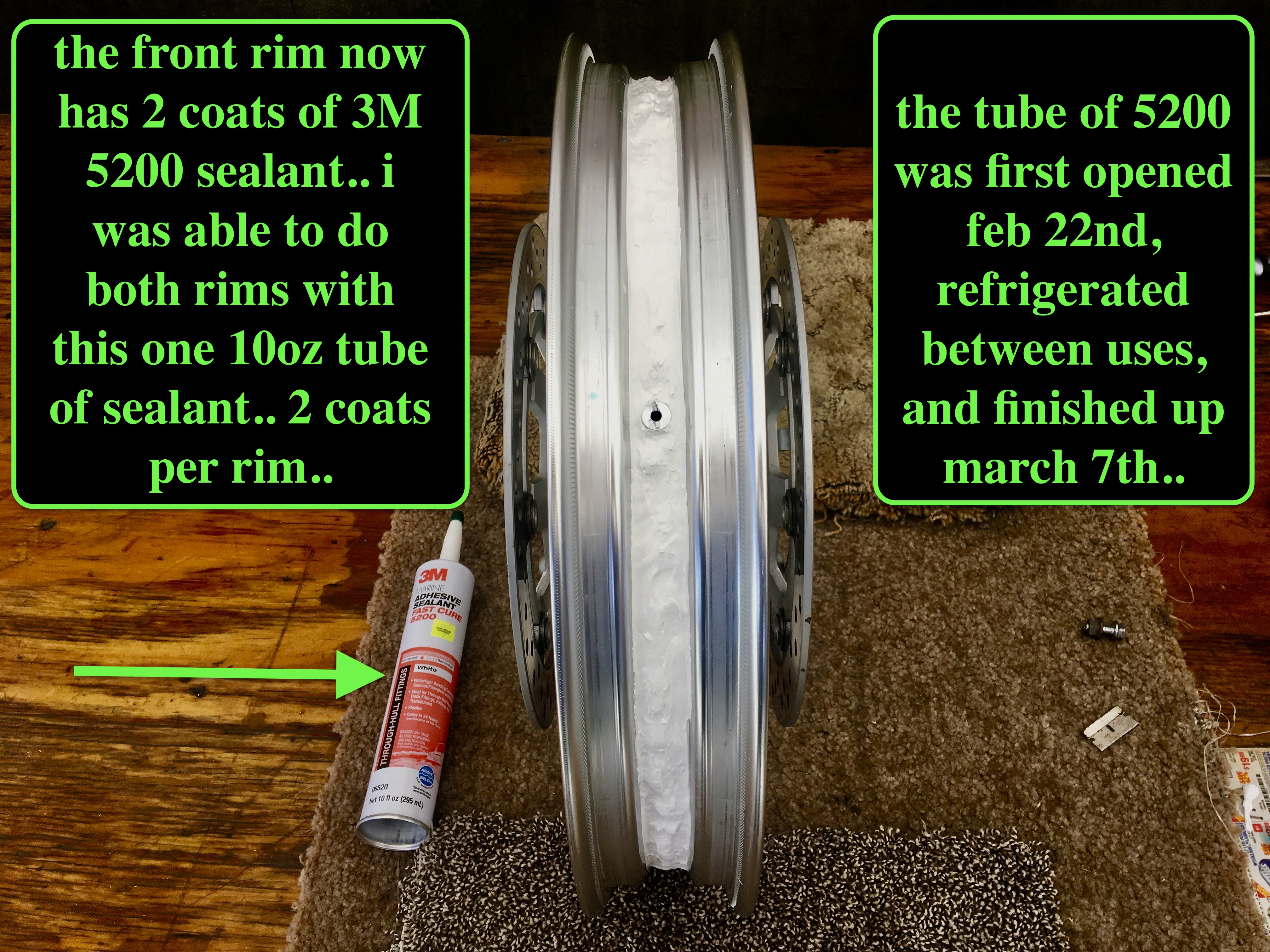

(03-09-2019, 12:00 PM)Chuckk_imp Wrote: the time has come to install the front shinko777 120/90/18 on my 2017 CB 1100ex..I was able to squeeze 2840 miles out of the front, just a little more than the rear gave me.. learning from the past, I did a more thorough application of the 3M 5200.. I gave it 2 coats right off the bat, concentrating on filling every spoke nut void..I used a smaller acid brush this time.. it acted a little more like a bondo spreader, which I liked.. I took a few more pics.. perhaps Peter can post them for me.. installing the wheel on the bike might be a little bit of a challenge.. we will see.. chuckk j.
HERE YOU GO CHUCKK - PICS, as requested
[Image: 9cc23b3ac0fe82dc0ece06cf8be8c8ef.jpg]
[Image: c29a72b8661500d5ed25f9792c76e202.jpg]
[Image: ab3518a4fbf9edc384ca979965bd3237.jpg]
[Image: e57ae6e91ef2852919c4c6250f8439d6.jpg]
