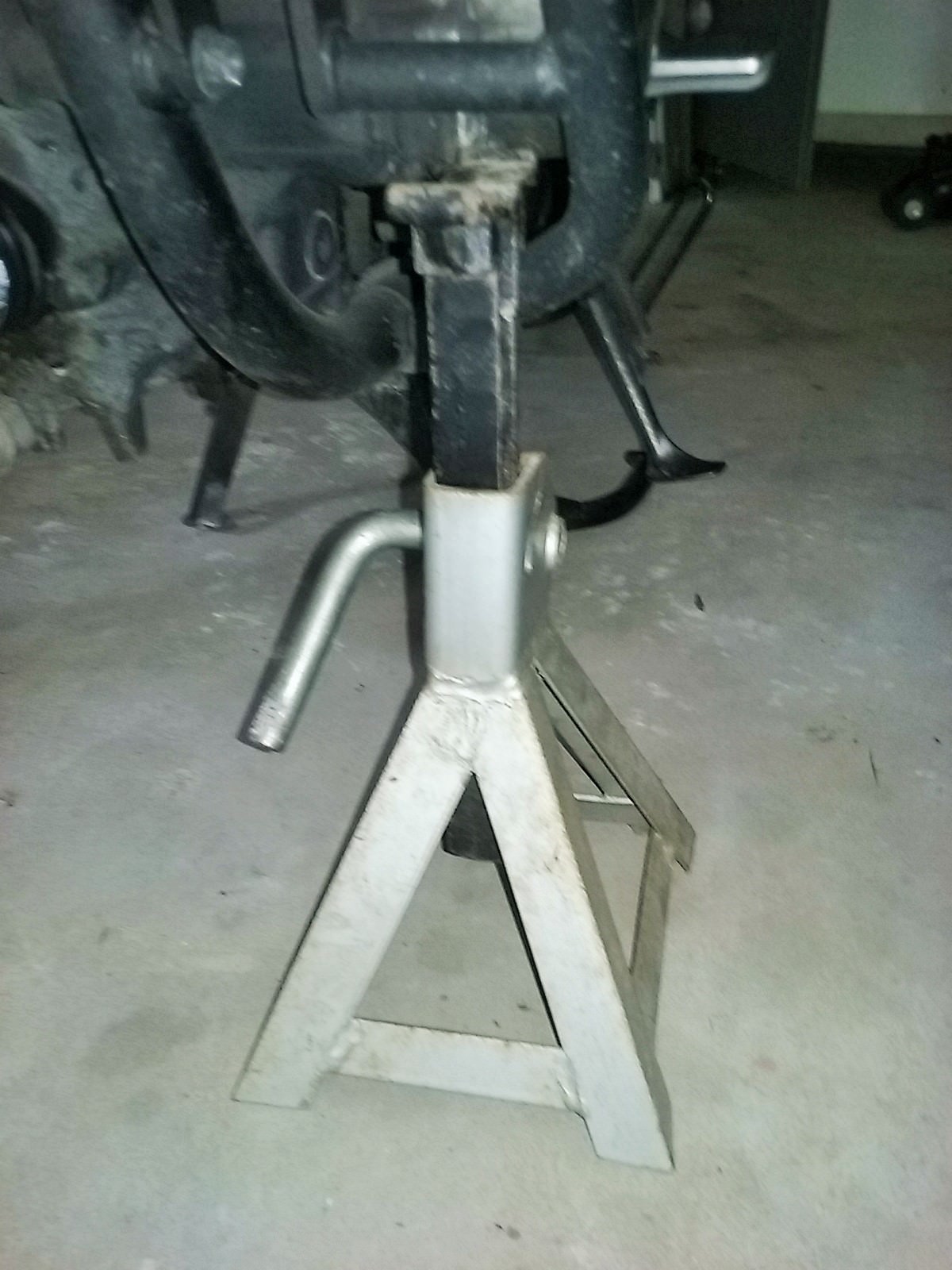

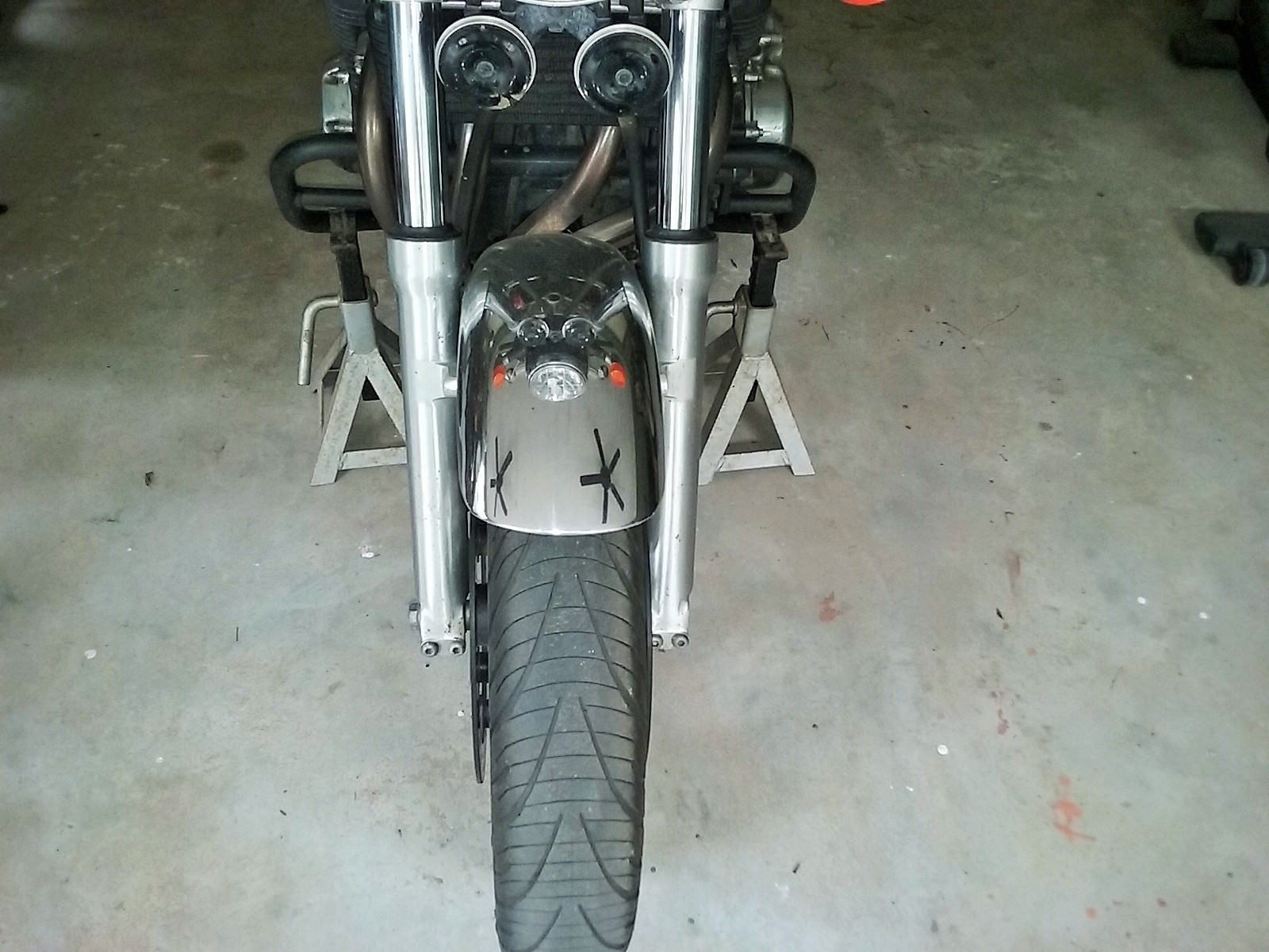

Those are the bars. There are two points where the bars connect to the front frame down tube. The lower connection is a horizontal bar, perpendicular to the frame. This is where you place the jackstand. With the bike on the centerstand, lift the front of the bike with a scissor jack then slide a Jackstand under each crash bar.
[Image: a02315336f1a0aa20b6e2ea58635e80b.jpg]
[Image: d4c06d629d44b892fd75c028ec69b251.jpg]
[Image: 1fbc714dcebddd8307ca57d52ba8d240.jpg]
[Image: 55701938214b8422edc416054d25df4f.jpg]

Use a block of wood between the jack and pipes. I generally pull up the front of the bike while my wife places the jackstands.
