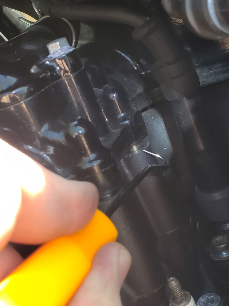

The other day I noticed a small looking oil seep left hand side, toward the top, rear right under the valve cover. I did a search and found that other have had this same leak and it ended up going away on its own.
I cleaned the area in hopes mine would do the same but as of this morning, no dice. I now have fresh oil in that same spot. (kind of hard to see in the picture but its there) just on top of the top cooling fin. I want to say its originating from the valve cover gasket itself, maybe even a little from the gasket nearer the center of the valve cover.
[Image: b8aa47ec81189c6cd03911ec01c079ac.jpg]
Has anyone replaced the valve cover gasket themselves? Looking at it, I don't think it would be too difficult assuming there is enough space to take it out without pulling the engine. and would there be any other seals etc. needing replaced or just the gasket itself?

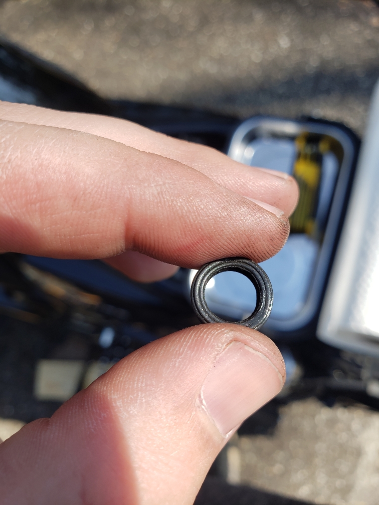

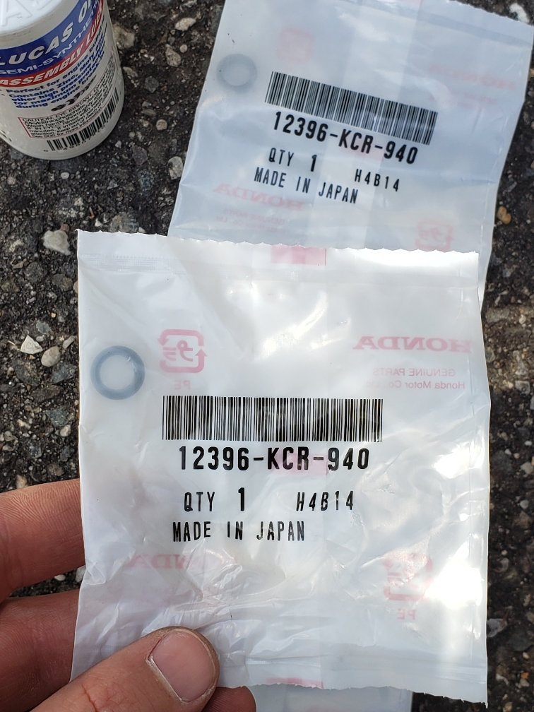

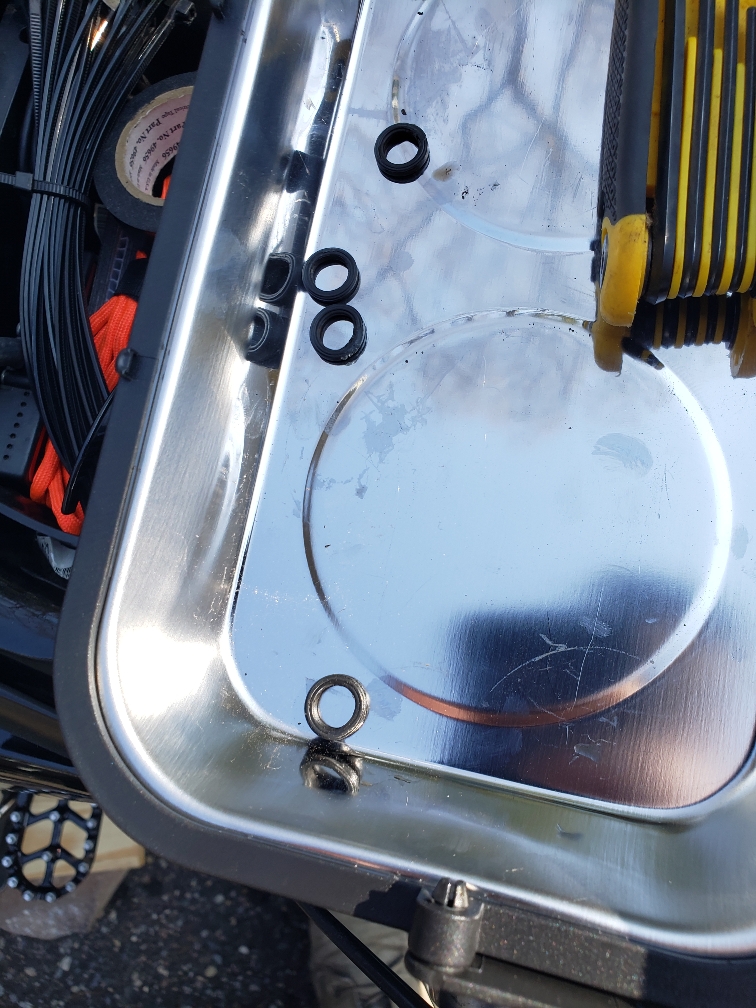

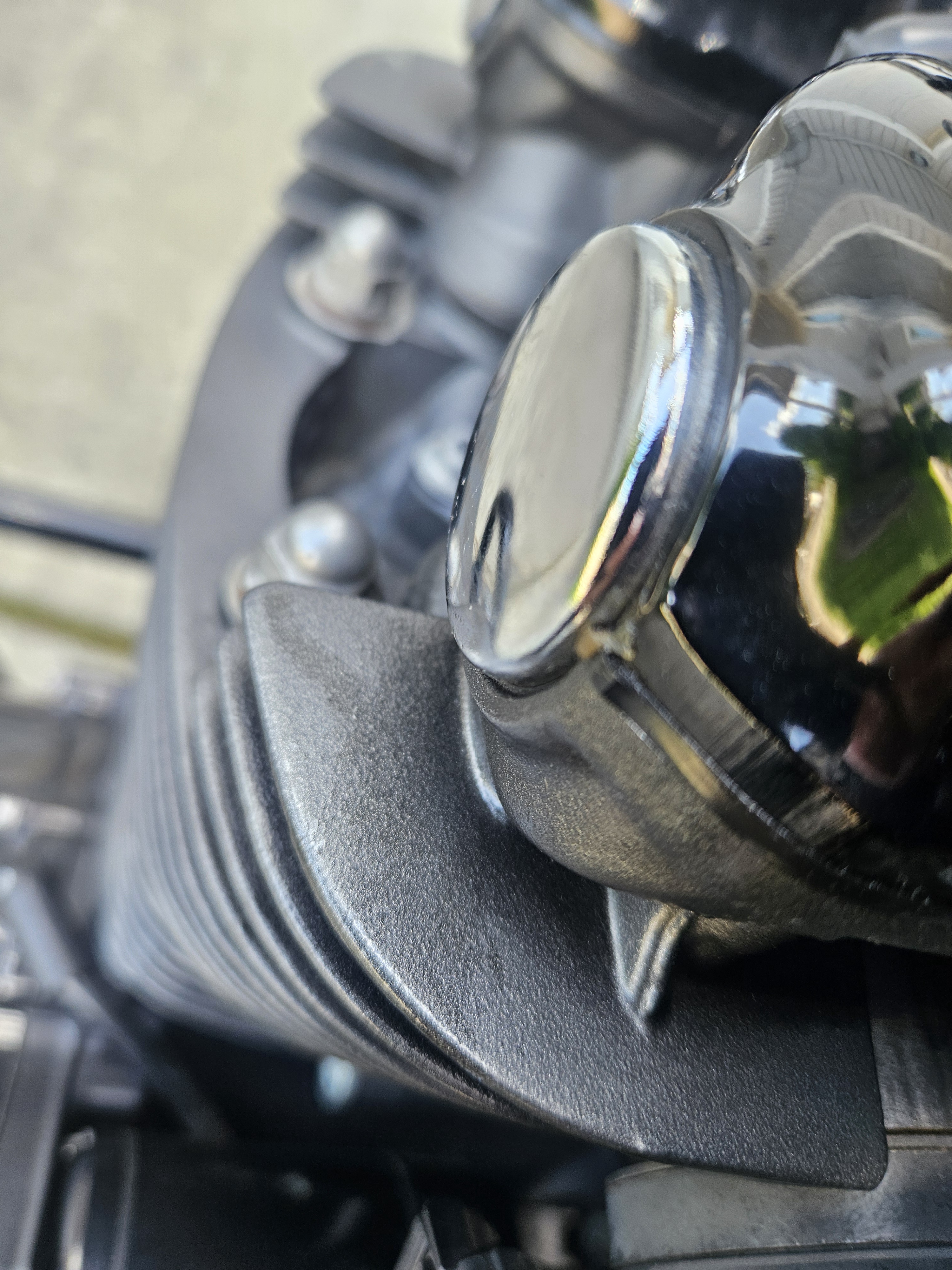

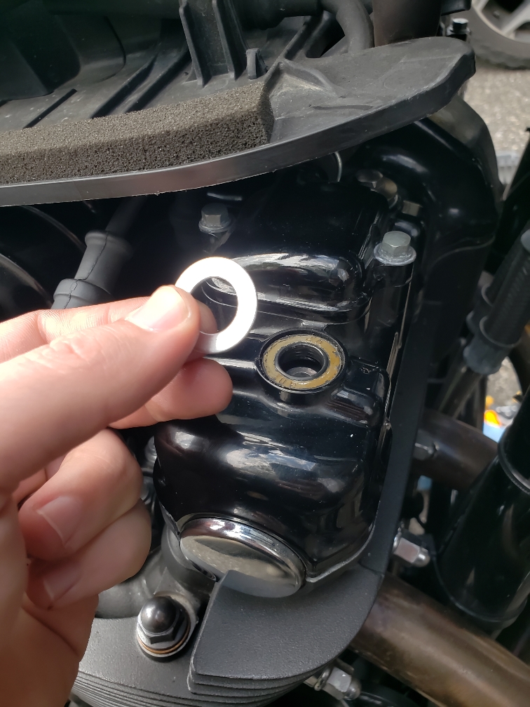

I just opened the valve cover a few days ago to do the 4 small o rings in the PAIR valve system because the new noise was driving me crazy from them leaking.. tank had to come off but it was honestly still pretty tight under there. It would have been more of a project IMO to get the cover off completely instead of just lifting it up to get the o rings/seals out like I did. It's definitely doable but you'll have to remove some more stuff to make some room. I meant to do a write up and forgot, I may just do it on the new cb1100 net site.
Off topic but I took the advice of a 2014 owner on YouTube and added a 1/2 ID x 7/8 OD - 18 gauge machine bushing/washer under my front valve cover bolts to compress the front of the cover down slightly more because there is a surprising gap between the cover and heads where the pair valve seal ends up leaking under load... so I would also replace those 4 small seals/gaskets if you are already taking the cover off.
