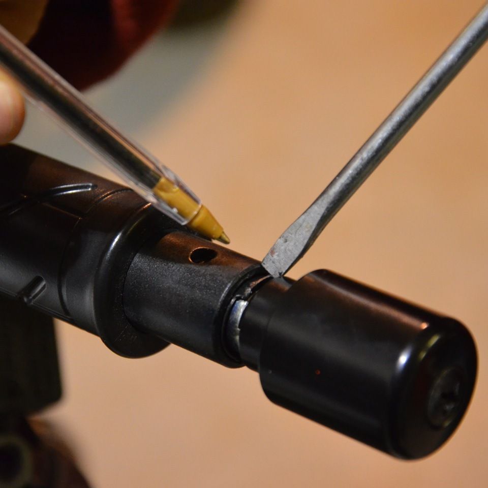

I wonder if the CB1100 uses the same bar end weight clips as the CB500. If so, there is an easy way of removing them by rolling back the grips, pushing the clip tangs in, and drawing the weights out.
![]() It is fully explained in this [url=http://www.cb500x.com/index.php/topic,3834.0.html]BAR END WEIGHT thread on the CB500X Forum.

I just looked in the service manual and it says to do pretty much what your pic shows. Straighten the retainer tab with a screwdriver or punch Temporarily install the handlebar weight (the end weight they are talking about) and screw, then remove the inner weight while turning the handlebar weight. Note: Apply lubricant spray through the tab locking hole for easy removal. It also says to use a new retainer when reinstalling.

yes exactly like the 500x as that is the bars i used. puill off the grips and throttle and push in in the small holes top and bottom
not real hard to do ther is just a little catch in there
