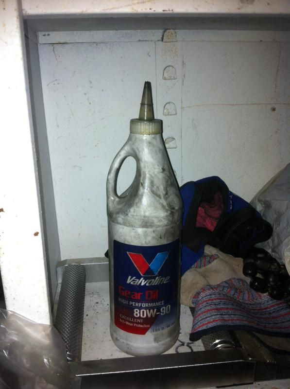

[url=http://smg.photobucket.com/user/djs_151/media/pics2/2F03713F-7203-469E-A58B-2D4F94504BFD_zpsagulb955.jpg.html][Image: 45e46096ab22548232798bbf34437b44.jpg]
i usually drip a little oil from the bottle onto the chain, spin the wheel then let it sit and wipe.
not sure putting the oil on the rag first then wiping the chain with the rag will get enough lube on the chain.

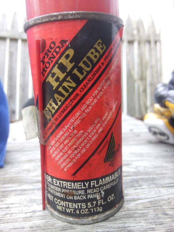

[url=http://smg.photobucket.com/user/djs_151/media/pics3/IMG_20150430_163910_zpsebh6enhw.jpg.html][Image: 3a884efb57a479ff1c1da185e6e791ed.jpg]
i have a can of this stuff too.
