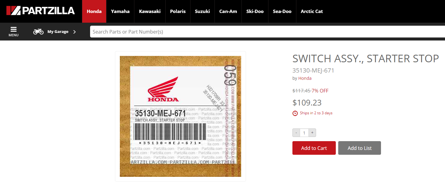

Check [url=https://www.partzilla.com/product/honda/35130-MEJ-671]partzilla.com?
[Image: a526aa54145ff944cf25a05085e3567f.png]

(06-30-2021, 01:03 AM)Stichill_imp Wrote: Check [url=https://www.partzilla.com/product/honda/35130-MEJ-671]partzilla.com?
I actually ordered it from Partzilla but I'm skeptical they actually have it in stock.
