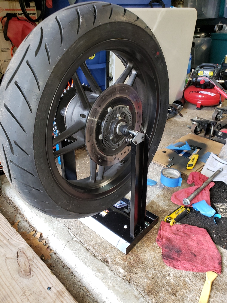

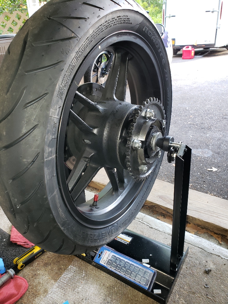

Haha definitely did. As previously stated I forgot to balance the wheels before I put them back on yesterday so I pulled everything apart and did it just now. Balanced perfectly with the Harborfreight Balancing stand. I used a straight edge to make sure the rod wasn't bent and then sprayed the silver weights black to match my rims. [Image: e47ea03cbbc4bcd6228967542fef3314.jpg][Image: 23655b928334875eb2d594a15e7450d6.jpg][Image: 2320d5a3aceb2f14f734cdd9476ae14a.jpg][Image: 1d34c6625a110f762afee175f1ef3d96.jpg][Image: 4a2b0b99bfd598f96f276a17c2ce3527.jpg][Image: 3fc282c029eec3966ac46994cfb20a2c.jpg][Image: 8219744ead332db3d84aed0086bb61c7.jpg]
#28
I use a Harbor Freight balancer too, but I don't balance them with the wheel spacers in place, I go right up against the bearings. I find the wheel bearings have less friction than the balancer bearings. That's on newer wheels, with fresher grease.

(06-25-2020, 10:35 AM)pekingduck_imp Wrote: I use a Harbor Freight balancer too, but I don't balance them with the wheel spacers in place, I go right up against the bearings. I find the wheel bearings have less friction than the balancer bearings. That's on newer wheels, with fresher grease.
Good idea, I was strong arming those cones against the collars to make a tight fit... didnt even cross my mind that they wouldn't affect the balance [Image: 2b3bbc4c83a250f3537b553c9859e95d.png][Image: 1bfc21339a9d0617cd66564822a4b300.png]
