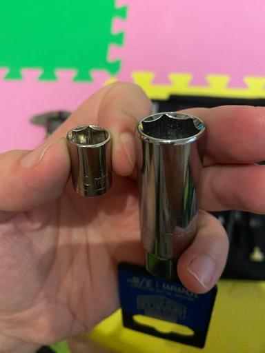

The 10mm spark socket is definitely not 10mm socket. I’m soooooo confused!!!
[Image: cd4b2375bea9a678975329144fcfb926.jpg]
[Image: 86130b874a2f19f24d4ba72ab2eb612c.jpg]

(10-24-2020, 07:53 AM)mrded_imp Wrote: The 10mm spark socket is definitely not 10mm socket. I’m soooooo confused!!!
3/8" - does that refer to the socket tool receptor? i.e. 1/4", 3/8" and 1/2" are standard SAE receptor sizes.
Yeah, in terms of the socket tool receptor 3/8" is definitely not 10 mm. More like 9.5 mm.
I’m not worrying about a socket size where it’s connected to a ratchet. It’s more like a sprocket nut+thread sizing is confusing.

All sorted. I had just a crazy socket. [Image: a5c86f60b814731208a1ed92ad716b4c.jpg][Image: 040938394a9e80b176f23be6636b61be.jpg][Image: 754c51adf422bd21a844542151b7f4db.jpg]

The 10mm for a spark plug refers to the thread size, not the A/F of the hexagon body.
The three sizes in common use for cars and bikes are:
M14x1.25 = 13/16" hex
M12x1.25 = 11/16" hex
M10x1.0 = 5/8" hex
The 3/8 referred to on the packaging is the square drive size for the socket.
