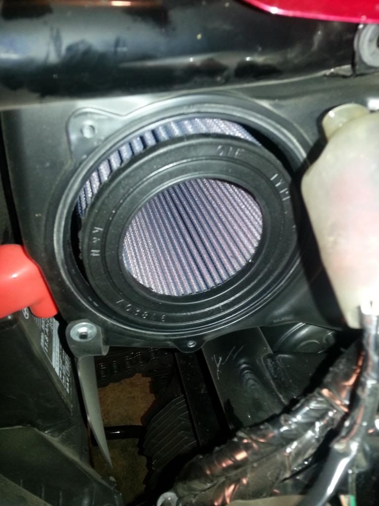

Well I had bought a TSR Air Funnel Kit, Air Intake Funnel and K&N Filter HA-1301 for my bike. These parts are sitting in my closet till this winter when I will install them.
So I go and open them up for the first time to see if I have this same issue... I do not? My K&N Filter snaps right onto my TSR Intake Funnel.
So if I was to guess... K&N messed up on the boxing of their items.
I can provide pictures if need be but again I have no issues and my K&N Filter does not look like the one at the beginning of this topic.
I hope this helps.
Further evidence of quality control issues at K&N??
I had no issue installing mine. Not really sure what's going on here...

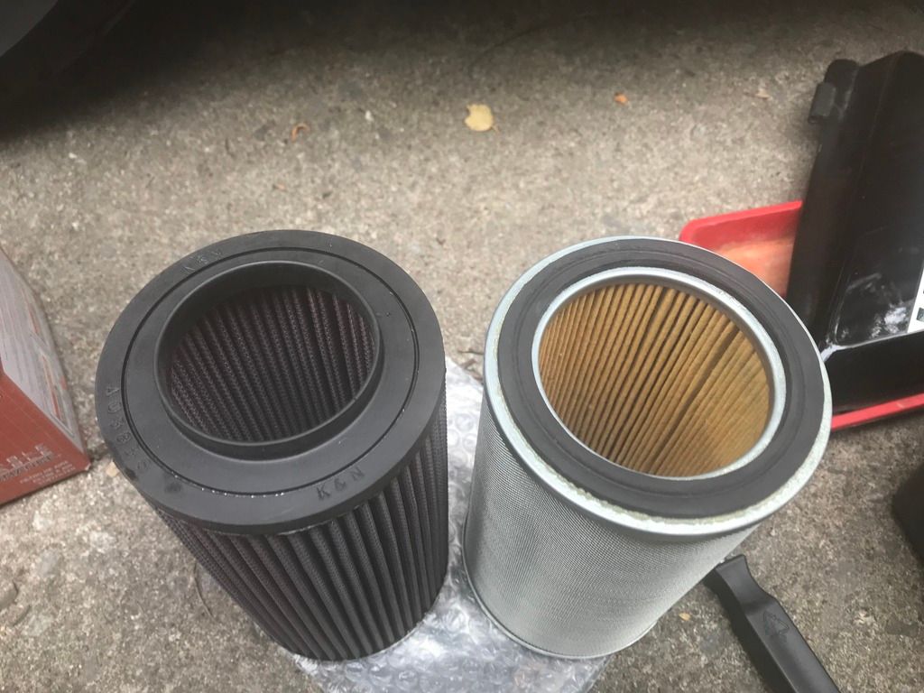

Now that Photobucket pics seem to be working again, it seems clear that the K&N HA-1301 that the OP and I got are substantially different than the one you installed on your CB.
(09-18-2018, 04:39 PM)Flynrider_imp Wrote: Now that Photobucket pics seem to be working again, it seems clear that the K&N HA-1301 that the OP and I got are substantially different than the one you installed on your CB.
I would have to agree. It looks like if you trim the lip that it should fit.
[Image: e494140d90eededdb236984fdbbc16ee.jpg]
[Image: e674c8bf1f90a668a54c2a43dab575c2.jpg]
I just picked up a k&n HA 1301 and it does not my 2013 airbox. Same iasue as above......I'm not sure what to do with it , maybe try cutting it up, but I don't like the idea of a janky fitment...

(12-26-2022, 08:01 AM)Wilbury_imp Wrote: I just picked up a k&n HA 1301 and it does not my 2013 airbox. Same iasue as above......I'm not sure what to do with it , maybe try cutting it up, but I don't like the idea of a janky fitment...
Hey, sorry for the late, it appears that they sent me the wrong part. Just let them know (I guess you already did but just in case) and they will send you the right one free of charge.
