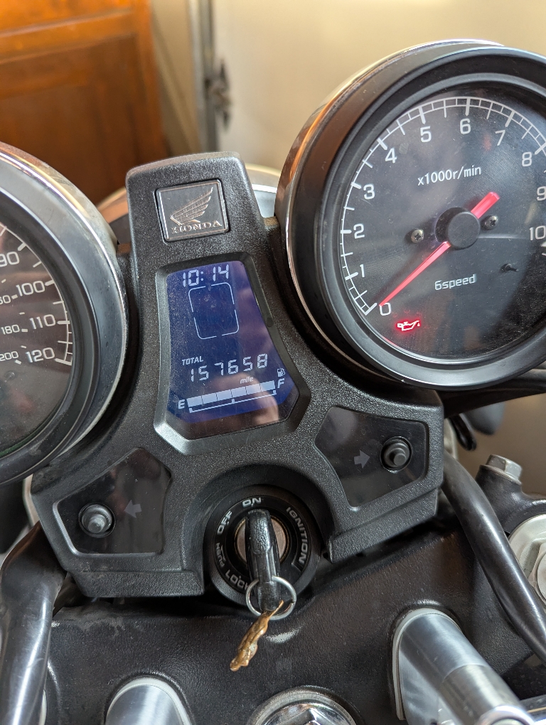

I still haven't checked mine.... [Image: 1b719f286a3aadb01b286da3cb60a0e4.png][Image: a666c8f057e828d19b949d70c09406e6.jpg]

I haven't checked mine either but I only have about 1/2 the miles of MMC lol
