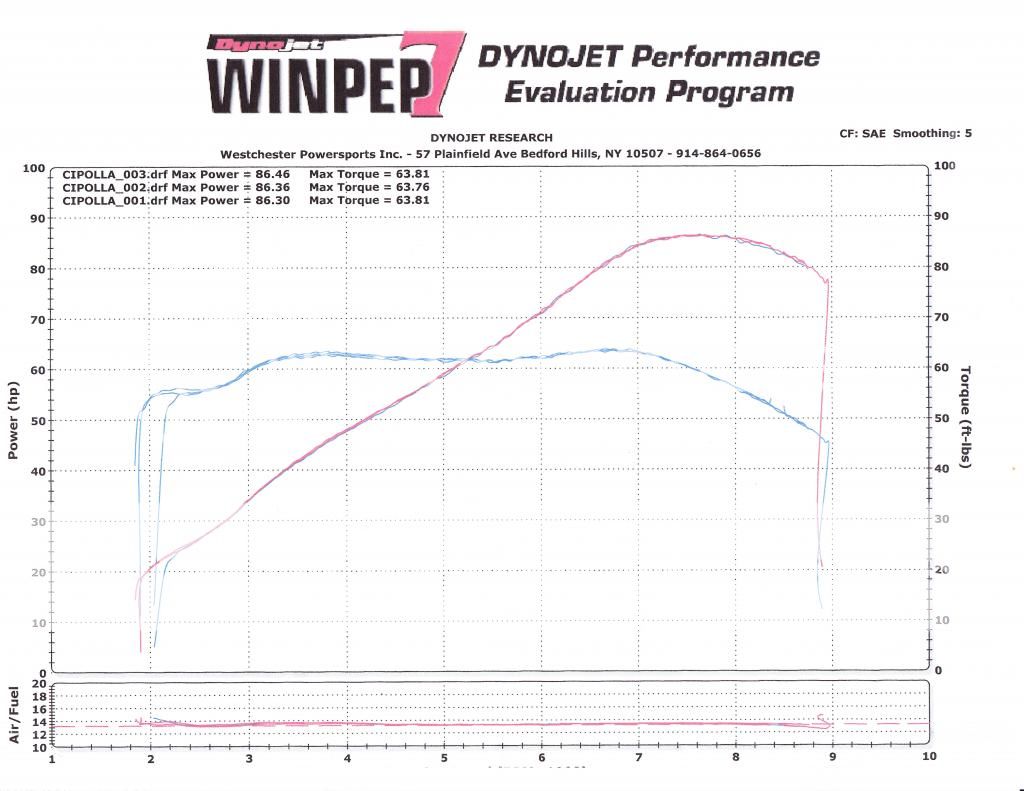

Below is my air/fuel ratio, you can see the dip in torque between 4K-6k, these bikes like to run just above 13.2 and they get a bit rich on top. Don't be to concerned about peak HP, different dyno's can very as much as 8%, but your torque curve doesn't lie. The important thing is to get a baseline and improve on that.
[url=http://s1034.photobucket.com/user/cipolla57/media/sc_zps7b3018f4.jpg.html][Image: 6b96ce11bc476cf4b3de95ed213f67a9.jpg]
