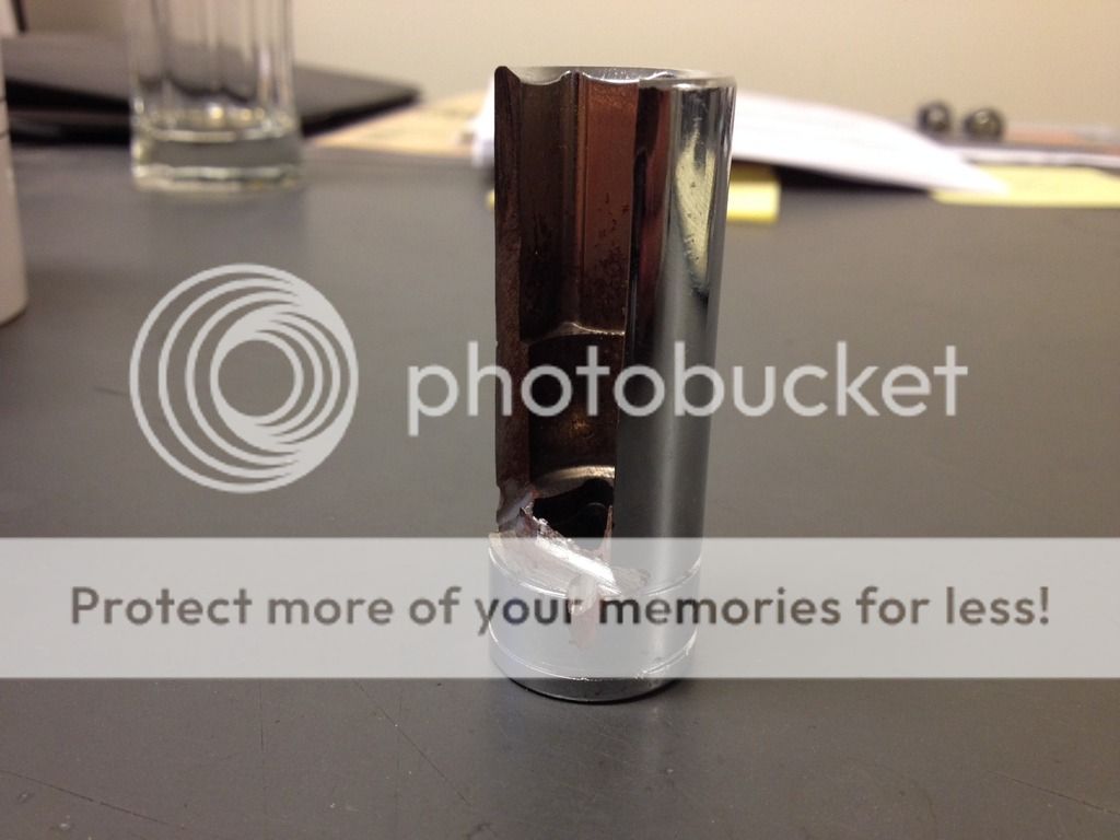

(06-26-2015, 12:18 AM)mininsx_imp Wrote: I was looking at what's involved in removing the sensor yesterday and it looks to be a pain to take out. I might just leave it in and forget about it.
Its not a big job, get a 17MM long socket and cut a 1/4 out with a angle grinder. This will get the sensor out without a problem. Remove the wiring and save it in case you want to put it back.
[url=http://s1034.photobucket.com/user/cipolla57/media/photo_zpsa9yoraal.jpg.html][Image: aa662a03cbf09dabc03344f88252325f.jpg]
Do you have to drop the header to get it out or can you remove it without doing so?
I cannot see any other way to do it other than removing the header. The heat shield is welded on and in the way and there is very little room between the frame and the header. I have yet to remove my header to address this as I don't want to risk screwing up the exhaust port gaskets in the process.
