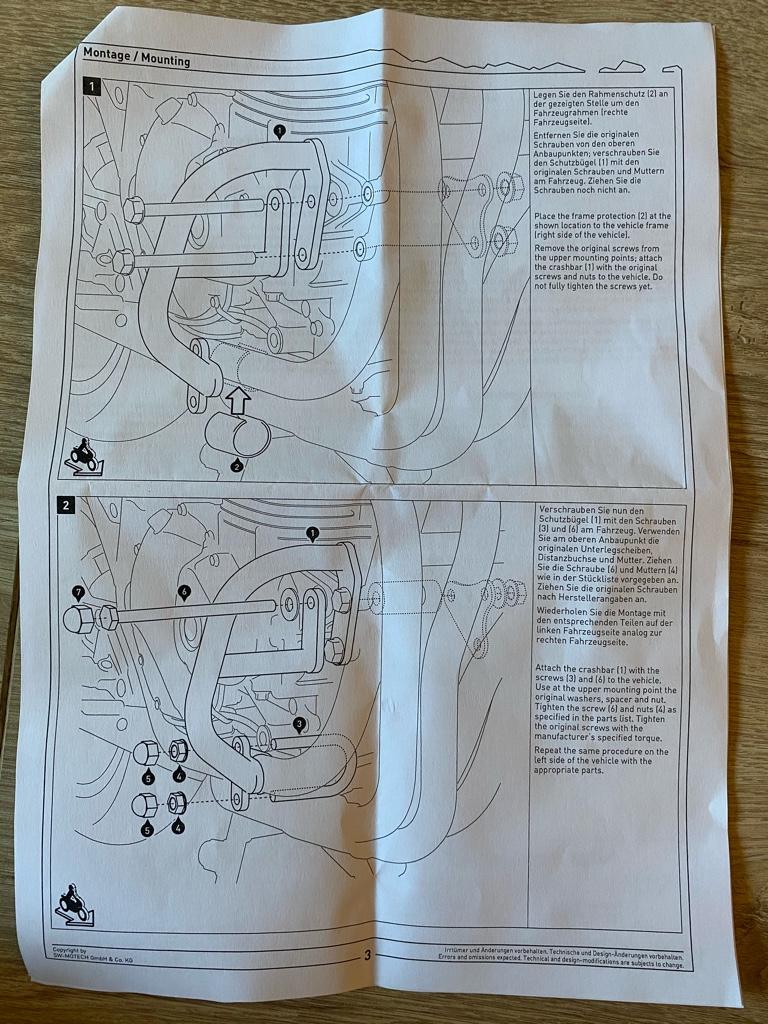

This is the doc for cb1100rs ‘18 see-motech crashbars
[Image: 5e8cd782aae46f82246db4469cceae3b.jpg]
[Image: 5886ca333e4b7a8aea0fedc8c8828b9d.jpg]

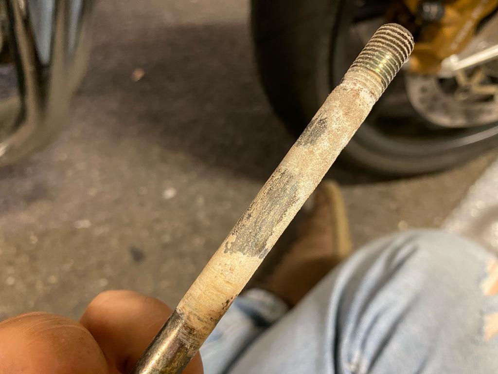

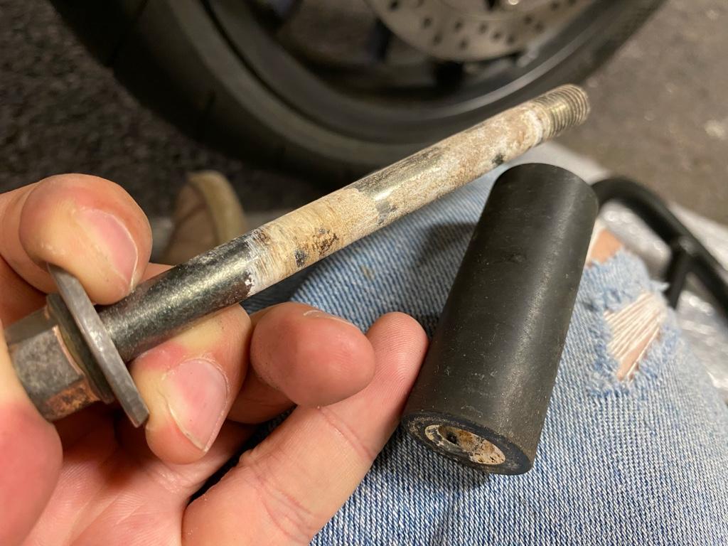

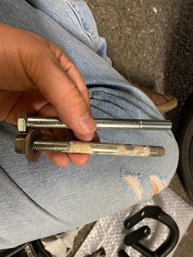

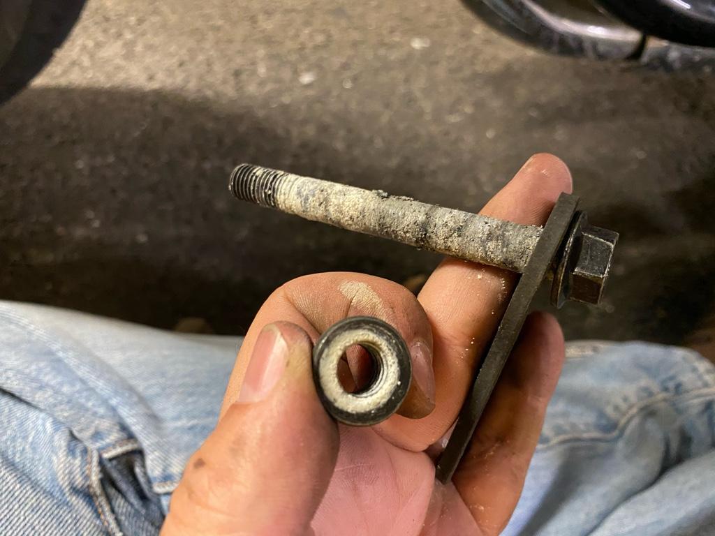

I took those bolts out, and they are covered with some kind of power and smell like fish Smile
What is that? Is it ok?Smile[Image: 5ccbcf0e4e0ef3ec2c5c249084ad4f23.jpg]
[Image: 178f0090dd0c93c1042357384d1bdedd.jpg]
[Image: 812412be43e4137f5ed16bc5e4fabccc.jpg]
[Image: 593328bdcb9f5cc710d74b25acc45e1e.jpg]
#38
I think it's just oxidation. I'd wire brush it off and put some grease on them.
#39
What Ferret said. Clean off the oxidation and that grease certainly wouldn’t hurt.
#40
Yes, they use fish oil for a healthier bolt life.
