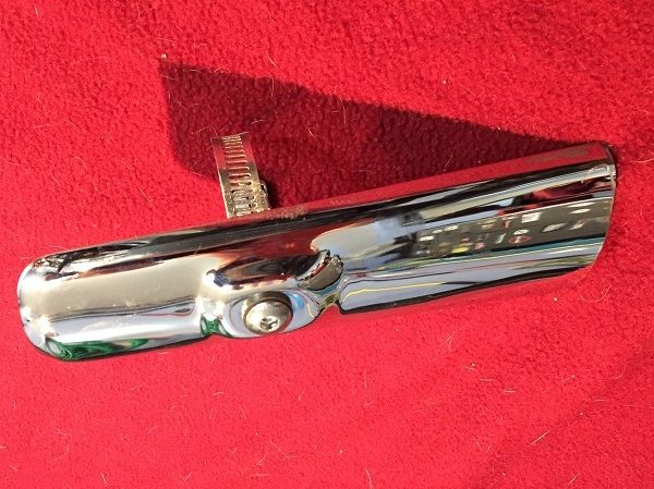

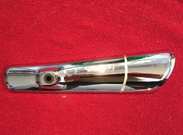

I used a Dremel with a cutting wheel to shape the covers then drilled a hole in a hose clamp, attached the hose clamp to the covers using a stainless steel bolt and nut, then hose clamped them in place.
Here are pictures of one cover off the bike:
[url=http://s1376.photobucket.com/user/ronsteinbruegge1/media/Mobile%20Uploads/00000000-0000-0000-0000-000000001A3D_zpsj1nekkoc.jpg.html][Image: 5eda9a3da2d0cd7ffaa89425500dde4c.jpg]
[url=http://s1376.photobucket.com/user/ronsteinbruegge1/media/Mobile%20Uploads/00000000-0000-0000-0000-000000001A3E_zpsvq0lyg04.jpg.html][Image: b20fc16c95bf5ec570f8fb63c29d7e07.jpg]

I see what you did there. Very nice, thanks.
