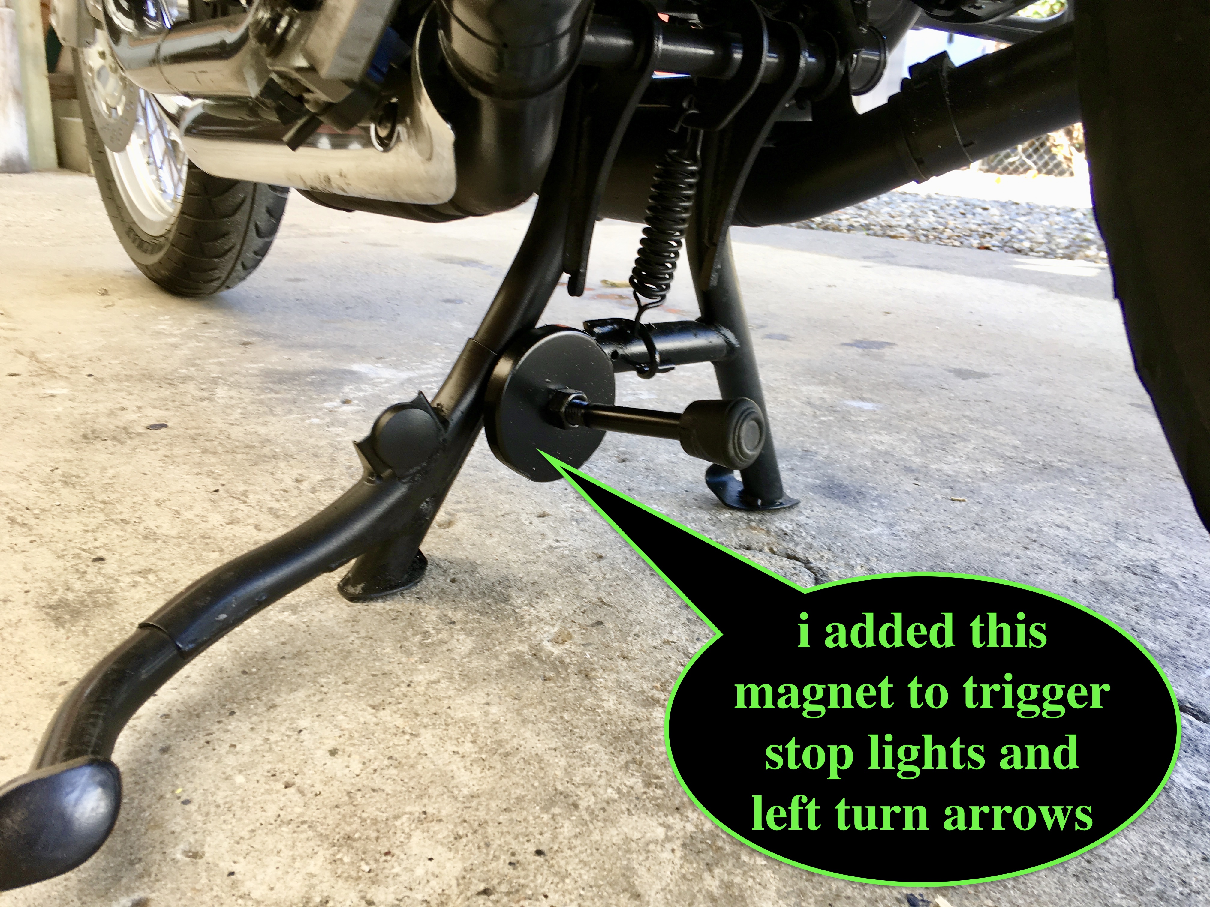

Here are some pics of center stand project..
[Image: 6bee2e177a78668592bc58dde2151dda.jpg]
[Image: 245697a2cb7378c26d0985abf2d84a41.jpg]

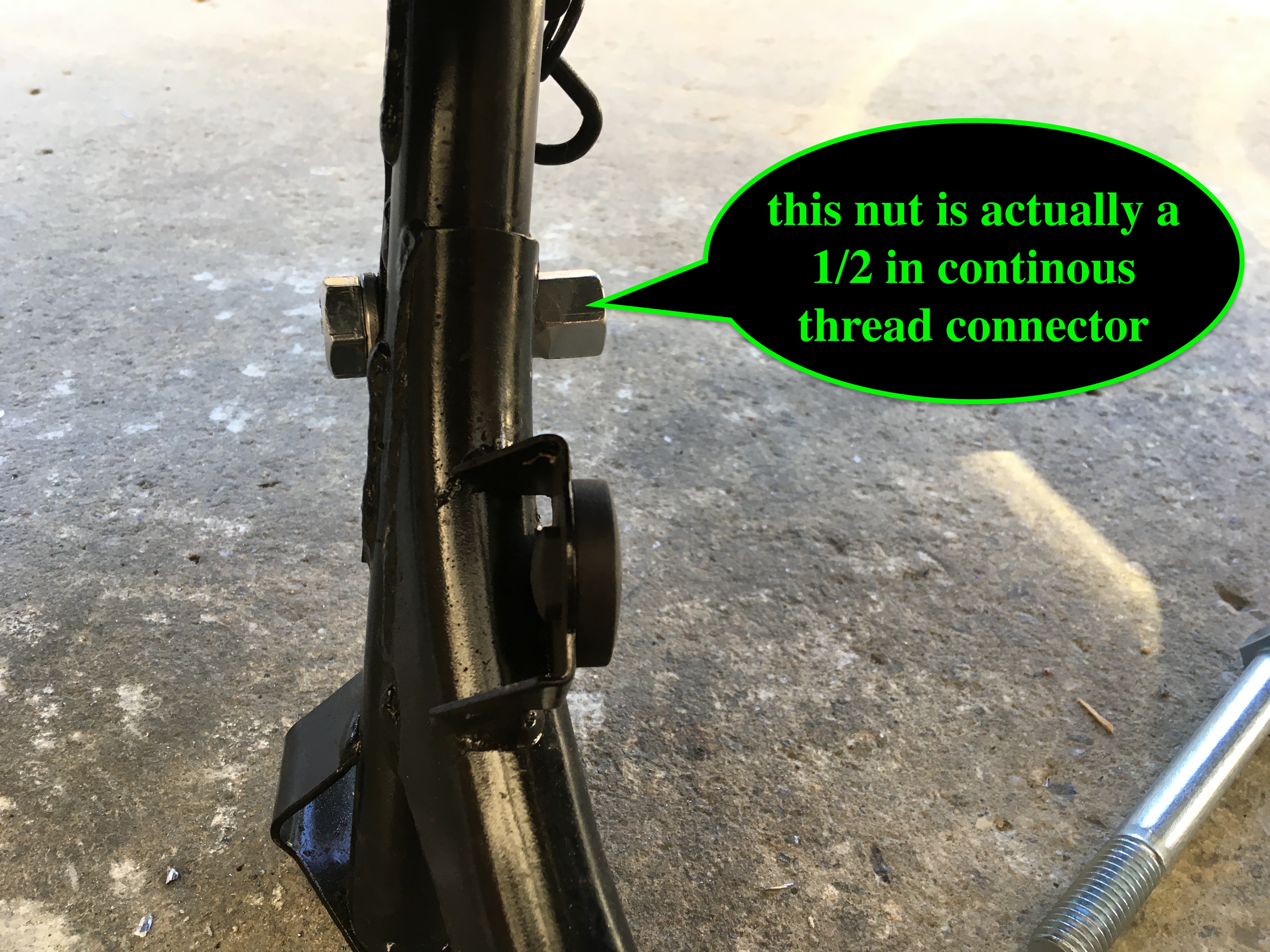

while I was at the muffler shop, I had the guy weld the nut to the center stand ..
[Image: 50190ca13171a822dd58331eb5a32fe8.jpg]
[Image: 8226041a984cfa179b22d98fd9e76a6b.jpg]

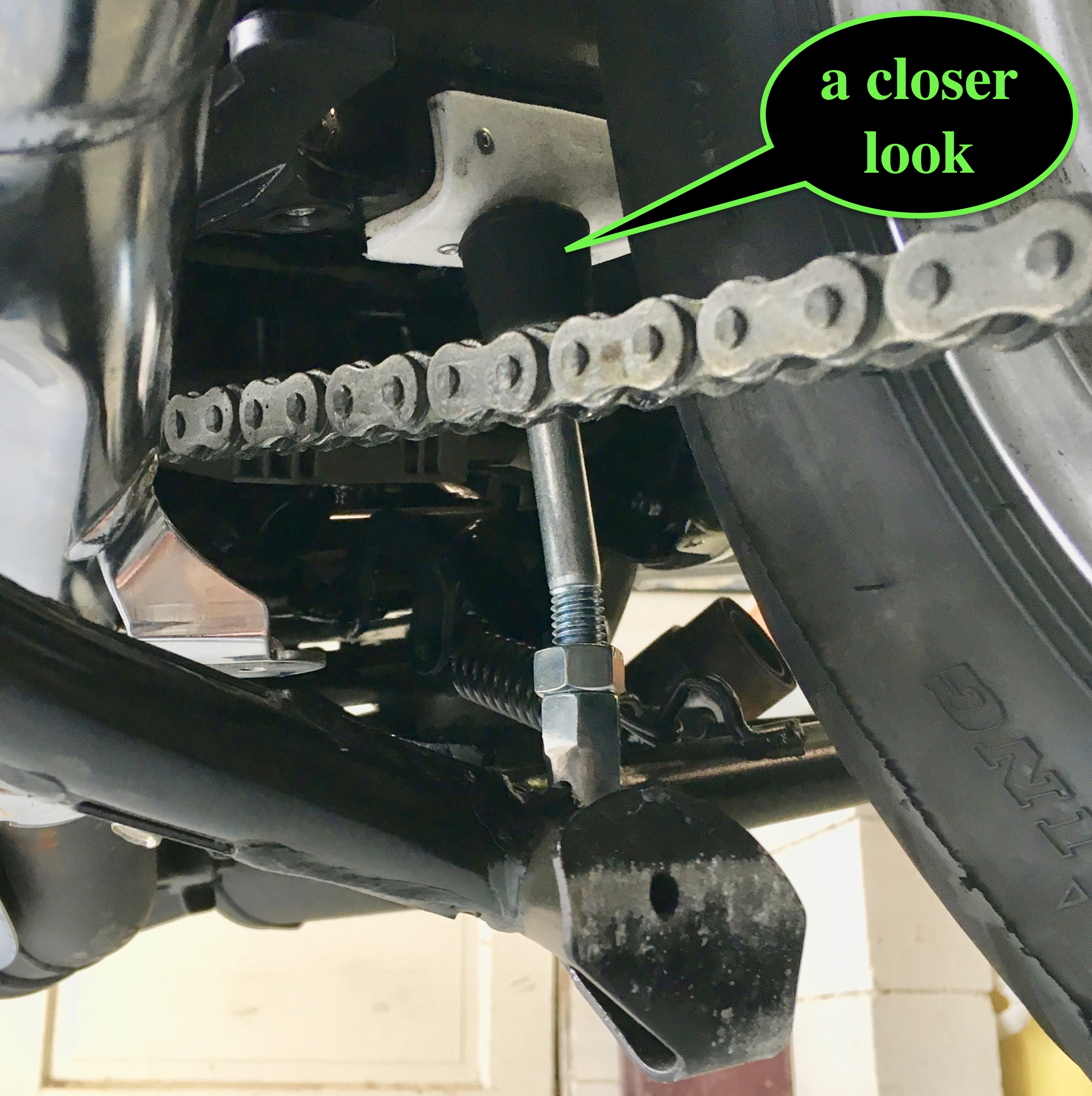

...a teflon pad attached to the swingarm
[Image: 9a93ae415f5c8e36721a6390297e08db.jpg]
[Image: 35866a2a17dc4bcfe2df3fdd3318db4a.jpg]
it was a little noisy so I replaced it with hard rubber.. I removed the magnet after finding out the additional weight caused a problem .. it over taxed the restoring spring..
[Image: 9fbf2d4c5faeb282ef4bdccfe5e2fc99.jpg]
[Image: 59bdd3e11c90dd718da2dcab2c7c3b69.jpg]
took the bike into the muffler shop to have the two short header extensions made to accommodate the emgo shorty reverse mufflers.. I have repacked the shorties already..
