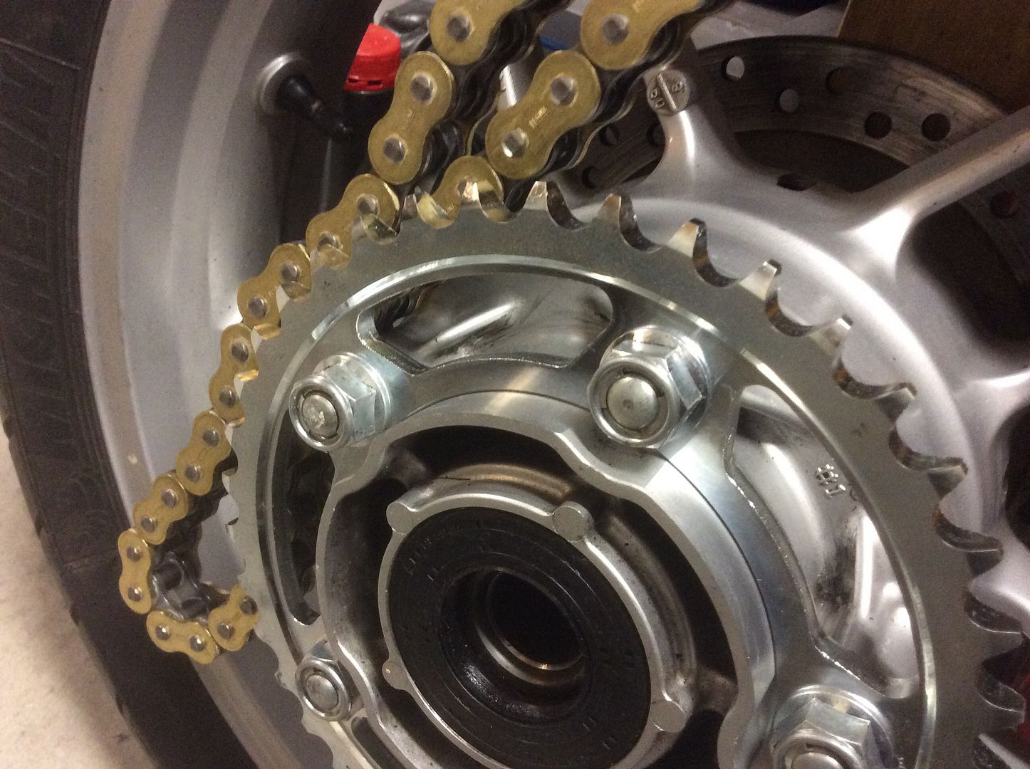

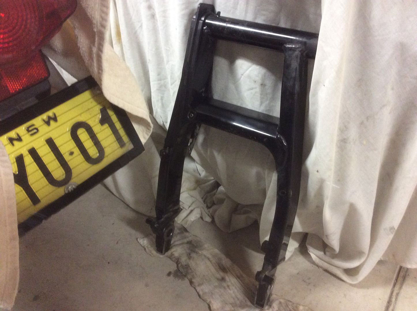

I have decided to go OEM front sprocket (T18), JT rear (T39) and a Regina Z-ring chain. I shortened and staked the chain on the bench and have removed the swingarm for chain installation. All I am now waiting for is the OEM front sprocket to arrive. I am ditching the worn Michelin PR3s and replacing them with Pirelli Angel GTs 110/160.

That new chain looks pretty schmick.
Schmick is good right?
http://www.oxforddictionaries.com/defini...er/schmick
