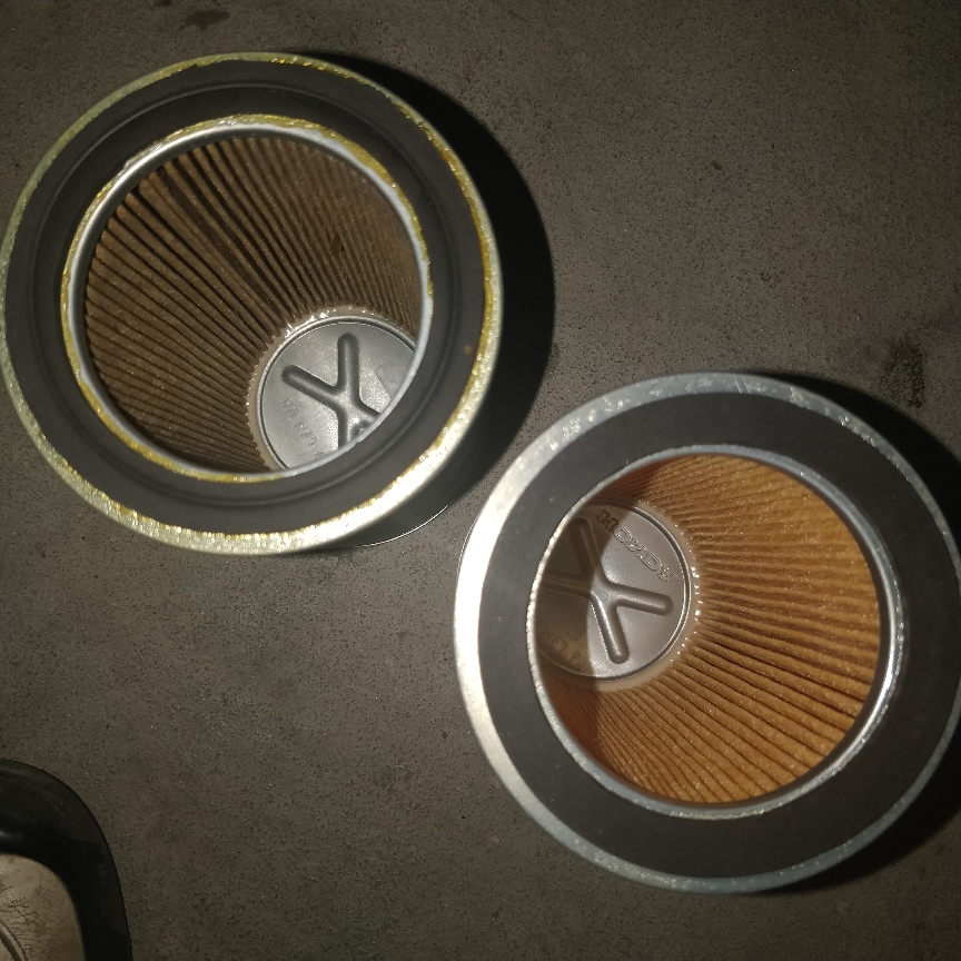

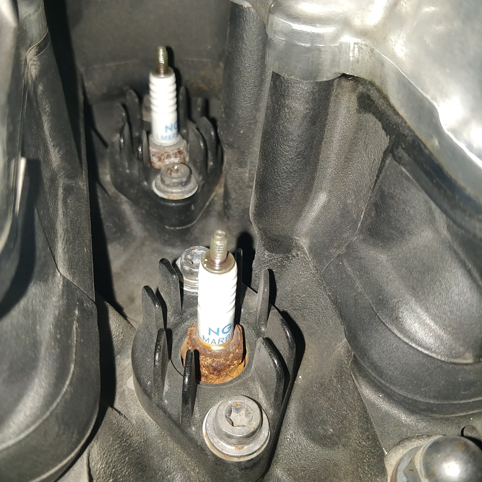

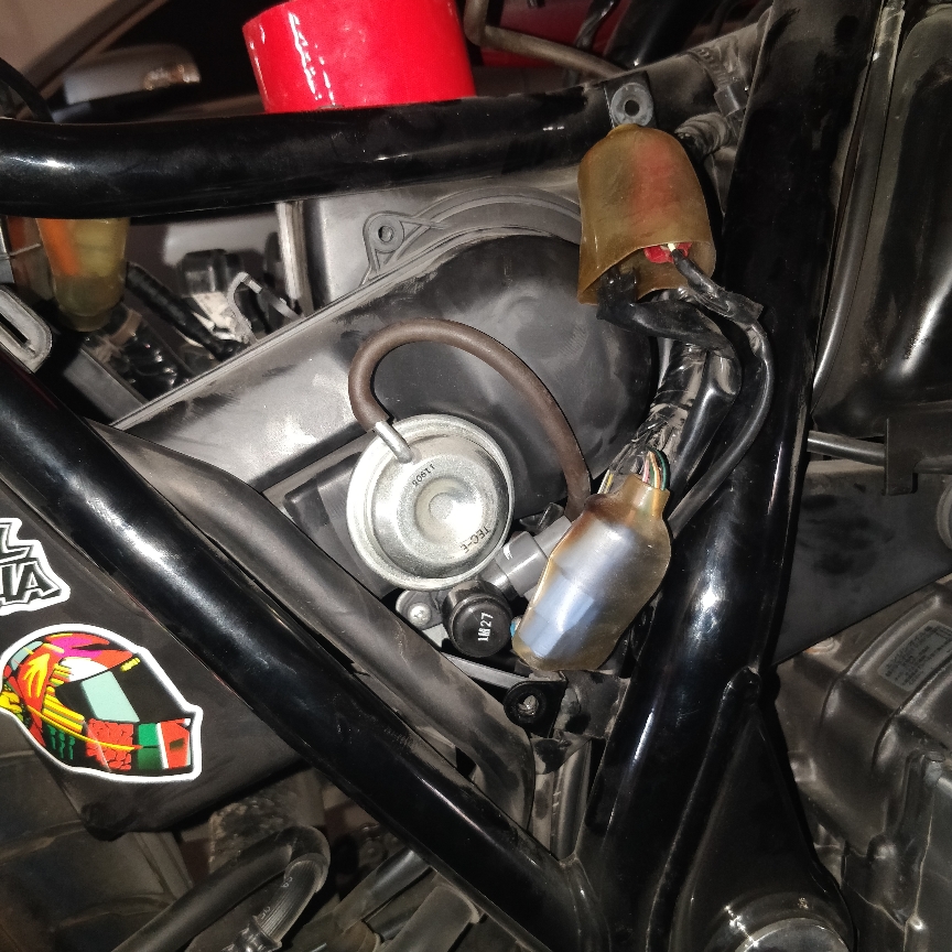

(12-16-2020, 11:09 PM)tod.branko_imp Wrote: Yup, thanks, all done, I removed the tank for sake of it, as it turns out I even had a special tool [Image: 8cf6fe798eb7be7eb00c341ea64a99eb.png]
Anyhow, thank you for the tip, I actually only disconnected the quick connector and turned the tank around counterclockwise on the seat.
Air element was a hassle, stuff that is under my right side cover looks nothing like the workshop manual picture. Off to put in fork gaters. That's for a different thread tho[Image: 7c163879a744afa8b7793b4bfa247f80.jpg][Image: 2f3e37a2cf8d96edd4341f31d1b0110b.jpg][Image: b2c445d66562217bc97184f7c456ebc9.jpg][Image: bd33dd11d2938e441a772541a6cee685.jpg][Image: 191fb6ff4cb31ded45c35766aab8cdf2.jpg]
'14 CB1100 STD 5 speed
@tod
Any chance you could make a little sketch on "turning the tank ... on the seat" ? (thanks for the nice pictures !)
