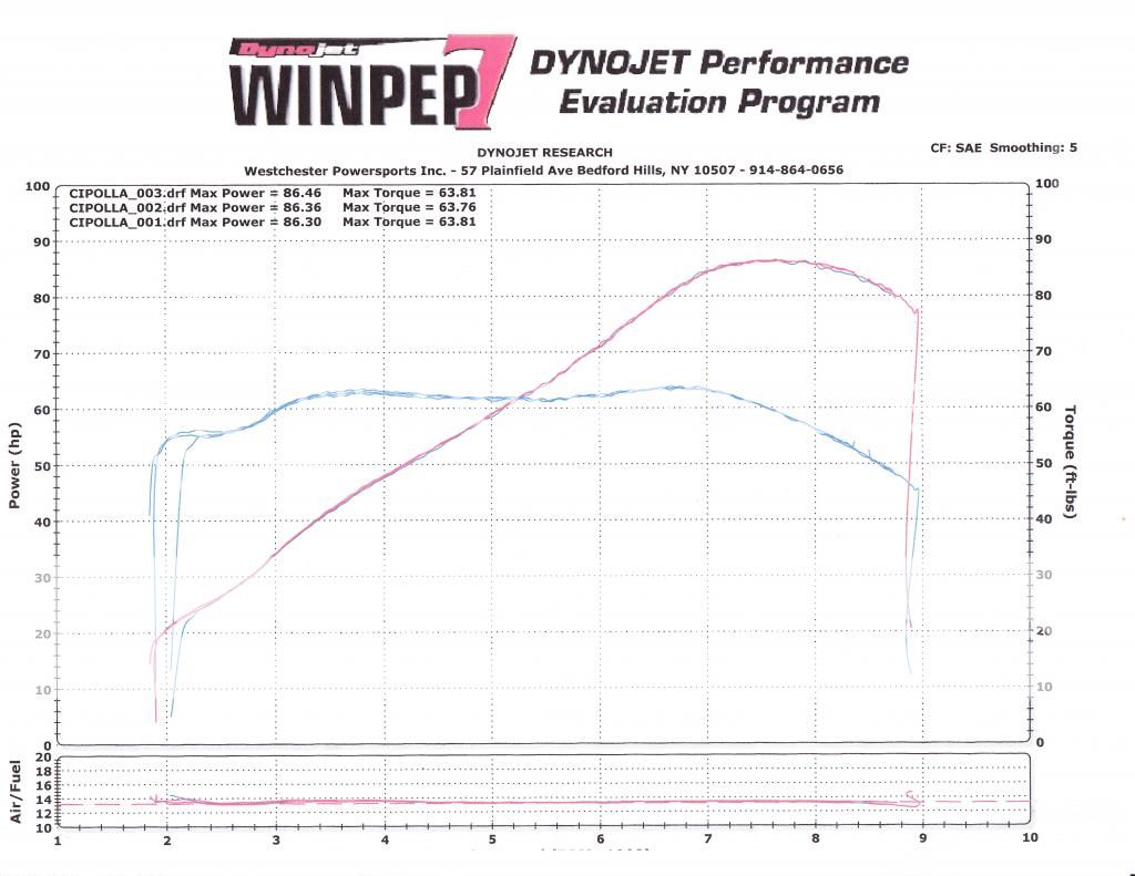

(09-15-2014, 10:18 AM)CIP57_imp Wrote: Grover,
Here is what you can expect with a flash and a stock PC5 map installed into your ECU running a full Yoshi. The A/F ratio is almost spot on, running a bit rich on top. The bike runs much cooler with the added fuel.
I shared this with Don when i had a dyno run done a few months ago, there is more HP to be found. The bike runs so well i just never got around to going down. Hope this is helpful.
[url=http://s1034.photobucket.com/user/cipolla57/media/sc_zps7b3018f4.jpg.html][Image: d4eba8ba2bf07229d05be70691e5b281.jpg]
Thanks CIP!! Smile
