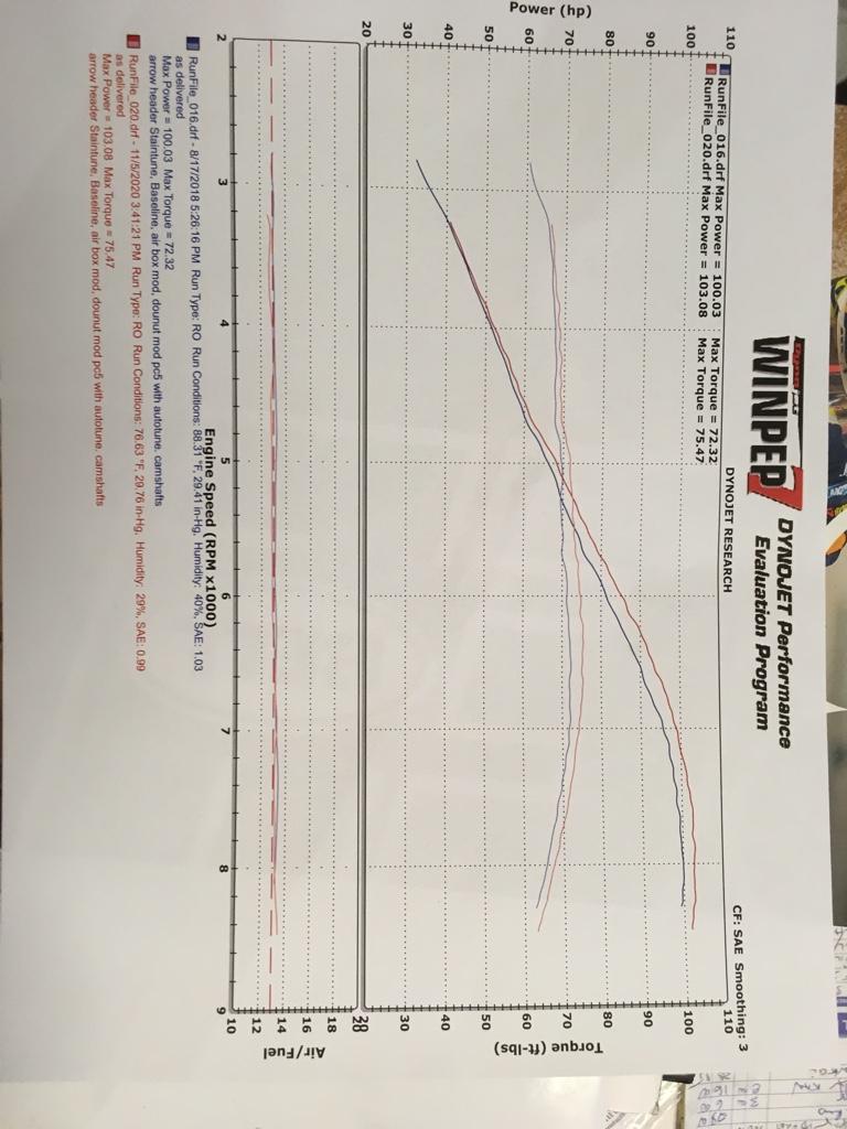

First pic is today compared to last time in 2018 before my accident.
Change is now no longer on the stock ECU- Don Guhl advanced ign timing and raised rev limiter.
I’m still controlling fueling myself with power commander and auto tune.
I also removed the TSR airbox inlet plate (which I did prove on the dyno to make more power than the stock inlet boots).
Instead I put the stock boot back on, but added couple filtered holes - one on boot side and 3 on other airbox side. Reason? The TSR plate made an induction noise I didn’t like.
Reference- http://cb1100forum.com/forum/showthread.php?tid=15762
So here is today’s dyno- modified ign, and removed TSR air holes as shown
[Image: fece8f512f97f793be78bba7c5c1aeb3.jpg]
And here is today’s dyno compared the the first dyno I did on this bike- Inhad already installed the Staintune muffler, so no totally ‘stock’ run- sorry.
[Image: 2471303588e57c1adcd764bb311c09a7.jpg]
I still need to add a little fuel up top.
Funny thing- the WBO2 sensor for the auto tune takes up a good portion of the exhaust pipe. Once I remove it and put in the block off plug- it will flow more air and make more power. [Image: 5ddc6b0910dc2c0820c487a75bbe3061.png][Image: b362068cfa084d0421ba02a9bca0eaf9.png][Image: 930350b562a2c16cddbc15eb155b9d89.png]

Better... much better...
There is no downside to what I have done- as long as you don't consider cost and work as a negative.
Everything I do to the bike has to be an improvement. If it takes something away- I start over.
Example is that TSR plate- gave more power but didn't like the sound- so off it comes, and I found another way.

Eventually I will turn off the autotune and just run the locked map in the power commander like most people do.
Again- the removal of the sensor itself may be beneficial.
I did not retest the TSR plate. It still may help over the box mods...but since I didn't like the sound, there is no point to me.

A gain of 14 hp and 7 lb torque. That's pretty impressive for this motor. In all, what would your estimated cost be to arrive at the gains?

Remember the difference shown is from already having the staintune muffler which gives a pretty good gain by itself.
I’d have to look back as it has been a couple years, but I imagine it probably cost me somewhere between 2500-3k.
I can resell the auto tune box when done with it.

Vice grip- no, my cams still have staggered timing.
Actual #’s put down were a bit higher uncorrected- but SAE is the best way to compare different days, temp, etc.
