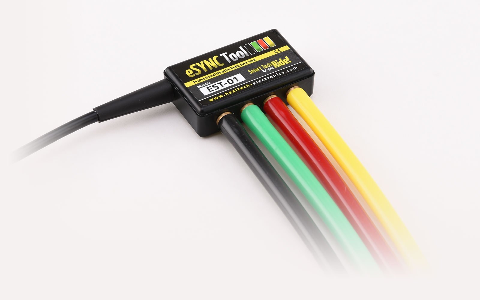

I started watching youtube videos on guys syncing motorcycle TB and found this modern digital version of the old mercury tubes-
https://www.healtech-electronics.com/products/est/

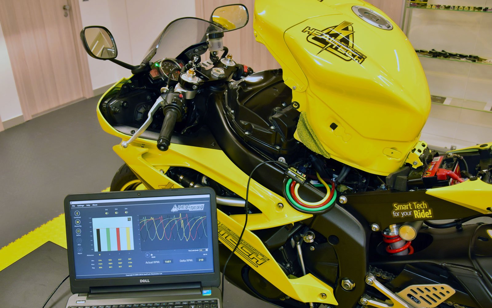

Here is the video of it in use-
https://youtu.be/xxJxG95IuFs

I was particularly interested in this last screenshot. Due to the electronic sensors- this tool allows much more visual data info and much finer adjustment resolution.
There is another video of a guy adjusting with a similar, but older and much more basic (inferior) type of tool- and it is cool that you can tell if the engine has a bad valve by watching the readout.
Given I have installed custom cams, and in doing so I had to completely change my shim sizing much further than normal- it will be interesting to see the waveforms in real time.

So- being the moto geek that I am- I reached out to the manufacturer, let him know I am interested in this tool, and he was kind enough to off me a discount in return for writing up my impressions and results.
I purchased the unit about an hour ago...it will take a while to arrive, and I'll probably play with using it some time this winter as time allows.

JT, there would actually be 4 transducers. One for each hose. The pressures would be converted to digital data sent to the attached computer for display. That's a simplified explanation.
