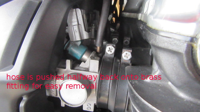

some pictures to clarify
Just to show how easy these outer skinny hoses are to get to i included three pictures.
Only pull off one outer hose on each side as shown in the pictures marked yellow, do not pull off any more, the blue skinny hoses are for the map sensor and need to stay in place.
[Image: 1873caf0e5618e7c1f7e2ebcb6c399c6.jpg]
[Image: 19b1a8857767ca338e32cd20b5d8bbde.jpg]
I have difficulty in expressing which hoses to pull off at which time ,let's just say that you should have two skinny very outer vacuum hoses disconnected at the time of the test as per the picture, not four.
[Image: 04f36d4ad5fdfd42f316f6ba54ac081b.jpg]
The hoses were a little stuck at first so i put them back halfway to make it easy to pull them off.
