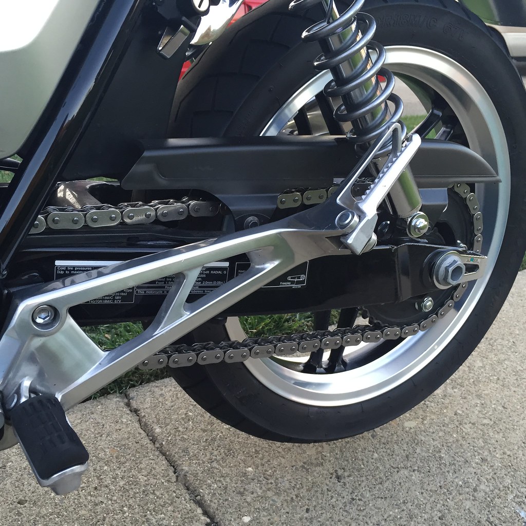

I did my chain at about 26,000 miles. Wasn't particularly stretched, but had a few links that tended to stick a bit. I also replaced both sprockets, but I couldn't detect wear on either. DID chain, but sprockets were steel aftermarket, due to availability more than anything.
[url=https://flic.kr/p/FFaV3y][Image: a53cd7af4811efdf794ea5fa2864f245.jpg][url=https://flic.kr/p/FFaV3y]image by [url=https://www.flickr.com/photos/55838481@N07/]cbiz_wiz, on Flickr

Mate, it's 10,000 kms old now and is buried under such a wad of grease and dirt, I'm doing well to find it and add more oil, let alone read anything.
But thanks for the suggestion. Beer
Rolls. That is one CLEAN bike in your pic. Next time you're rolling through Utah I need you to stop by and detail my CB. BBQ and single malt are on on me.
Mmmm... BBQ and single malt. How'd you know? Smile
(01-07-2017, 02:40 PM)Frulk_imp Wrote: Rolls. That is one CLEAN bike in your pic. Next time you're rolling through Utah I need you to stop by and detail my CB. BBQ and single malt are on on me.
I've seen surgical facilities that aren't that sanitary! Wow that is one clean machine, Rolls!
I love this place. Where else does a thread on chain/sprocket wear and replacement turn into a discussion of BBQ and spirits by post 8?
BTW, I'm not close to replacing the chain/sprocks yet, but my VFR, which probably worked the chain a little harder than the CB, went 28k mi on the oem and was still going strong when I replaced it. Went with DID X-ring and aftermarket sprockets at the sprocket center (sprocketcenter.com). They will kit you out with the whole set up if you dial in your bike specs.
