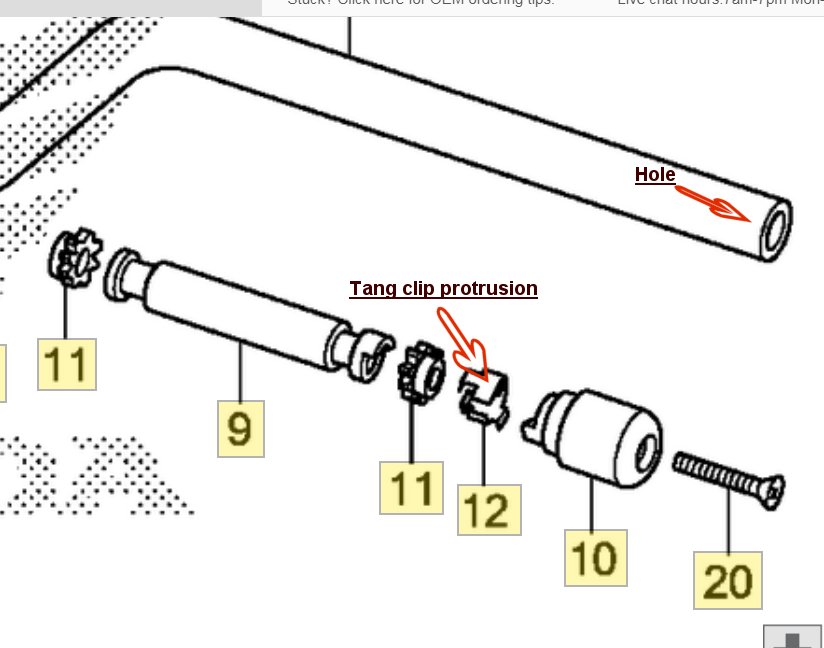

Im in the middle of replacing my handlebar.... what I'm seeing is that this part, #12, has two tangs that lines up into two drilled holes on the end of the bar.
[Image: bcc4cf6c641029c00022f5296b5016c9.jpg]
with the tangs fully seated into the holes, it locks the bar end weight from rotating and from slipping out. Over time, the collar loses tension, and tangs lose its grip, and then rotates out of the holes. Easy fix is to take out #12, bend outward to expand the collar, plus bend the tangs further out, and then reinstall , ensuring the tangs on #12 pops into the small holes on the ends of the bar.

Pushing the tab down through the hole in the handlebar was the way to remove the handlebar weights on my CB500.
Thanks for all your feedback guys. It looks like the two metal tangs hold the inner bar weight in position, which when new, includes preventing movement of the inner weight in both the axial and rotational directions. The outer bar weight interfaces with the inner bar weight by intersecting with notched surfaces. The tangs prevent the inner bar weight from rotating, and the inner weight prevents the outer weight from turning. Over time, the tangs lose their grip on the inner bar weight, which allows both the inner and outer bar weights to rotate. I don't believe the tang actually works its way out of the hole in the handlebar. Does this make sense? Thanks again.

The clip with the tangs are made of spring steel and won't weaken over time. They don't prevent the weights from rotating. Over time, the rubber may deteriorate which allows a slightly weaker grip by the clip.
The rubbers also deteriorate when they are removed, or if chemicals like WD40 are sprayed into the bar. I find they sometimes stick in the bars and need to be replaced when pulled out. I use a little silicone spray when I push them in.
