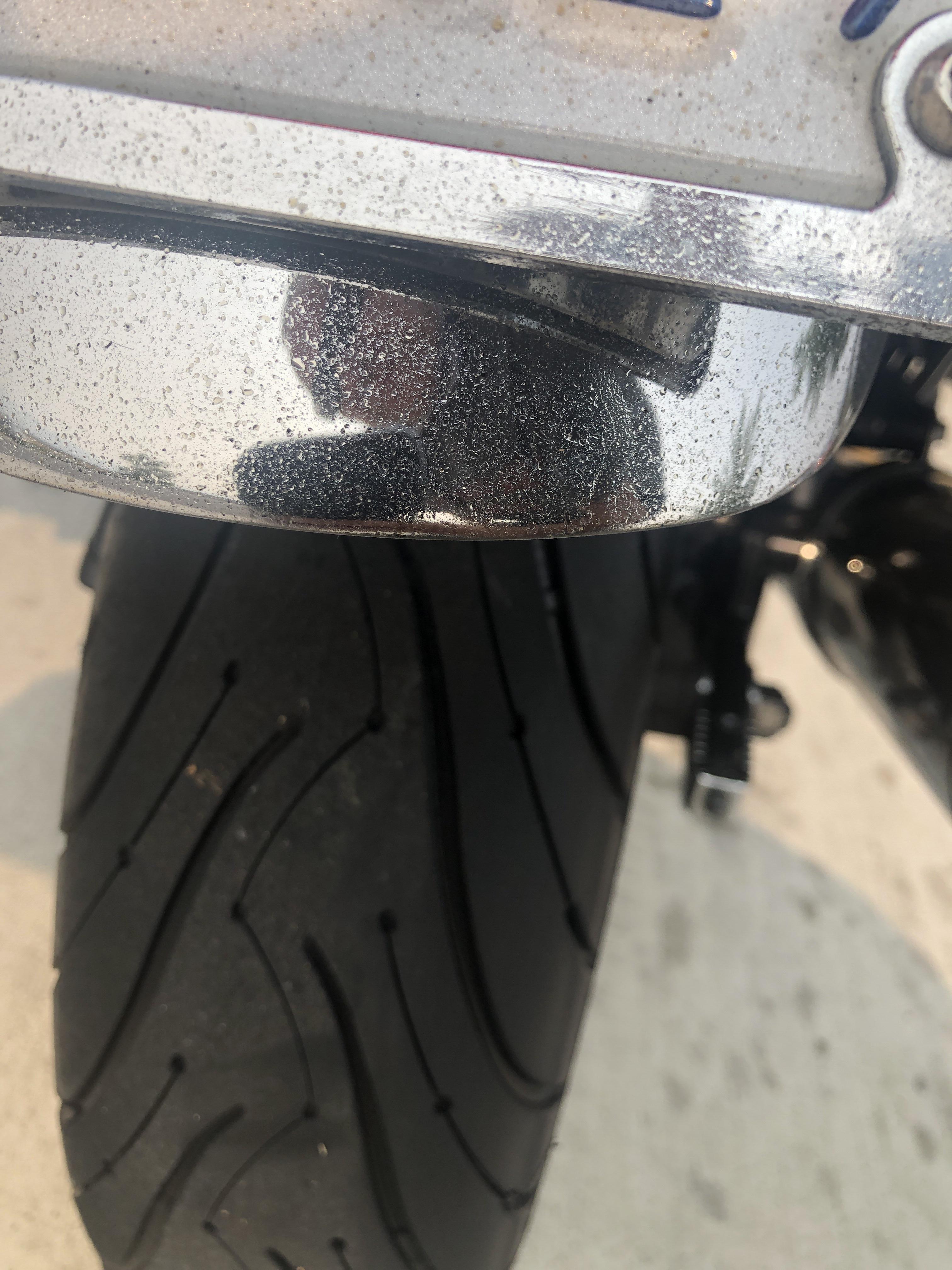

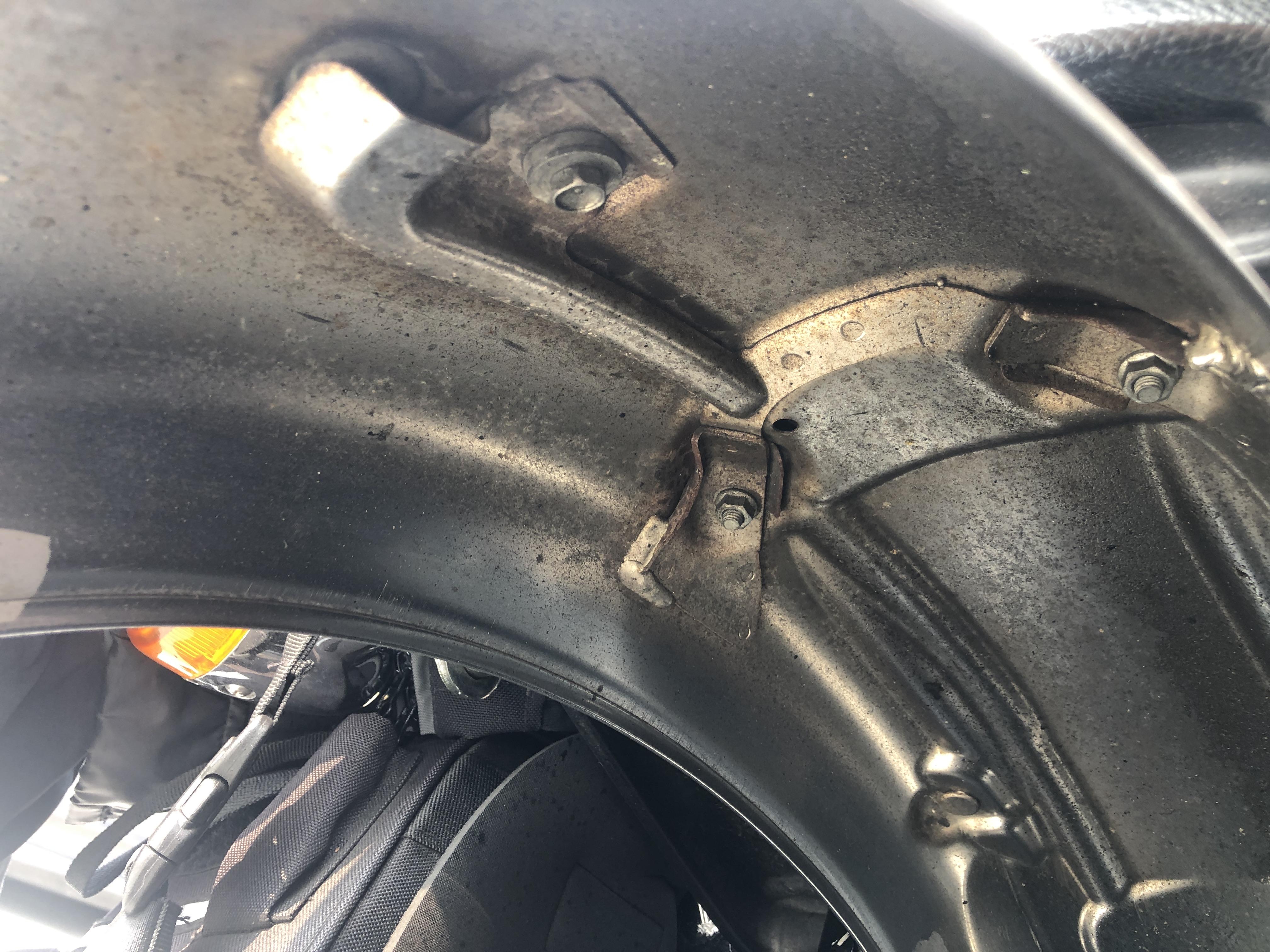

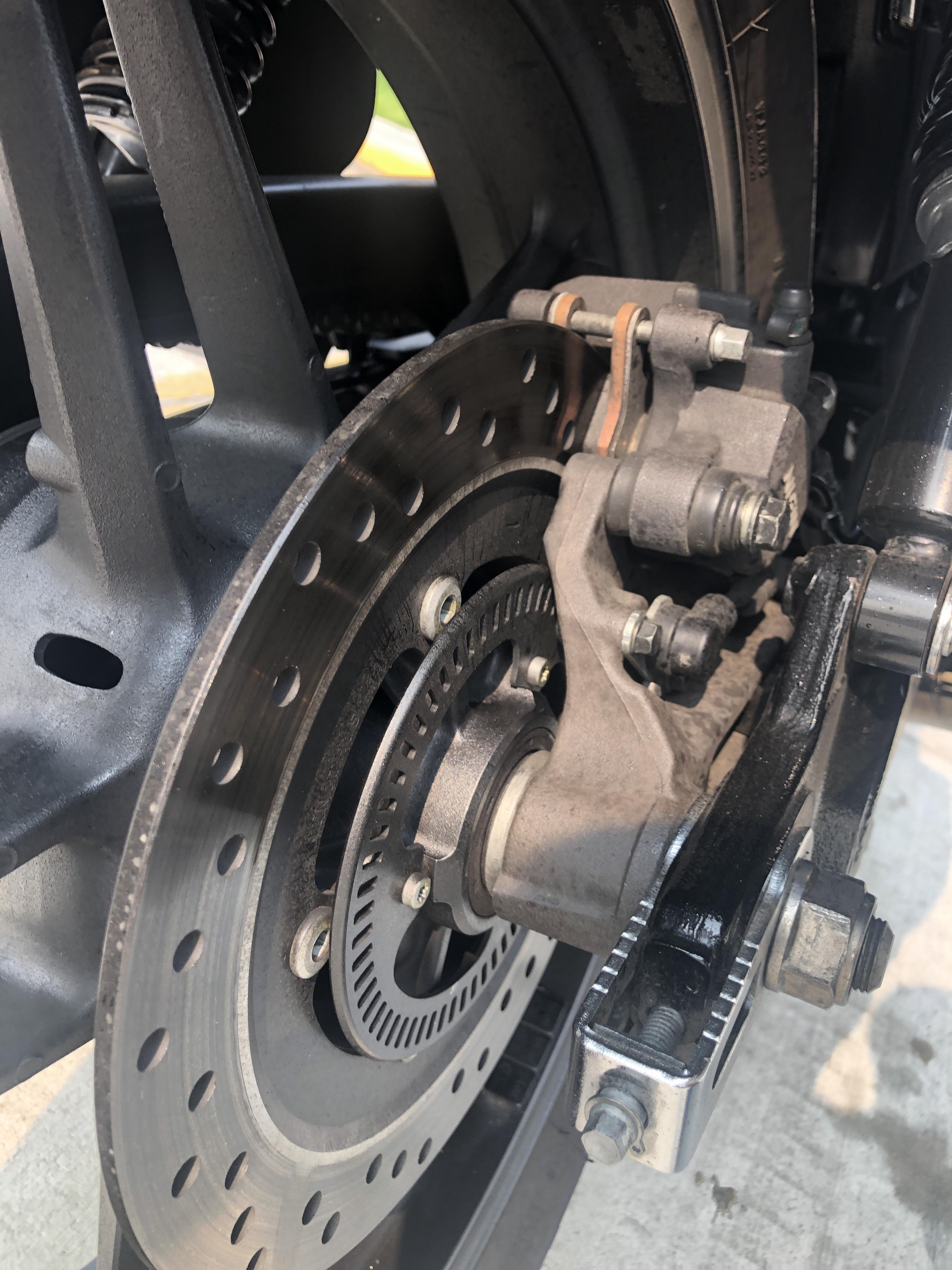

Well I have heard the nightmare stories about bad oil filters. Yesterday I had my filter fail . I was on a 300 mile ride I had smelled oil a few times looked at the upper end and keep going. The weld on the nut of the hiflow filter had broken and started leaking I i had over 500 miles on it already never used it for tightening... well only oem from here.[Image: 299daad0912216b8d21cf4fa4be8916f.jpg]

I forgot to add I was riding with my Dad he was on the VFR 1200. Glad I didn’t go down with a oil slick on my tire.... and we are on vacation my wife brought my truck I was 30 miles out when I had figured it out... the rear brake wasn’t working well. And the last leg was all twisties!!
