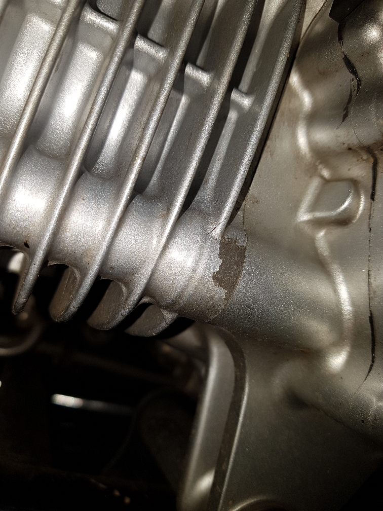

What kind of paint should I use to recoat this area ? Any particular method ? Or precaution ?[Image: ee2c8c5808b814607fcee48c559f740b.jpg]

Yours looks to be the lighter engine colour which might just be lacquer based on the looks around this forum

Interesting that the exposed material is brown in colour.
Nevertheless, isn't the cylinder head cast aluminum? If you take a small metal file, can you remove the brown material to expose new aluminum? I realize new aluminum will oxidize immediately when exposed to air, however, it should settle down to a grey or whitish-grey finish - which should stop oxidizing. I do not know if further reactions occurs due to exposure to a salt-water environment. Is that the reason it is called "rot"?
In terms of high heat paint, silver-grey spray can high-heat paint has been readily available for decades with some tolerating the 1400F temperature range. That should be more than enough margin.
I use high heat paint to restore the engine painting of my 2013 CB. But it doesn't solve the problem of a bad primer Honda used with this model. My attempt to better the former good but after a while vanishing because oxidated ugly outlook of the engine is not lasting. I have to redo it over and over again once it looks bad again. It is a shame that Honda wasn't able to do a better work with the finish.
