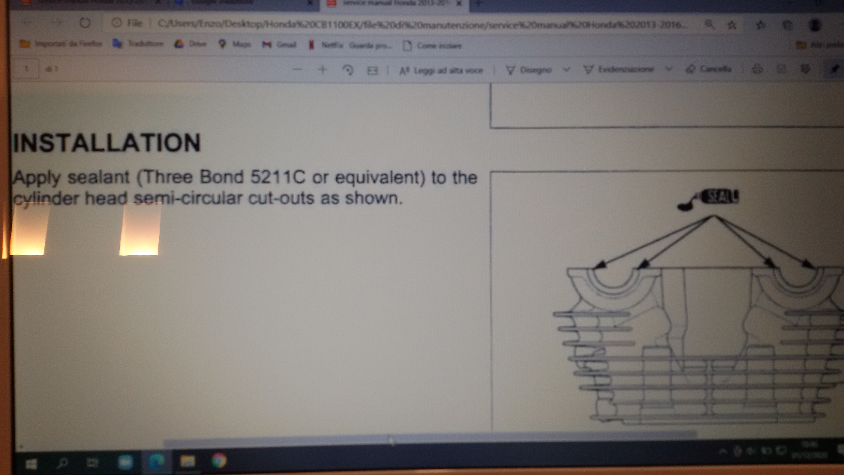

but then did you manage to remove it?
should be put only there? or are there other recommended points?
[Image: c06bd4256eb0b00355b517be3e326176.jpg]
Those are the only points I've ever put liquid gasket on. Have not experienced any leaks.
I find it easiest to install the valve cover, then gently lift it (one side at a time) and put a little bit of the liquid gasket in each location, but on the mating gasket surface, not the head.
(12-01-2020, 03:18 AM)Enzofour_imp Wrote: but then did you manage to remove it?
Its weird that 5211c (c is clear) is called for as ThreeBond says that 5211 is a caulking for concrete, doors, etc. Seems like something else would be better.

Do you recommend putting it where indicated or should it be placed in other points of the head for greater sealing?
It only needs it where shown. You should replace the gasket though.
