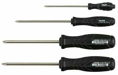

Amazon has a decent set for $40: http://www.amazon.com/Hozan-JIS-5-JIS-Sc...003F63WI8/
Size 00, 0, 1, and 2, as well as an extra long 2 (good for removing the screws that hold my seat down on the CBR).

Here is another good set from amazon. Personally the yard stick one I will pass on. Okay maybe not yard sick size but that one was pretty long.
This set is $27.10!
http://www.amazon.com/gp/aw/d/B00A7WAHTU...L500_SS115
[Image: 4512b0abde044fcbc81e4d3d58170e37.jpg]
