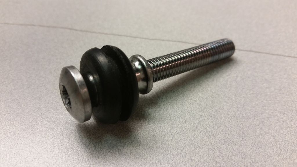

[url=http://s1216.photobucket.com/user/metalmaven/media/Mobile%20Uploads/2015-05/20150521_120734.jpg.html][Image: 002296d74839ef72e03bbf0bd58fed8d.jpg]
Well I mounted my bracket last night on the bike and clamped some upright square tubing that will mount the backrest pad. I noticed with the new found leverage that when pushing backwards on the pad that my rubber grommets I was planning on using actually really suck because they give too much. They need to be more rigid.
I cannot find any good plastic or rubber bushings to make this work, so I ordered some nylon rod and will be I machining some custom made bushings for the project. We will see how that goes.. Also, I am giving that same new design to my buddy who will 3D print me a set. We will see how that looks too. This backrest is a lot of work!
05-21-2015, 03:27 AM
