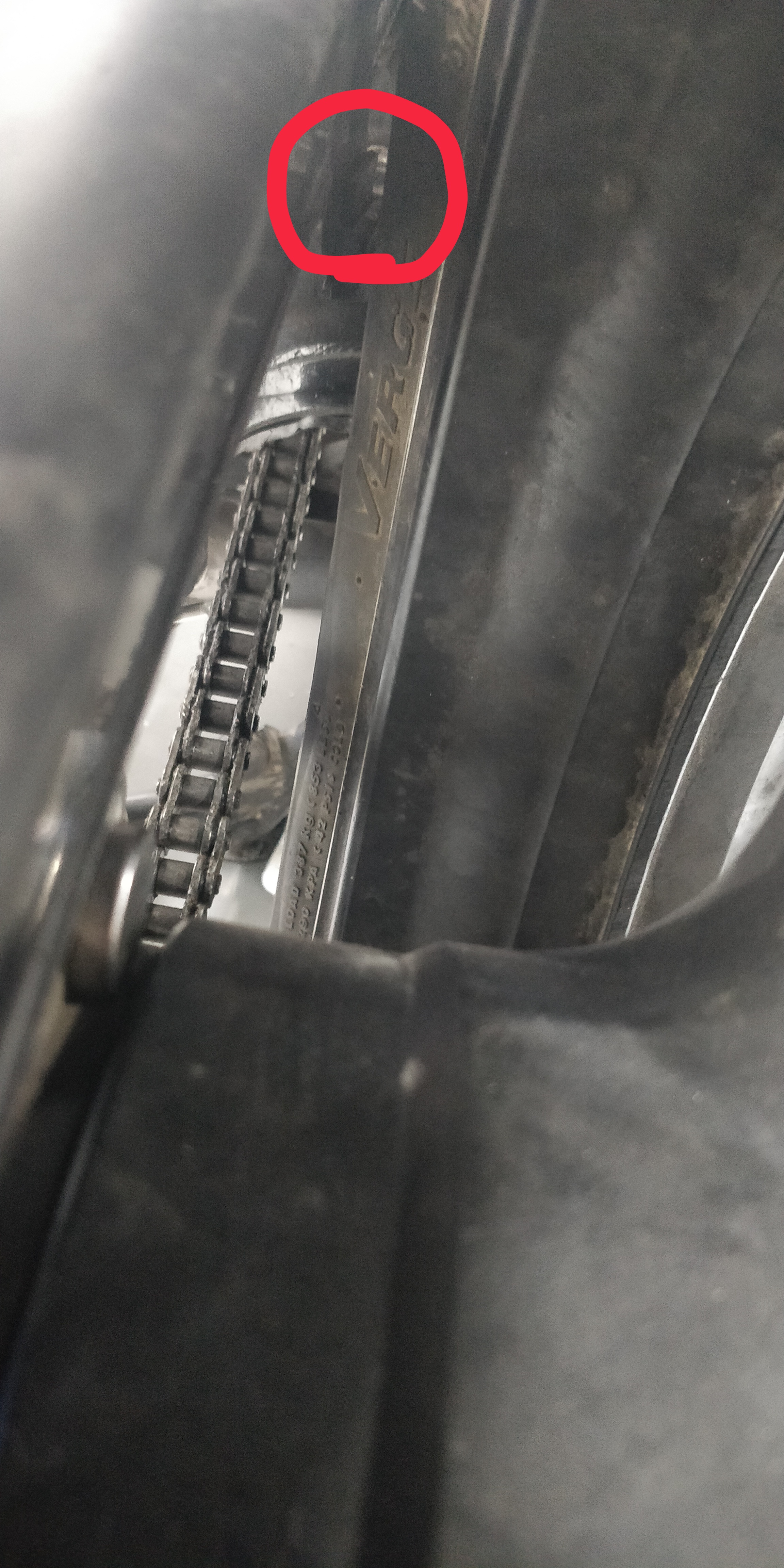

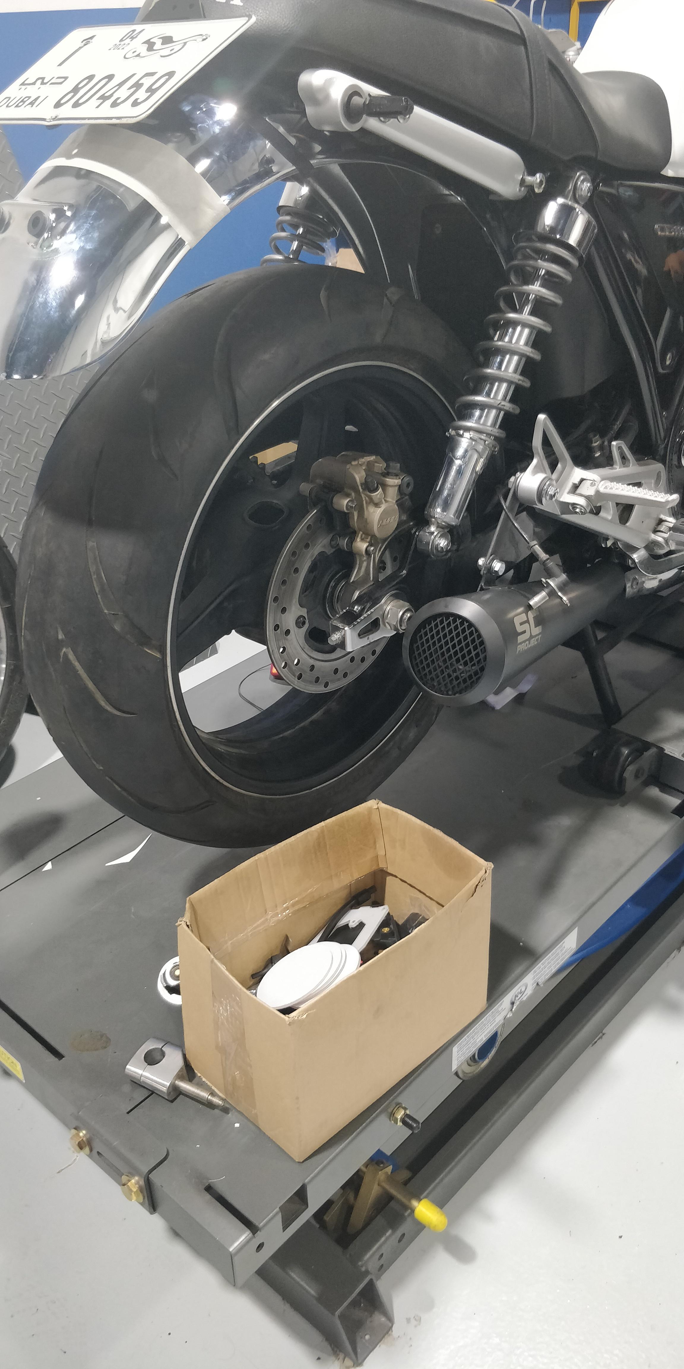

As promised, I caught the bike in the shop and as I suspected, the 17" wheel fits in the original swingarm, bearing had to be changed and spacer modified, it clears the notch on the chain guard by 3mm literally. The speed sensor is lost though and they are still figuring out what to do about it, most likely he will change the whole instrument cluster and put everything aftermarket. Hope this gives you some insight[Image: ebf93d6e0c11a10ffa58720829e8e913.jpg][Image: bae0eb44eae7c8474da19dbb28a5bf8b.jpg]

(09-01-2021, 03:12 AM)tod.branko_imp Wrote: As promised, I caught the bike in the shop and as I suspected, the 17" wheel fits in the original swingarm, bearing had to be changed and spacer modified, it clears the notch on the chain guard by 3mm literally. The speed sensor is lost though and they are still figuring out what to do about it, most likely he will change the whole instrument cluster and put everything aftermarket. Hope this gives you some insight[Image: ebf93d6e0c11a10ffa58720829e8e913.jpg][Image: bae0eb44eae7c8474da19dbb28a5bf8b.jpg]
'14 CB1100 STD 5 speed
very helpful, thank you!

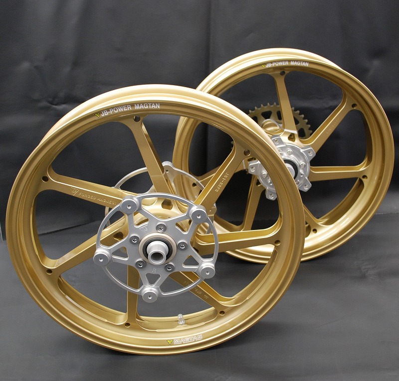

If you want to save weight on wheels, Samurider has these mag wheels which not only look great and are made for the bike, but they do save about 10 lbs of unsprung weight. I think that might be quite significant, and something I have considered for a while. It is the price that has kept me from doing the change...
[Image: 3376ef5d5f80ef49cc9bec7f0819dd83.jpg]
They come in gold, black or silver as well: https://www.samurider.com/?p=26675
Still, JPY 380'000 is like $3'500!!

You are correct Henrik, very nice & ready to install wheels...... not the price tho U$3,500

I think the issue there is theyre still 18" wheels. The stated purpose of all this was to get 17s.
That said, he'll probably spend almost the same amount of money changing to 17s as he would buying those magtans.
