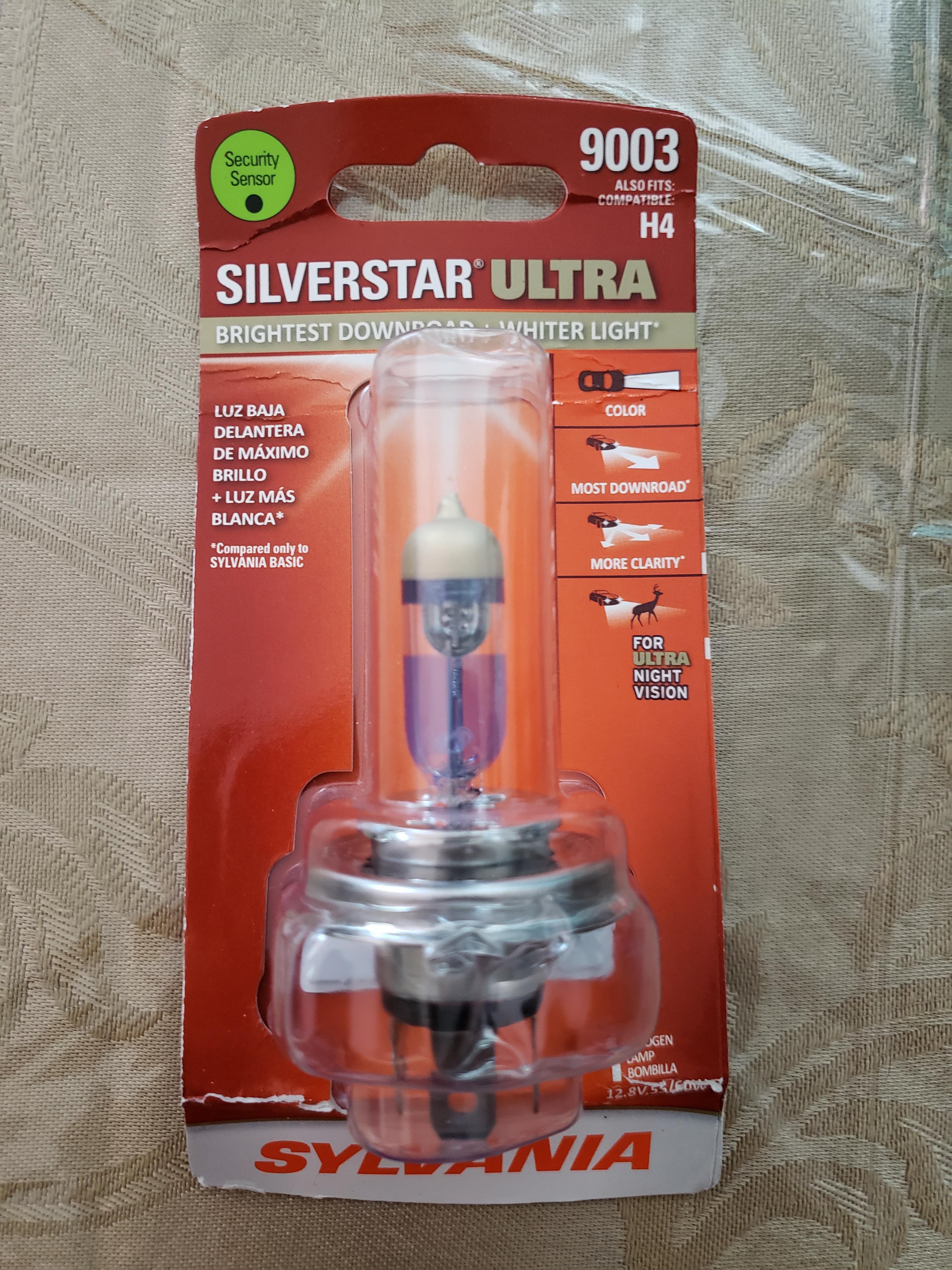

Thomas I actually heard back from Annette this week! She will ship me just the side brackets so I can push my headlight a little more forward. I
I jusy grabbed a Sylvania Silverstar Ultra bulb from Walmart for 24$.

Sent from my SM-G965U1 using Tapatalk For anyone looking for the bulb[Image: a424c06d8325f374bbe76dc86f69d246.jpg]
