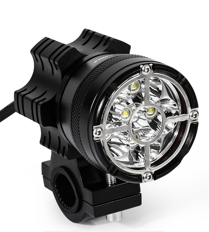

Since the 2017 and later CB's are equipped with LED headlights, lots of owners complained of poor illumination and worst the electrical wiring diagram does not properly explain its operation, so after some research I decided to install a pair of "Motowolf" auxiliary spot lights.
Each light is rated at 7,800 lumens (@ 6,500 kelvins - white lights) and projects to a maximum of 300 meters while consuming only 45 watts (9 LED's), the pair is sold for around $60.00 USD from their US depot.
After the installation & aiming, I tested on roads with no street lights and to say the least, I very happy with the result.
Note: Better result can be obtained if the spotlights were located farther apart from each other.
Pictures are taken under different conditions; Low beam, High beam and the spotlights.

Spotlight
[Image: 044a0d36e5860c880e6aa5c158a63e95.png]

Do you have a write up for how you wired up the lights and switch? I've been wanting to add 2 fog/spot lights to my 2014 for awhile now
08-11-2020, 04:25 AM
mvk24_imp Offline
Posts: 826
Threads: 18
Likes Received: 2 in 1 posts
Joined: Apr 2018
16,000 Lumens Spot Lights to complement 2017 Led headlights
Also did you use a relay and fuse or did you just hardwire it to the switch?

(08-11-2020, 05:42 AM)mvk24_imp Wrote: Also did you use a relay and fuse or did you just hardwire it to the switch?
Yes, will require separate fuse.
All power wires are available in the headlight bucket.
Hope it help
Regards
Alain Lee
(08-09-2020, 09:35 PM)Lord Popgun_imp Wrote: Alain,
I have to ask about the hardware mounting your front camera to the mount. Mine did not come with a long screw and nut. Mine has a shorter screw that threads into one side of the camera clamp. Did yours come with that long screw?
Let me know of where you hide the extra long "Manual switch & GPS" wires.
I did hide mine behind the headlight bucket, but still looks ugly.
For the front camera, I riveted the lens base to the headlight bucket and
for the rear, I riveted it on the tail light lens cover.
Also, for the GPS "Time" setting, I selected the -4 hours for Toronto.
(08-11-2020, 04:25 AM)mvk24_imp Wrote: Do you have a write up for how you wired up the lights and switch? I've been wanting to add 2 fog/spot lights to my 2014 for awhile now
Hi MVK,
Since I installed quite a few accessories on the CB and I did not want to tamper with the factory wirings, I made an external "auxiliary" waterproof electrical box located between the rear shock and the air filter cover.
All my accessories (relays & fuses) goes through it.

You already have the connector available there in the headlight bucket for that exact purpose. Other members bought the female connector to fit that "option" connector (there is a tread somewhere in this forum). This is is the supply power to your spot lights.
The headlight wire is required to power the switch side of the relay. - You do not want to leave the spot light "ON" by mistake and also to be legal with the law. - No spot light when on high beam.
This switch is also available without the M10 port.
Switch mounted to "Clutch Reservoir" clamp. (neat)
