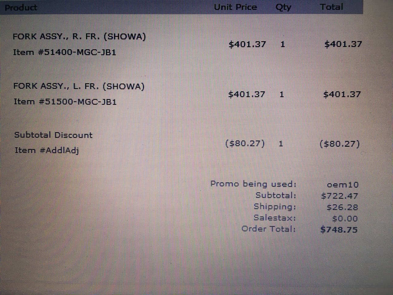

[Image: dee16ababfbe72ff51ddd177d10d1275.jpg]
If you use the Babbits phone app and that code you get 10% off.
(03-05-2018, 12:40 PM)PowerDubs_imp Wrote: [Image: dee16ababfbe72ff51ddd177d10d1275.jpg]
ROFL You lost me at "phone app", I am somewhat of a luddite - I have a 10yr old flip phone that you can call in or call out. That's it. And I share it with my wife.
But all is not lost, I found Babbitts website and I'm going to order the '17 forks tomorrow.
Thanks Powerdubs!

I did it - I ordered the '17 front shock assemblies, a little more (ok, a lot) more than I wanted to spend though. The discount code wouldn't work, I think it may be for the US only.
Discount code only works if you use the mobile app on the phone or tablet such as an iPad.
I ordered from a tablet, not an IPad though. Every time I punched in the code the country selector would automatically switch to the US and give no other choices.
