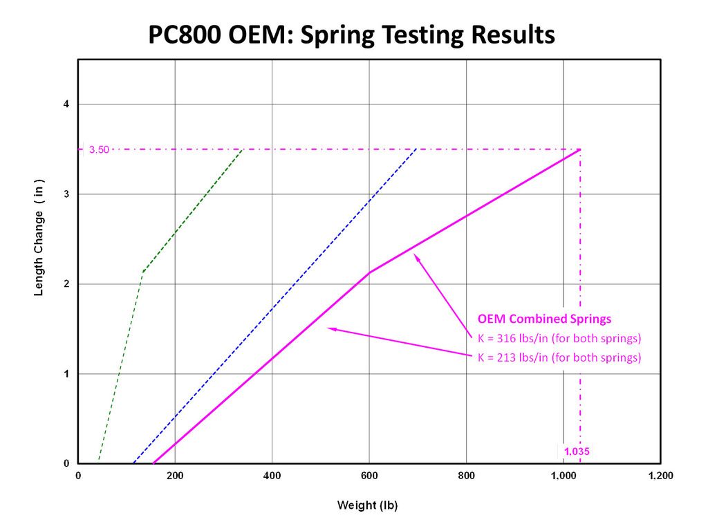

Pic 1: Here I have the PC800 nonadjustable shock in one of my gym equipment so I can load up weights and measure how much the shock (spring really) compresses. I keep adding weights until the shock bottoms out.
[url=http://s93.photobucket.com/user/spacetiger81/media/CB1100/1.%20%202%20%20spring%20analysis_zpscjdu35qe.jpg.html]![[Image: 4d608831633e36bf20565672352f69c6.jpg]](https://cb1100forum.net/forum/uploads/imp/201601/4d608831633e36bf20565672352f69c6.jpg)
Pic 2: Here I test out the adjustable shock (the test has no additional preload dialed in.
[url=http://s93.photobucket.com/user/spacetiger81/media/CB1100/1.%20%203%20%20spring%20analysis_zps4zstrc2b.jpg.html]![[Image: 98e345a3336084424c8e36c5c588b3c2.jpg]](https://cb1100forum.net/forum/uploads/imp/201601/98e345a3336084424c8e36c5c588b3c2.jpg)
Pic 3: Based on the collected data, I can plot and determine the spring rates of each spring (I use Excel to plot and determine the curve fit). You can see Honda matches the spring rates, so the transition point of the nonadjustable spring aligns with the initial preload setting on the adjustable shock.
[url=http://s93.photobucket.com/user/spacetiger81/media/CB1100/1.%20%204%20%20spring%20analysis_zpsvfzczewb.jpg.html]![[Image: ef4966e4f3c4c0f53494de51e565c165.jpg]](https://cb1100forum.net/forum/uploads/imp/201601/ef4966e4f3c4c0f53494de51e565c165.jpg)

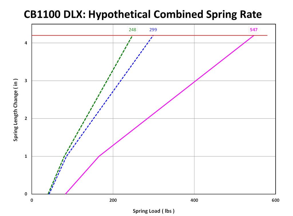

Pic 4: The 2 springs work together to act as a single spring as depicted by the magenta line.
[url=http://s93.photobucket.com/user/spacetiger81/media/CB1100/1.%20%205%20%20spring%20analysis_zps6xsl6der.jpg.html]![[Image: dc9620dc91840e3048bda188c33b6303.jpg]](https://cb1100forum.net/forum/uploads/imp/201601/dc9620dc91840e3048bda188c33b6303.jpg)

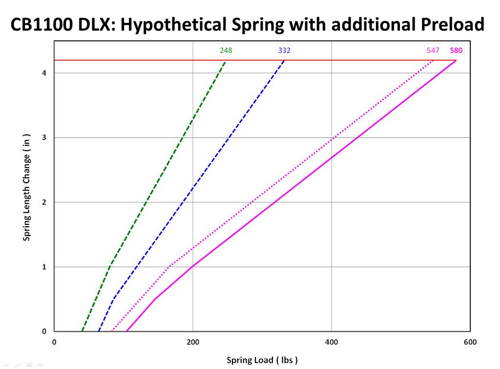

Pic 8: Honda always sets the springs for the USA market too soft for our weights, so it is more likely you will need to add additional preload (you will make that long spacer, spacer B, longer). Adding an additional 0.5” will shift spring B curve down 0.5” as shown by the downward red arrow. The transition point is now at 0.5” (versus 1.0”) and adds 33 lbs of capacity at the top end.
[url=http://s93.photobucket.com/user/spacetiger81/media/CB1100/1.%20%208%20%20spring%20analysis_zpsimyjzdlw.jpg.html]![[Image: 84525eeae12cdbea8280bfa4ecdd2652.jpg]](https://cb1100forum.net/forum/uploads/imp/201601/84525eeae12cdbea8280bfa4ecdd2652.jpg)
Pic 9: The gains made by adding more preload to spring B translate to the new combined spring shown as the change in magenta lines.
[url=http://s93.photobucket.com/user/spacetiger81/media/CB1100/1.%20%209%20%20spring%20analysis_zps6zqxia3t.jpg.html]![[Image: 242389ed9a8d5d0d39c6de473e9b13cb.jpg]](https://cb1100forum.net/forum/uploads/imp/201601/242389ed9a8d5d0d39c6de473e9b13cb.jpg)

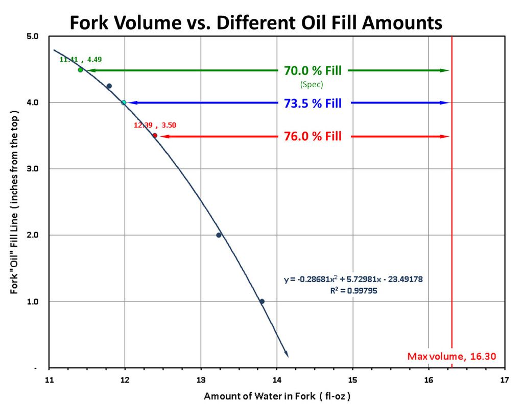

I’ll write about the effect of the air spring if there is interest, but take my word, the oil level is critical in suspension performance. The reference post cites there are 2 different oil levels for the CB1100EX; that is, each fork has a different oil level. When you look at spring A, you can see it is the longer spring. This means the spring takes up more volume in the fork, so that side has a lower oil level. The side with the shorter spring (spring B) takes up less volume, so it will have the higher fill volume. You can see if you put a longer spacer made of PVC in to increase the preload, you would have to reduce the oil fill by the extra volume of the PVC spacer. You would not have to do this with copper pipe. If you mix up the oil levels between the forks or have too much oil (because you used PVC pipe) in the B side, then the fork will not compress very much (worse case) to not all the way (best worse case).
