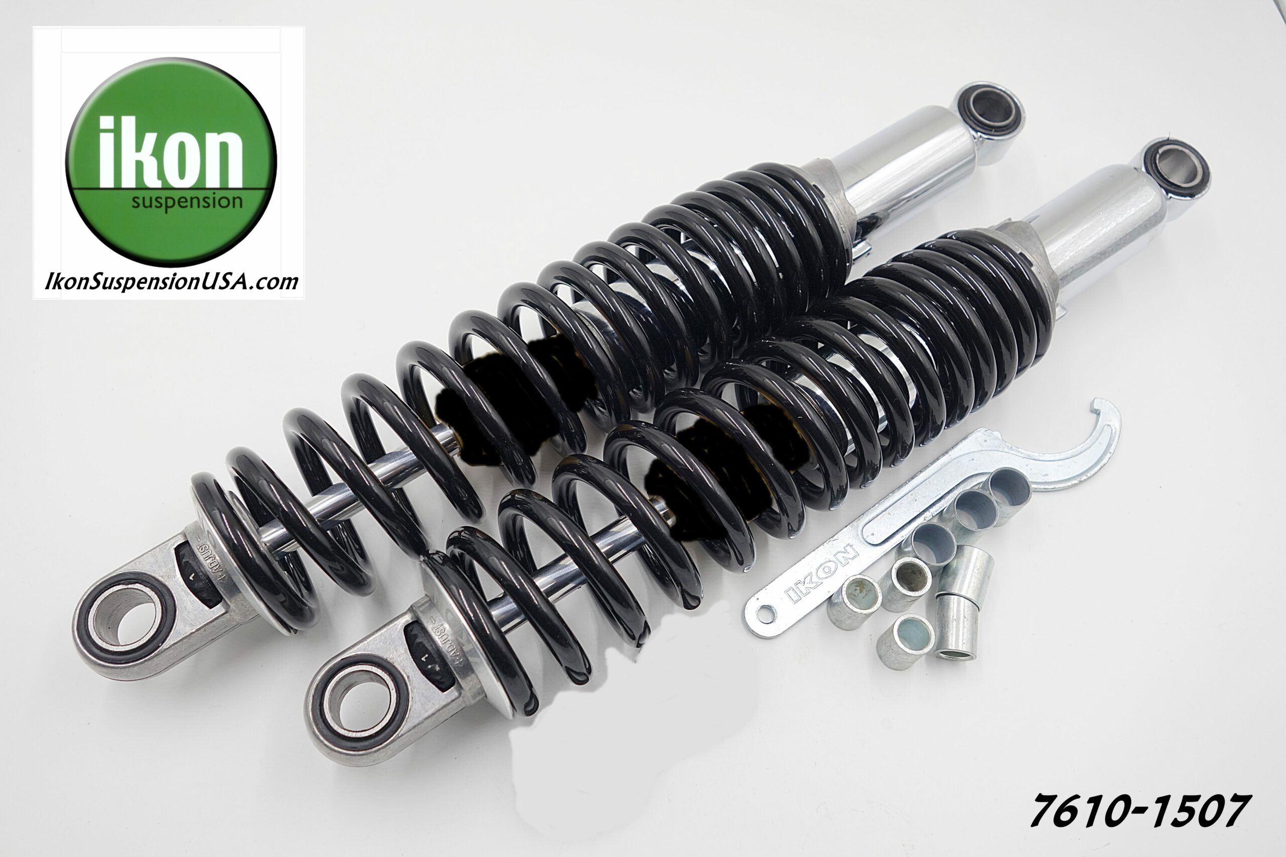

https://www.ikonsuspensionusa.com/shop/7610-1507/
I'm not 100% decided on the rear, both look like good options. Of course the cheaper Icons are more appealing but I don't mind spending a little extra for better shocks. Ohlin's are a bit too much though.

The stock rear suspension wasn't too bad for me as I very rarely carry a pillion. You already have a lot of information on rear shocks and I would has at a guess that any reputable aftermarket suspension that includes rebound damping with the mandatory spring preload adjustability would be better than the stock units. Good news is that the rears are a 15 minute job to fit. Be careful not to over tighten the mounting bolts as they are light duty and only there to stop the unit from sliding off its mount.

I *thought* I didn't have a problem with the rear shocks until I put on the 17 forks...then I noticed the rear on hard bumps more so. So I put Ikons on the rear. Also better than stock.
