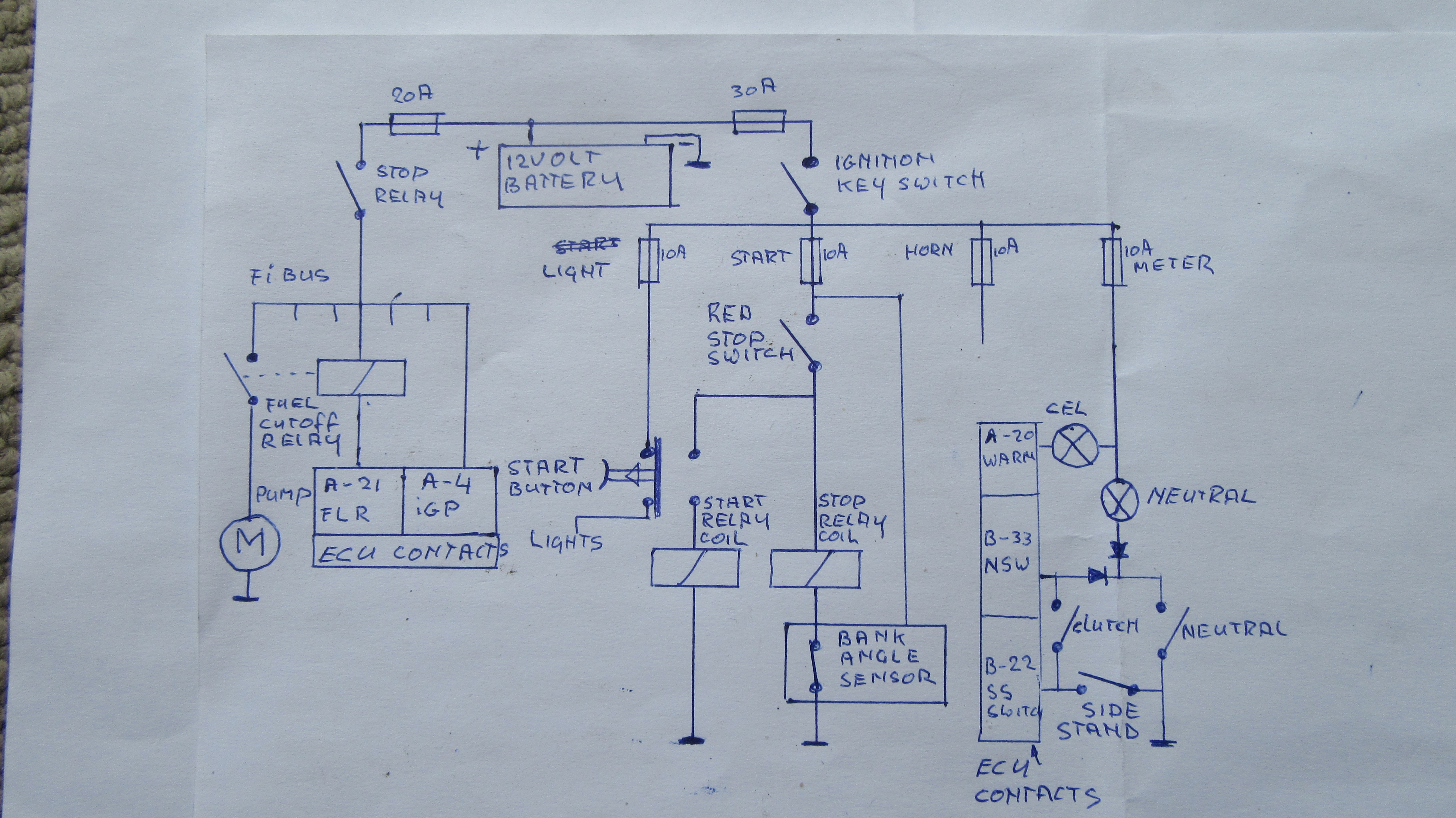

Zi, do the; cel, hiss and eot lights come on in the top left corner of the indicator panel for a second and then go off again? if they do the ecm is doing it's normal startup routine and the fuses etc are ok.
The coil, injectors and ecm all get their 12v supply from the "engine 12v buss", there are 10 black/white wires connected together and one of them is the supply coming from the engine stop relay, the buss is located under the fuel tank.
Here is a drawing that may help;

You would know that there are only two coils for 4 cylinders so only one sparkplug can be tested at one time whilst the other side is still connected to it's sparkplug, as you may know it takes the ecm two full rotations to "discover"which is the correct cylinder to fire up, it has no way of telling which cylinder the crank sensor wants to ignite and that takes a bit of "hit and miss" to work that out initially.
