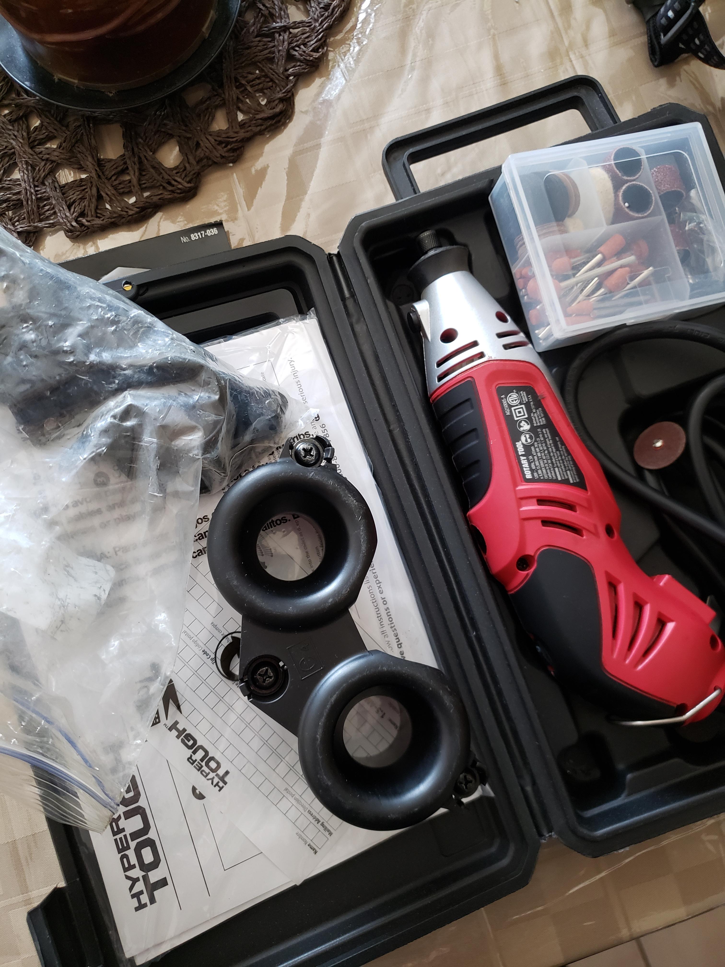

(03-03-2021, 01:33 PM)PowerDubs_imp Wrote: The TSR donut makes a tiny bit of power all the way up top. I took mine off though because I didn't like the sound it made.
My dyno numbers are with the stock intake boot, but 3 little filter vents on the left side of the airbox and the end of the air filter cut out.
Yea- the stock velocity stacks bring the diameter down to 26mm if I remember correctly instead of the 32mm the butterflies actually are.
After all this discussion I decided today is the day...
[Image: 0adae9b29d5b5d925d272a1e45f812c9.jpg]
03-04-2021, 01:25 AM

Nice cheap mod that makes power up top.
Good luck!
